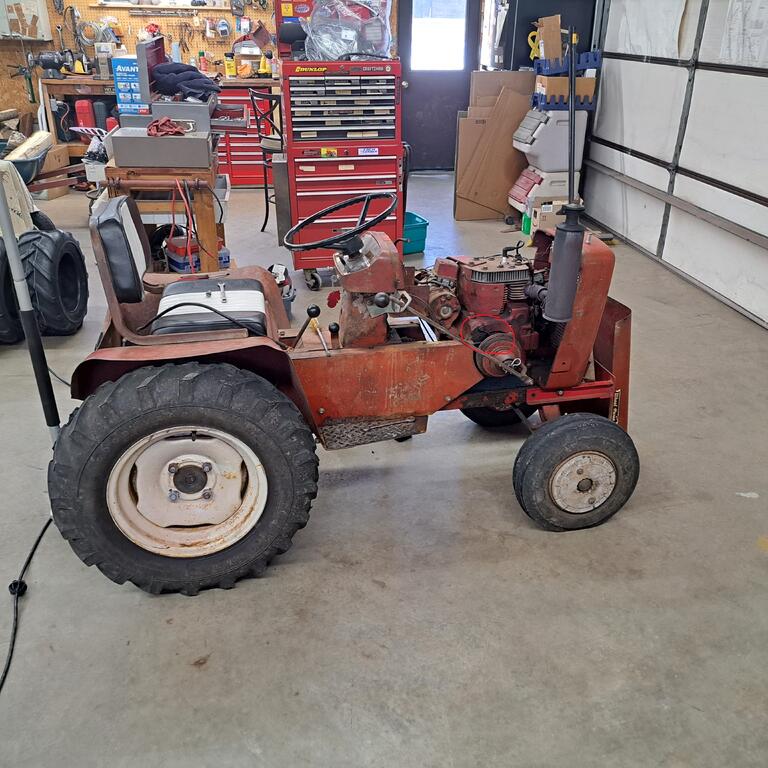

Tinman1962 15 #1 Posted February 18 I have a 1054 and it won't shift smoothly into any gear.What do I need to fix or adjust to solve this noisy problem? Thank you in advance 1 Share this post Link to post Share on other sites

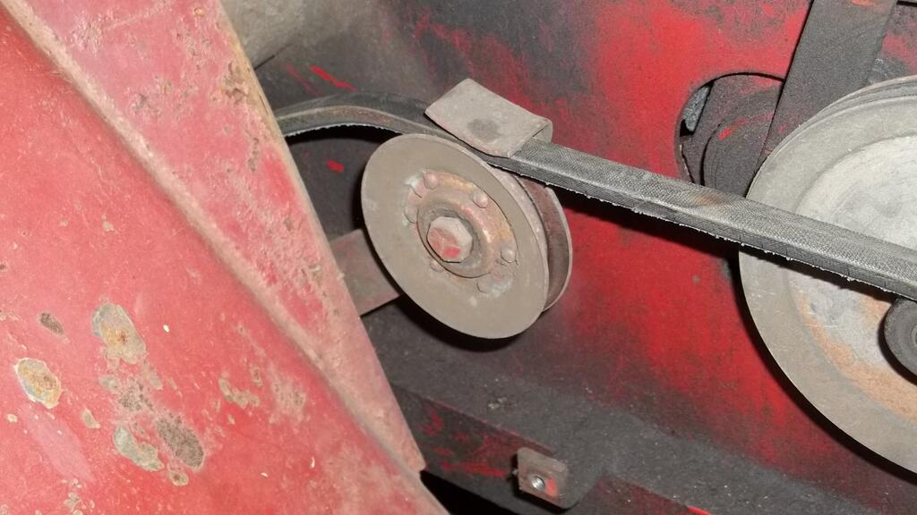

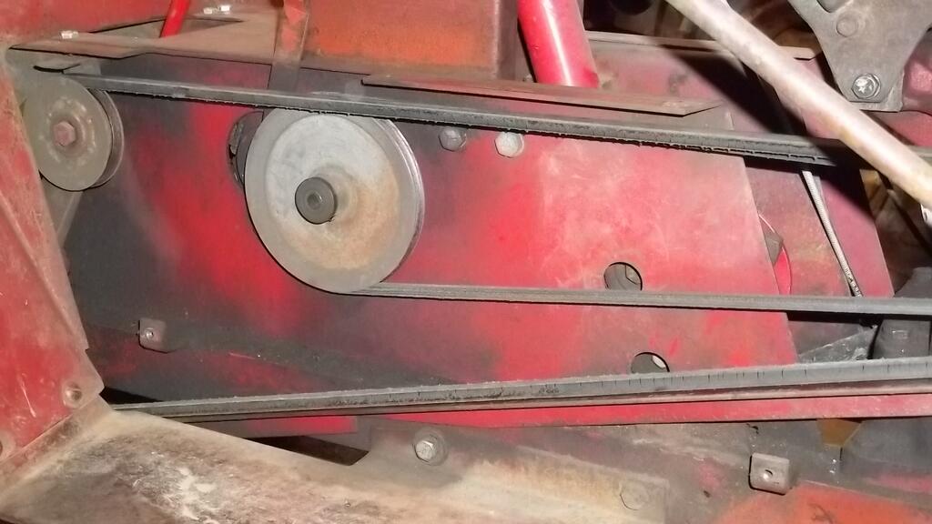

953 nut 70,588 #10 Posted February 23 Is your belt fully seated in the pully or riding high? Some of the belts found on the internet run a bit wider and if not properly seated they will be topo short. The pictures below show the clutch fully disengaged and engaged. Share this post Link to post Share on other sites
