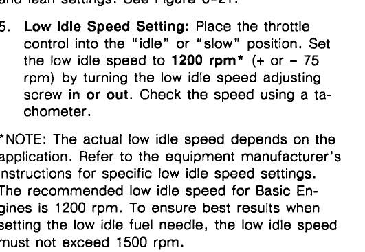

Retired Wrencher 6,989 #4 Posted February 17 1 hour ago, pfrederi said: Where did you find this info. I saw it once. I thought I saved it but guess not. Share this post Link to post Share on other sites
pfrederi 21,151 #5 Posted February 17 (edited) 10 minutes ago, Retired Wrencher said: Where did you find this info. I saw it once. I thought I saved it but guess not. Page 6.3 Kohler K series service manual. Edited February 17 by pfrederi Share this post Link to post Share on other sites
Retired Wrencher 6,989 #6 Posted February 17 1 minute ago, pfrederi said: Page 6.3 Kohler K series service manual. Thanks. I will save it this time. Share this post Link to post Share on other sites

pfrederi 21,151 #8 Posted February 17 Wonder why WH wanted such a high idle speed.1900-2100 Kohler says you can't adjust the idle mixture when it is running above 1500... Share this post Link to post Share on other sites
wallfish 20,618 #9 Posted February 17 14 minutes ago, pfrederi said: Wonder why WH wanted such a high idle speed.1900-2100 Kohler says you can't adjust the idle mixture when it is running above 1500... IDK but the mixture can be adjusted before cranking up the low idle stop screw. Maybe too many people were stalling them when trying to take off in 3rd gear high with the engine at idle speed. I've always set them at around 1200 idle and 3600 full throttle. 1 Share this post Link to post Share on other sites
