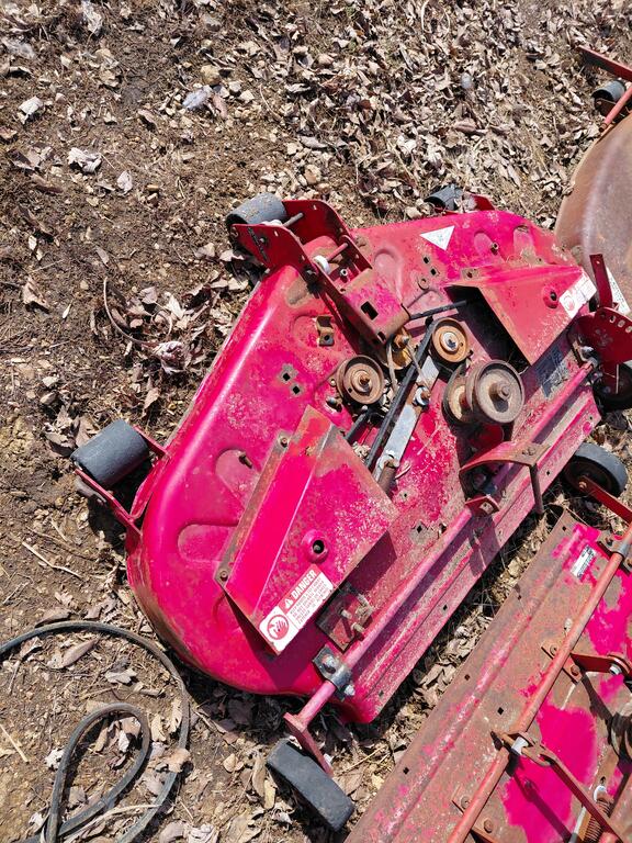

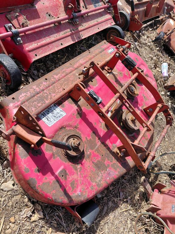

Easton Rich 1,268 #1 Posted February 16 Here I have 2 42" RD decks. I was sorting all my stuff today and noticed how different they were. One seems like it might be for a vertical shaft tractor? The other is in really good shape and I was gonna list it. Anyway could shed some light in this? 2 Share this post Link to post Share on other sites

Lee1977 7,803 #3 Posted February 21 The first one is for a vertical shaft lawn tractor, it's a later model deck. If you have the parts from a rusted out 42 garden tractor deck it can be changed over. The deck shell and out side spindles will work on either deck Share this post Link to post Share on other sites
Easton Rich 1,268 #4 Posted February 21 I would, but its pretty hacked up. The second one is in better shape. Share this post Link to post Share on other sites
