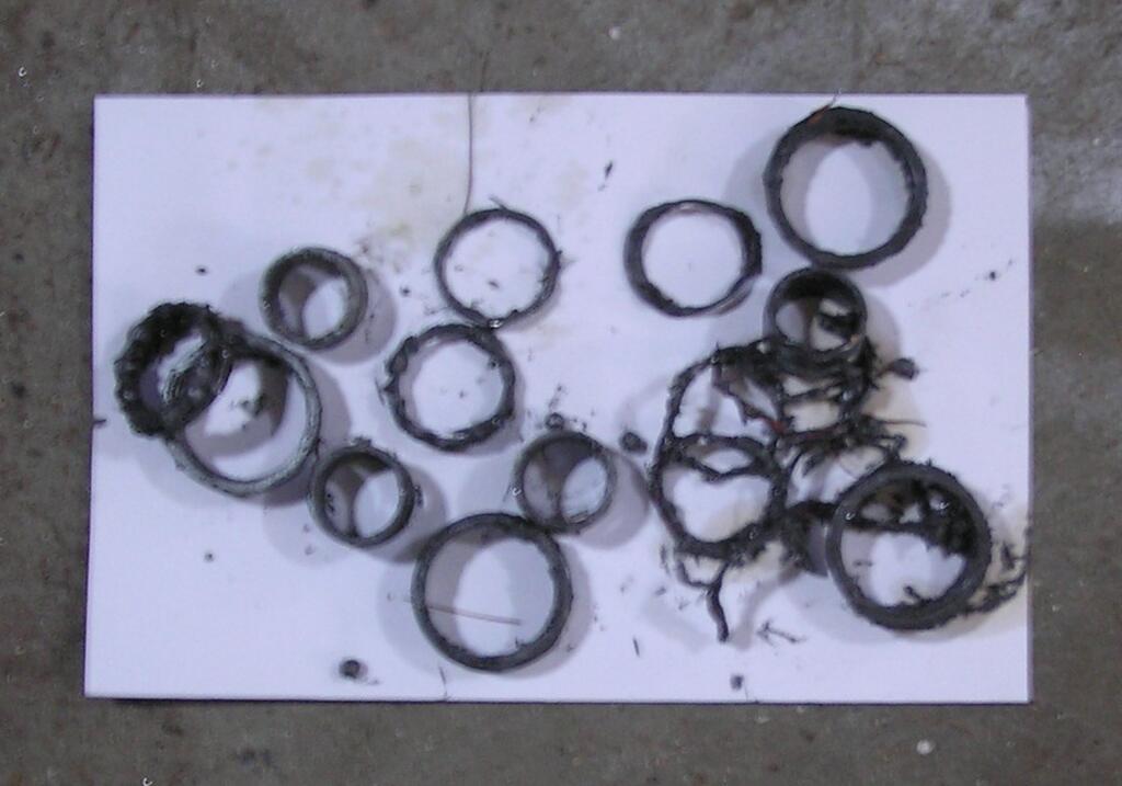

Wayne0 1,605 #1 Posted February 15 (edited) The Workhorse needed front wheel bearings so I found some on fleabay for cheap. I figured how bad could they be. Gave them the "Greasy Pete" treatment and installed them. Swapped them out 6 months later and this is all 4 of them! I have never seen such destruction. I think I found 5 balls left in the mess. Don't buy cheap bearings, people! Edited February 15 by Wayne0 5 1 3 Share this post Link to post Share on other sites
oldlineman 1,772 #3 Posted February 15 China strikes again! You get what you pay for. Bob 3 Share this post Link to post Share on other sites
CCW 1,516 #4 Posted February 15 It was always hard for me to buy tools because I would not buy cheap. 4 Share this post Link to post Share on other sites

Bill D 3,062 #6 Posted February 15 I try to buy USA bearings if possible. Japanese bearings are next followed by Taiwan. 2 Share this post Link to post Share on other sites

squonk 47,706 #9 Posted February 16 Center punch the wheel. Bearings stay put. 3 Share this post Link to post Share on other sites
