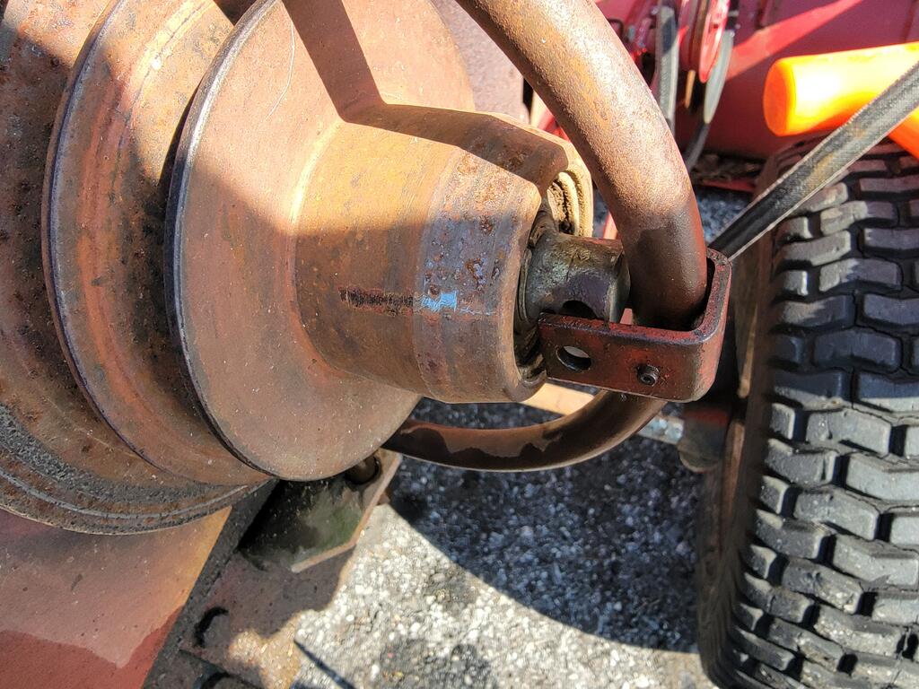

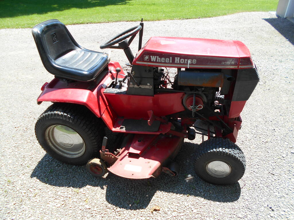

Joker72 96 #1 Posted February 14 Is this pin supposed to be near inpossible to get out? Share this post Link to post Share on other sites
ebinmaine 81,281 #2 Posted February 14 Nope. Slides right out. ..... unless it's rust welded in. 2 1 Share this post Link to post Share on other sites

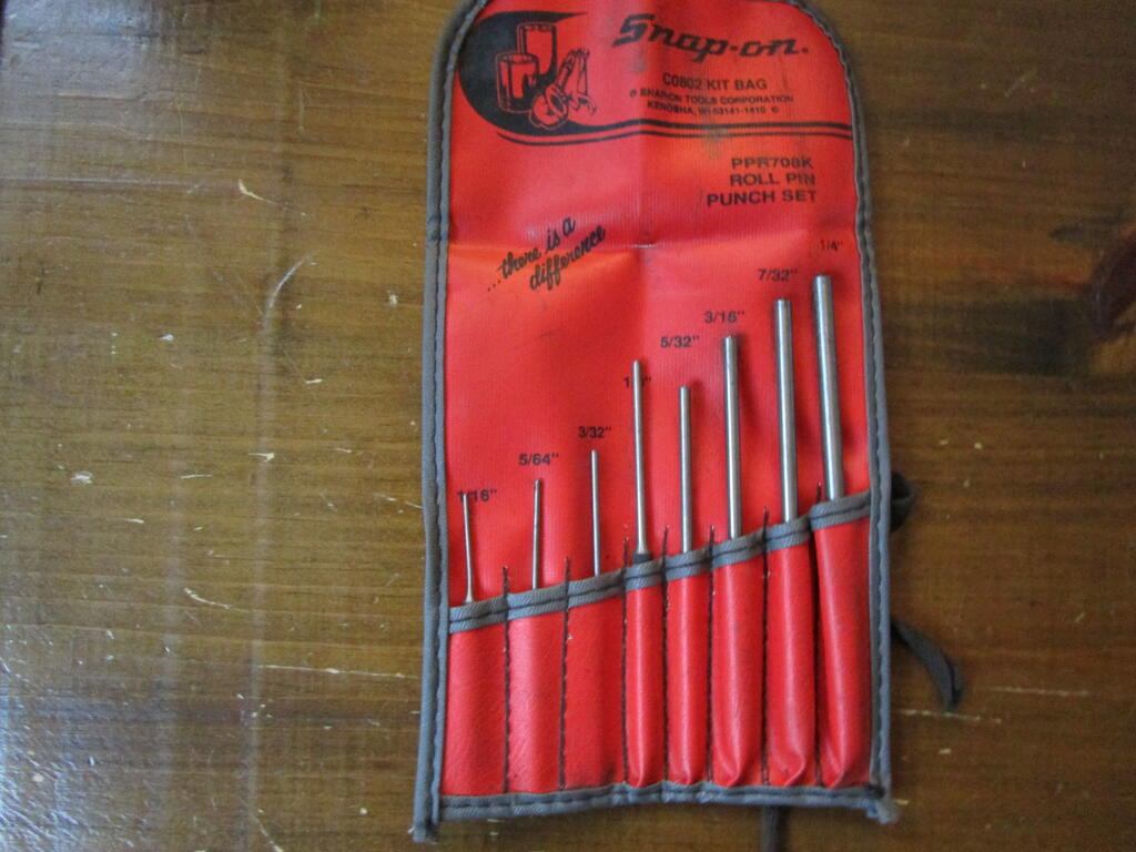

76c12091520h 4,299 #3 Posted February 14 If you are referring to the roll pin in the picture, yes , they can be difficult. Will need driven out using a special roll pin punch that won't mushroom the ends of it . Likely rusted fast after nearly 50 years 2 1 Share this post Link to post Share on other sites
ebinmaine 81,281 #4 Posted February 14 4 minutes ago, 76c12091520h said: roll pin in the picture Oooooooo. Good point. I was thinking about the other pin. 1 Share this post Link to post Share on other sites
gwest_ca-(File Mod) 12,557 #5 Posted February 14 Take the hoop off the tractor so you can lay it on it's side where one good slam from a hammer should start it moving. Got to ask - why do you want the pin out? 2 1 Share this post Link to post Share on other sites
Joker72 96 #6 Posted February 14 (edited) Im trying to put a snow blower belt around the pto. Taking it off may be necessary to get the quick feature back. Edited February 14 by Joker72 Share this post Link to post Share on other sites
Handy Don 17,735 #7 Posted February 14 Check out the manual for your tractor and/or snowblower. You’ll discover that the way to change the PTO belt is to remove pins holding the PTO bail at its upper and/or lower pivot and then slide the bail up or down to get clearance between the clevis and the stub in the PTO shell. 5 2 1 Share this post Link to post Share on other sites
JCM 11,470 #8 Posted February 14 55 minutes ago, Joker72 said: Im trying to put a snow blower belt around the pto. Taking it off may be necessary to get the quick feature back. Soaking with Kroil for a while and as @76c12091520h says roll pin punch with patience should do it. 2 1 Share this post Link to post Share on other sites
Ed Kennell 47,942 #9 Posted February 14 20 minutes ago, Handy Don said: Check out the manual for your tractor and/or snowblower. You’ll discover that the way to change the PTO belt is to remove pins holding the PTO bail at its upper and/or lower pivot and then slide the bail up or down to get clearance between the clevis and the stub in the PTO shell. Just pull the two hairpin clips and the hoop will drop down. Then swing the hoop to the rear , Install the belt and reinstall the hoop . 10 1 1 Share this post Link to post Share on other sites
c-series don 12,752 #10 Posted February 14 Yes, as the guys said you don’t need to remove the roll pin to change the belt. 1 Share this post Link to post Share on other sites
gwest_ca-(File Mod) 12,557 #11 Posted February 14 This operator manual will explain the steps to install. Year may be different but the attachment changed very little. If you have a flat file run it around the sides of the outer pto pulley groove to smooth out the rust or use a coarse sandpaper. Makes for less belt wear. 1 Share this post Link to post Share on other sites
squonk 48,427 #12 Posted February 14 With bigger pin out just rotate the arm to the rear. No need to unhook anything else. 1 1 Share this post Link to post Share on other sites
Ed Kennell 47,942 #13 Posted February 14 Just now, squonk said: With bigger pin out just rotate the arm to the rear. No need to unhook anything else. Mike, you do need to lower the hoop so the U bracket clears the stub shaft. 1 1 Share this post Link to post Share on other sites

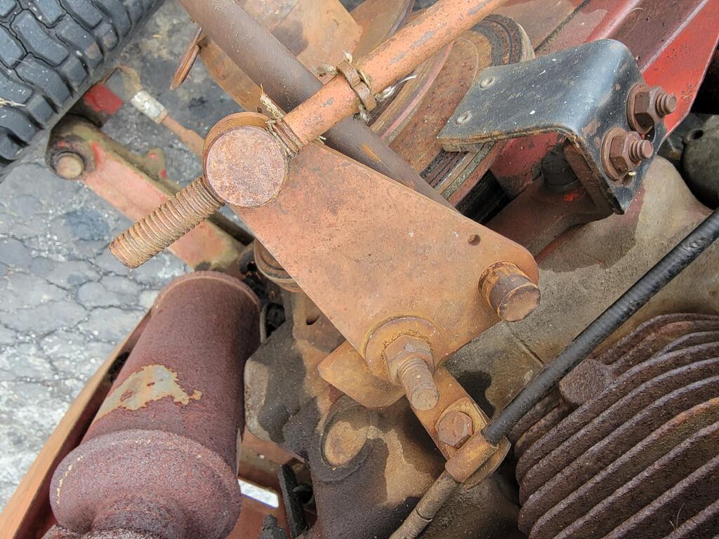

cleat 9,448 #14 Posted February 14 No. Just disconnect the pto trunnion the the pto plate will rotate enough to disengage the hoop from. The pto bell thrust bearing. 2 2 1 Share this post Link to post Share on other sites

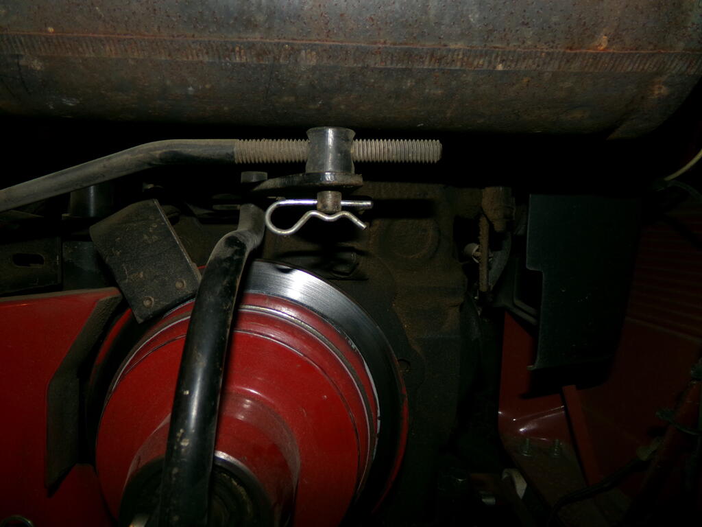

Ed Kennell 47,942 #15 Posted February 14 I'm not sure if my 312H is stock or if the trunnion was put on top to get better rod alignment, but the muffler prevents the disconnection on mine. Requiring me to pull the lower pin in the PTO hoop to let it lower enough to allow the U bracket to clear the stub shaft. 1 1 Share this post Link to post Share on other sites
lynnmor 9,081 #16 Posted February 14 33 minutes ago, Ed Kennell said: I'm not sure if my 312H is stock or if the trunnion was put on top to get better rod alignment, but the muffler prevents the disconnection on mine. Requiring me to pull the lower pin in the PTO hoop to let it lower enough to allow the U bracket to clear the stub shaft. That would be upside down for a 520H, I don't know why the 312H was made that way. It appears that the rod would be at too much of an angle if you reversed it. 1 Share this post Link to post Share on other sites
squonk 48,427 #17 Posted February 14 2 hours ago, Ed Kennell said: Mike, you do need to lower the hoop so the U bracket clears the stub shaft. Unhook the pto control shaft from the triangle plate and it will pivot out away from the stub shaft. ( I forgot that part) Hoop stays attached. Done it a zillion times. 1 Share this post Link to post Share on other sites

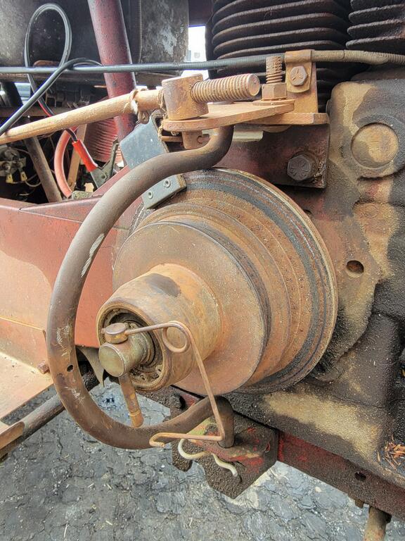

Joker72 96 #18 Posted February 15 (edited) I couldn't get the arm to slide up or down far enough for the mechanism to clear the PTO shaft. Grinder fixed it. I didn't like that feature. Edited February 15 by Joker72 Share this post Link to post Share on other sites
Joker72 96 #19 Posted February 15 (edited) Will put a cotter pin through it. Edited February 15 by Joker72 Share this post Link to post Share on other sites
Ed Kennell 47,942 #20 Posted February 15 2 minutes ago, Joker72 said: Not sure it's necessary for function. It's there to pull the PTO bell out against the brake to help stop implements when the PTO is disengaged. 1 Share this post Link to post Share on other sites
cleat 9,448 #21 Posted February 15 (edited) 14 hours ago, Ed Kennell said: I'm not sure if my 312H is stock or if the trunnion was put on top to get better rod alignment, but the muffler prevents the disconnection on mine. Requiring me to pull the lower pin in the PTO hoop to let it lower enough to allow the U bracket to clear the stub shaft. My 312H 312-8 and 314 are all underneath the same as my 520's If you flip yours over it will be easy to disconnect for belt removal. Edited February 15 by cleat 1 Share this post Link to post Share on other sites
Joker72 96 #22 Posted February 15 (edited) I think we can get it back to original but It doesn't fix the issue that I can't get clearance to swing the arm back. More to come. Thanks to everyone for all the great input. A cotter pin may end up being my best option if I can't get clearance. Edited February 15 by Joker72 Share this post Link to post Share on other sites
lynnmor 9,081 #23 Posted February 15 27 minutes ago, Joker72 said: I think we can get it back to original but It doesn't fix the issue that I can't get clearance to swing the arm back. More to come. Thanks to everyone for all the great input. If you removed the trunnion shown in four photos above, it doesn't make sense that you can't swing the hoop back. Share this post Link to post Share on other sites
Joker72 96 #24 Posted February 15 (edited) Im probably missing something but this is with the arm as far.down as it it will go. The bracket doesn't clear the shaft enough to swing. The top of the PTO is blocking the arm from dropping enough. I tried the arm up as well without the bottom cotter pin in. Edited February 15 by Joker72 Share this post Link to post Share on other sites
Joker72 96 #25 Posted February 15 I see. For some reason I just wasn't getting it. It's dislexia or something, Jeez. Thanks Guys. Share this post Link to post Share on other sites
