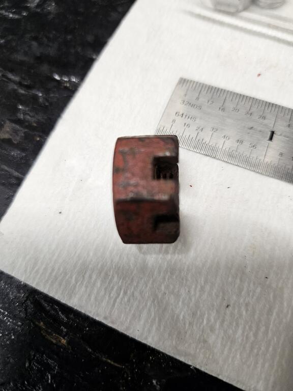

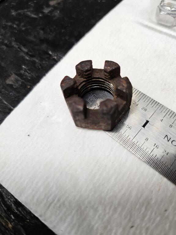

ML3 2,571 #1 Posted February 13 (edited) Found this in driveway yesterday now that snow is starting to melt. Its definitely Wheel Horse red just not sure if its off the 654 or 702? Leaning towards 702 cause the 654 has incorrect color respray. Guess this weekend I'll be looking over both tractors however nothing appears to be loose, falling off, or not functioning on either tractor...... Any guesses??? Edited February 14 by ML3 Share this post Link to post Share on other sites
1968Commando 189 #2 Posted February 14 Looks like a flywheel bolt Share this post Link to post Share on other sites
Easton Rich 1,292 #3 Posted February 14 Looks too small Share this post Link to post Share on other sites
JCM 11,470 #4 Posted February 14 It's actually a Castle Nut used with a cotter pin to secure. What , that is the question. 1 1 Share this post Link to post Share on other sites
gwest_ca-(File Mod) 12,557 #5 Posted February 14 Looks like 1/2" Share this post Link to post Share on other sites

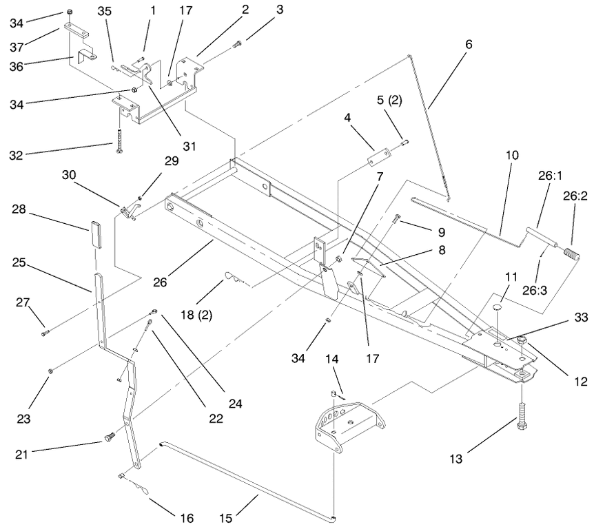

Lagersolut 808 #6 Posted February 14 I'm gonna take a guess - did some of the older blades use a castle nut for number 12 Share this post Link to post Share on other sites
702854boy 1,245 #7 Posted February 14 18 minutes ago, Lagersolut said: I'm gonna take a guess - did some of the older blades use a castle nut for number 12 Yes, our plow from '62 has a bolt that goes through with a castle nut originally, I swapped it our with a pin of the same size so blade could be removed easier. 2 Share this post Link to post Share on other sites
kpinnc 19,107 #8 Posted February 14 Do you have a 520? Looks like the castle nuts on the steering tie rods. 1 Share this post Link to post Share on other sites

ML3 2,571 #10 Posted February 14 (edited) 9 hours ago, JCM said: It's actually a Castle Nut used with a cotter pin to secure. What , that is the question. I know its a castle nut. Gotta figure out where it came from. Gonna look over both my snow removal tractors later today Edited February 14 by ML3 Share this post Link to post Share on other sites

ML3 2,571 #12 Posted February 14 7 hours ago, kpinnc said: Do you have a 520? Looks like the castle nuts on the steering tie rods. Wish I had a 520 but I dont. Just do snow removal w/654 plow & 702 snowblower. All the other tractors are in back storage building for winter Share this post Link to post Share on other sites

JCM 11,470 #15 Posted February 14 I just went out to the shop and on my 48'' dozer blade # 0648BC03 it has a 3/4 -16 X 3 3/4 Hex bolt with a 3/4-16 Hex nut. This a later model blade set up. Directions say to leave the bolt loose enough to allow the sector and channel to operate freely. No Castle nut and cotter. @ML3 Share this post Link to post Share on other sites
Handy Don 17,735 #16 Posted February 14 As noted above, the ’61-’63 blades used a castle nut on the pivot bolt--on mine it was on the bottom but I’ve since swapped it to the top so I can see it! Betting the cotter rusted away and the bolt came off your blade. Share this post Link to post Share on other sites
