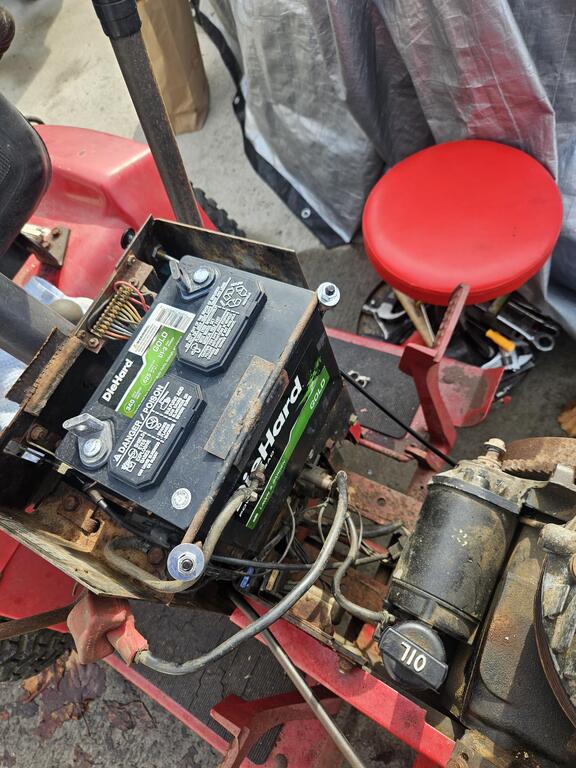

CD Long Jr 203 #26 Posted February 26 (edited) Today was 312-8 day. New gas gauge, fuel filter. Ordered new clear fuel line & shut off valve on the bottom of the tank. Gas tank was clean. Remounted the seat switch & installed the seat strut. New battery & hold down rods. New choke cable & installed the ignition module. Found a broken bolt in the end of the side cover plate closest to the dash that the blower housing bolts to. Gonna be fun gettin' it out. All bolts installed got a light coat of oil. I do pay attention to what ya'll tell me. Ordered the voltage regulator and a carb bowl gasket. Lookin' forward to gettin' her runnin". Not ready to tear into the 416H to replace the ignition module just yet. Edited February 26 by CD Long Jr 1 Share this post Link to post Share on other sites

Sparky-(Admin) 26,898 #28 Posted March 1 On 2/26/2026 at 1:22 PM, CD Long Jr said: A flywheel with no fins for cooling? Share this post Link to post Share on other sites
pfrederi 21,342 #29 Posted March 1 9 minutes ago, Sparky said: A flywheel with no fins for cooling? Magnums had a bolt on plastic set of fins 1 1 1 Share this post Link to post Share on other sites
