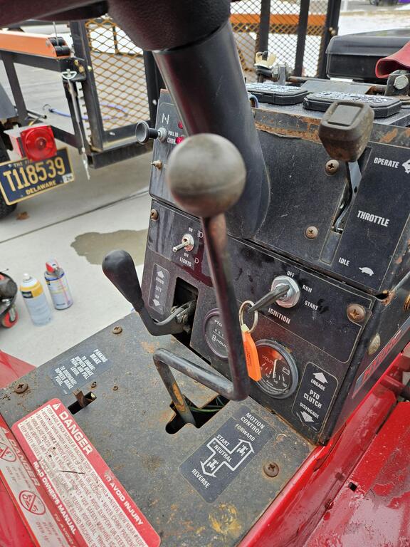

CD Long Jr 203 #1 Posted February 13 (edited) 416H had no lights. Fuse block was full of grass. Cleaned it with air, looked at fuses, they looked ok. put some WD-40 on em and installed em. No lights. Got my handy, dandy colored wiring diagram, (thanks for the heads up about it). Tested fuses with 12V test light. The headlight fuse was bad. Replaced it, no lights. Looked over the wiring, no issues. Started tracing the wires, on/ off switch is bad. Ordered a new one. Went to change out the front tires on the 312-8. Got a small tire changer from Harbor Freight. Broke the tire loose but wouldn't spin it of the wheel. After 45 minutes of fighting with 3 screwdrivers & very little progress, it was time for the grinder w/ cut off wheel. It came off then. Wheels are rusted pretty bad. Gonna try to wire brush & repaint them, (maybe spray with flex seal?), but also looking for new wheels. Back in the day, you could buy rubber flaps that installed on the wheel to protect the tubes. Haven't found anything like that but still looking. Did I mention new wheels are $200 & up. OUCH! Edited February 13 by CD Long Jr 3 Share this post Link to post Share on other sites

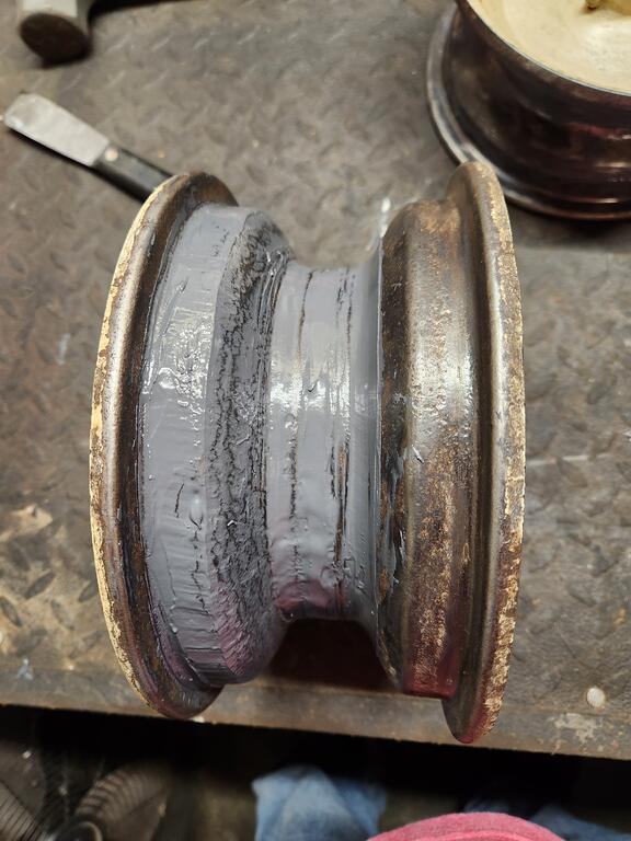

Goldnboy 1,126 #2 Posted February 13 I had rust holes on the inside of my front rims when I removed the tubes/tires when changing to V61's.. JB weld did a great job filling the holes and I spread to other areas that looked suspicious from putting rust. Make sure you clean all the rust and let JB weld fully cure before remounting tires..might be good to paint it too if you have time. 4 1 Share this post Link to post Share on other sites

CD Long Jr 203 #10 Posted February 14 So today, I got out my homemade vise and wire brushed the wheels, wiped em down with mineral spirits, let em dry and applied 4 coats of filling gray primer. " on scamazon you can get 2 brand new 16x6.50x8 tires. 2 new 8 inch rims. and here is the best part. the tires are already mounted on the rims. under $100 for everything". Money is at a premium now & I like DYI. Next, I installed the head. Never-seize was applied to the head bolts. Torqued 10 ft lbs, then 20 ft lbs then 30 ft lbs and finally 40 ft lbs. I have rechecked the torque 3 times as suggested. No change. Now I'm gettin' quality time (?) on the keyboard searchin' for the sizes of hardware I need. Got a great hardware store nearby. If they don't have it, you don't need it. 4 Share this post Link to post Share on other sites

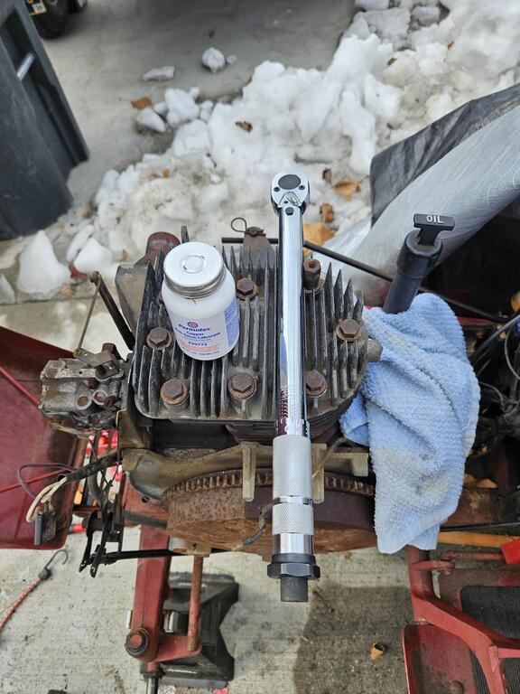

CD Long Jr 203 #12 Posted February 15 (edited) You guys were right! The 312-8 sat in 55-degree weather with the sun on the engine all afternoon after I installed the head. At 5PM, I was cleaning up, putting tools away and decided for S&Gs, I'd check the head bolt torque one more time. The bolts were loose. Only by a couple foot pounds, but loose. Think I'm getting my neighbor hooked. Purchased a hitch extender to weld the mini tire changer on so I can mount it in the truck hitch for more leverage. Steve does my welding. He was asking all sorts of questions about both tractors. He's gettin' the fever. Sent me a text last night about a Bolen's with deck, dozer blade & snow blower. I gave him the number for the guy I got the 416H from. He has some more Wheel Horses. Edited February 15 by CD Long Jr 4 Share this post Link to post Share on other sites
lynnmor 8,875 #13 Posted February 15 7 hours ago, CD Long Jr said: You guys were right! The 312-8 sat in 55-degree weather with the sun on the engine all afternoon after I installed the head. At 5PM, I was cleaning up, putting tools away and decided for S&Gs, I'd check the head bolt torque one more time. The bolts were loose. Only by a couple foot pounds, but loose. You are to use a bit of light oil on the head bolts, that is not the place for Never-Seez. 4 Share this post Link to post Share on other sites

CD Long Jr 203 #15 Posted February 17 On 2/15/2026 at 11:24 AM, lynnmor said: You are to use a bit of light oil on the head bolts, that is not the place for Never-Seez. Live and learn I quess. I worked the oil patch and industrial services all my life. Never bolted anything together without never-seize. Share this post Link to post Share on other sites

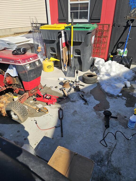

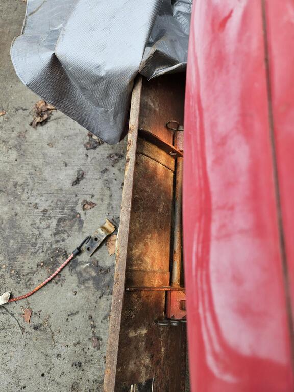

CD Long Jr 203 #18 Posted February 18 (edited) Not a good day. Needed room in the shed, (there's a Harley trike in the future), so I moved the Cub Cadet XT1 & Toro Power Max 824 OE snowblower out & put them alongside the 312-8 & put their covers on. Went to start the 416H, no workie. No spark? I placed the dozer blade on a wheeled 2-ton jack, used a 5-ton jack to lift the rear and shoved her where I wanted her, across the front of the others. I have ordered a new ignition switch. Will it never end? On a good note, I have ordered all the parts I feel I need for the 416H & to get the 312-8 operational. Edited February 18 by CD Long Jr 2 Share this post Link to post Share on other sites

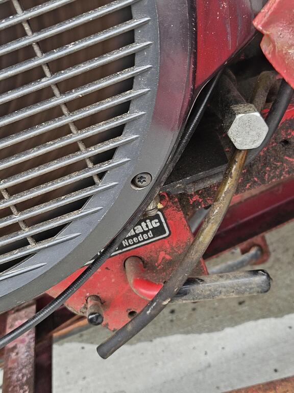

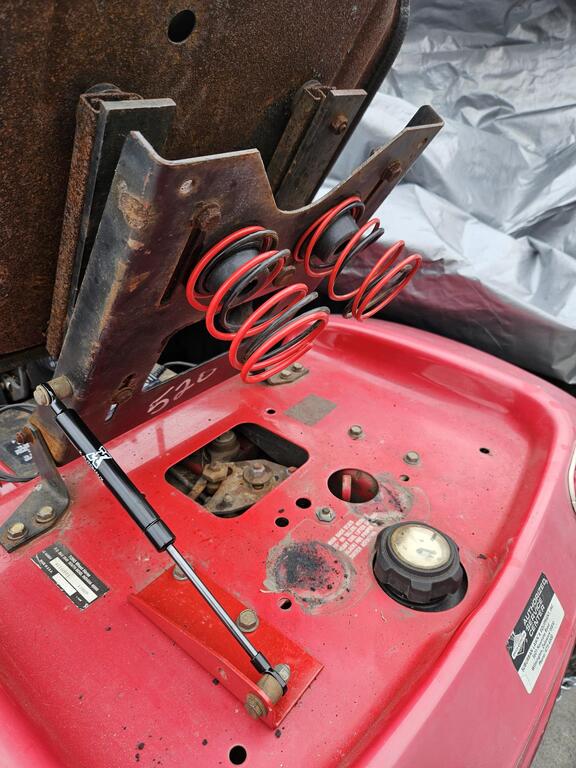

CD Long Jr 203 #20 Posted February 25 Finally warmed up some. This morning, the 416H got new seat springs & bushings, (I doubled the springs), shock to hold the seat up, ignition & headlight switches. The headlights work & she started but only ran 20 minutes & died. No restart. I have a cheat sheet from many posts on this forum & I'll start giving her the once over after I get the Grandkids from school. What is the black mystery hose? A vent for the hydro? It comes out the top of the frame behind the engine and just hangs there. Share this post Link to post Share on other sites
Handy Don 16,908 #21 Posted February 25 (edited) Not positive, but could it be the drain hose that normally attaches to the bottom of the plastic battery tray? The Eaton 1100 vents via the dipstick (the 700 vents via an oil reservoir atop the hydro). The “crook” end is hollow which I periodically ream out with a pipe cleaner, though I’ve never seen it clogged. Edited February 25 by Handy Don 1 Share this post Link to post Share on other sites
pfrederi 20,820 #22 Posted February 25 Follow the hose probably battery tray 1 Share this post Link to post Share on other sites
CD Long Jr 203 #23 Posted February 25 2 hours ago, Handy Don said: Not positive, but could it be the drain hose that normally attaches to the bottom of the plastic battery tray? The Eaton 1100 vents via the dipstick (the 700 vents via an oil reservoir atop the hydro). The “crook” end is hollow which I periodically ream out with a pipe cleaner, though I’ve never seen it clogged. Too much gunk under her to follow the hose. Hose goes into the top of the frame. Share this post Link to post Share on other sites

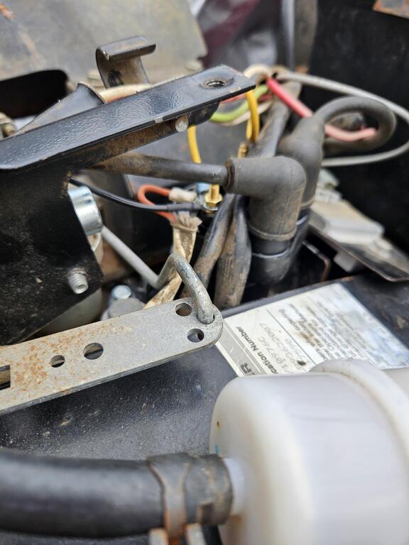

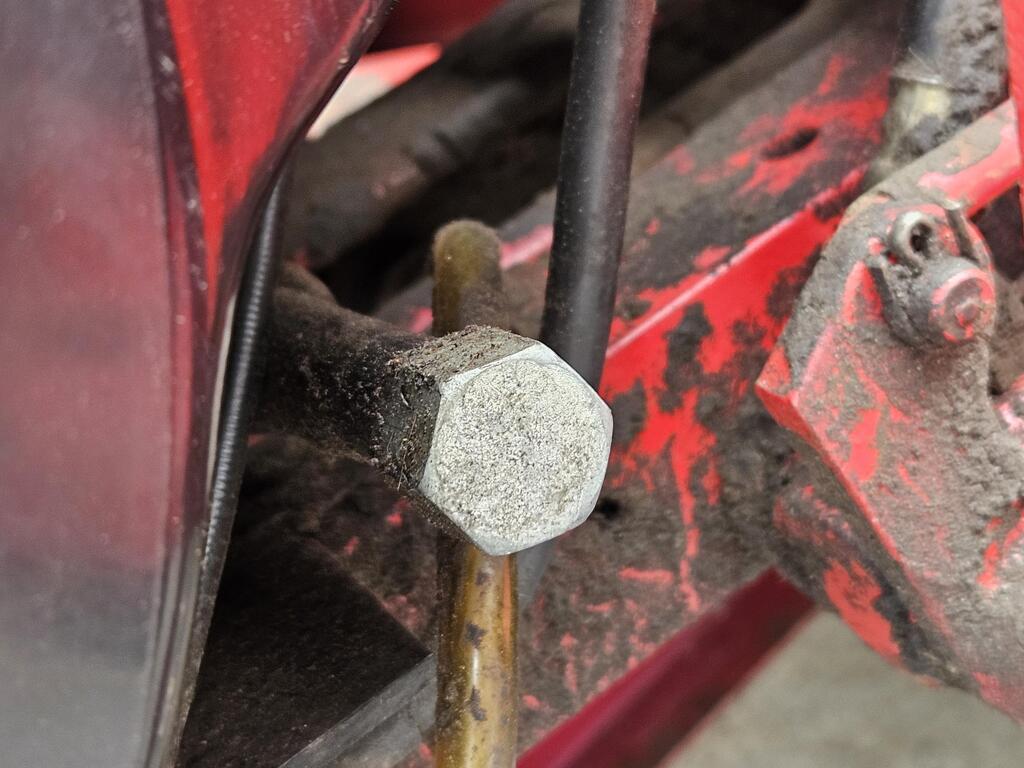

CD Long Jr 203 #24 Posted February 25 Tracing some wiring & found the coil was loose in the bracket, tightened it. Found another Oh crapper. What's the proper name of the piece that holds the linkage on the bracket? I guessed at the hole it was supposed to go in, but it must be right. She wouldn't idle before, now she will. 2 Share this post Link to post Share on other sites
lynnmor 8,875 #25 Posted February 26 2 hours ago, CD Long Jr said: Tracing some wiring & found the coil was loose in the bracket, tightened it. Found another Oh crapper. What's the proper name of the piece that holds the linkage on the bracket? I guessed at the hole it was supposed to go in, but it must be right. She wouldn't idle before, now she will. Page 24 in the parts list. That governor rod should not touch anything, it appears that it is rubbing wires and other things. 1 1 Share this post Link to post Share on other sites
