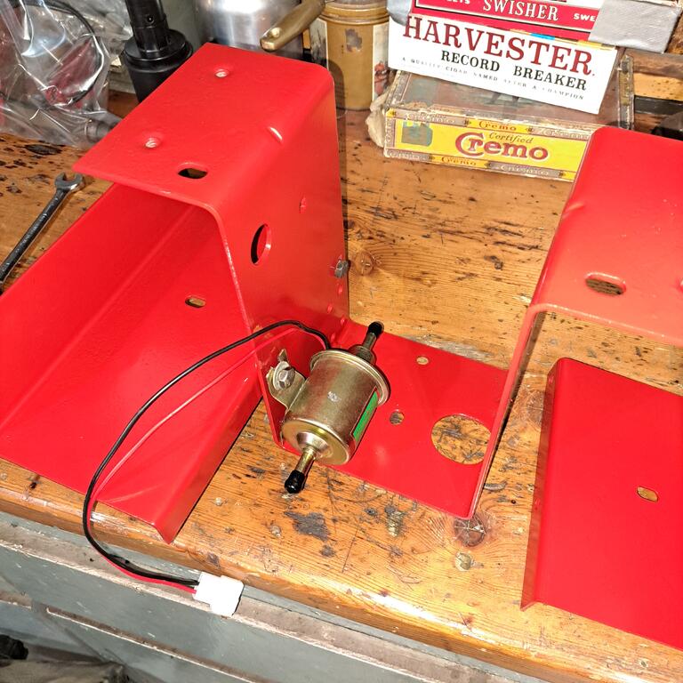

WHX?? 58,125 #2 Posted February 12 (edited) Yep left side is impossible without removing the oil filter. Can get at better it if you remove the filter mounts down inside the pan stand. They are brass thread serts, I wanna call them, molded into the tank bottom. 5/16 Bolts are fairly short. If you twist it out the tank may leak. Guessing the inserts are knurled to help hold them in. Keep dousing with your favorite juice it and work back and forth may get lucky is all I can suggest. Might help to get at it if you disassemble the wings the tank sets on and remove the fender pan stand. Last one I wrenched on PO never even put them in. I got replacement tanks too Plunge. Edited February 12 by WHX?? 4 Share this post Link to post Share on other sites
WHX?? 58,125 #3 Posted February 12 (edited) Might add you should be able to disassemble everything to get the tank out and on the bench. Edited February 12 by WHX?? 3 Share this post Link to post Share on other sites
