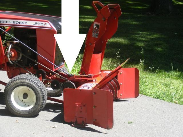

wallfish 20,744 #26 Posted February 14 4 hours ago, squonk said: it was still flexible enough The chute handle on a tall chute is completely different and has a universal joint integrated as part of it and not a completely rigid handle that's supported farther away like a SS is. The tall chute handle is also supported by separate a bracket closer to the operator so along with the u joint it will allow the handle to be "flexible" and move differently. 1 Share this post Link to post Share on other sites
