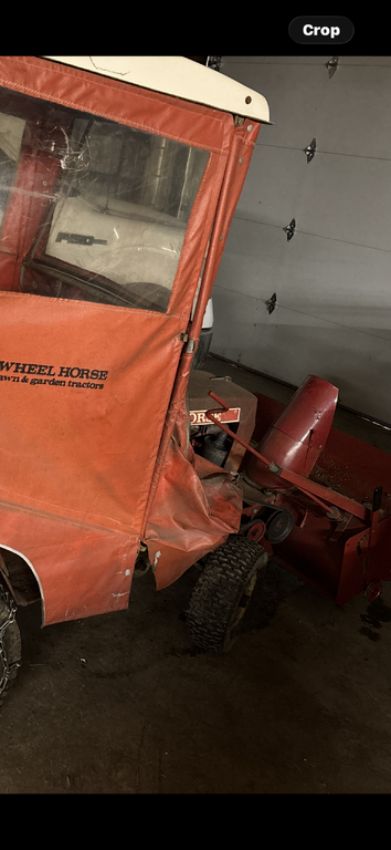

fourwheelhorseman 362 #1 Posted February 10 (edited) So I got a deal on snowblower a while back, along with a snowcab. I installed both and noticed that when I’m using that setup that to turn the auger I have to reach through the hole in my cab to acsess the handle. I’m wondering if it’s the correct snowblower for my C-160. Shouldn’t that hand stick through the cab for easier use? Edited February 10 by fourwheelhorseman Share this post Link to post Share on other sites

fourwheelhorseman 362 #6 Posted February 10 (edited) I’ll try and take better pictures this evening. The handle is actually at a weird angle as well. And I have to slide up to the edge of the seat to reach it when it’s cranked to the right or to the left.. it’s awkward to say the least and I’m sure it has somthing to do with the blower model. However it’s a great blower with very little use.. so I might just live with it.. or try and modify it. Edited February 10 by fourwheelhorseman Share this post Link to post Share on other sites

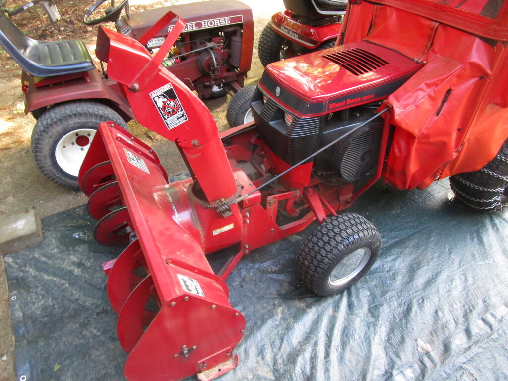

JCM 11,341 #15 Posted February 11 I know this is a 2 stage on a 520 - H but shows bracket for rod and entry on left side attached to Cab upright. Hope this clarifies a little for you. Share this post Link to post Share on other sites

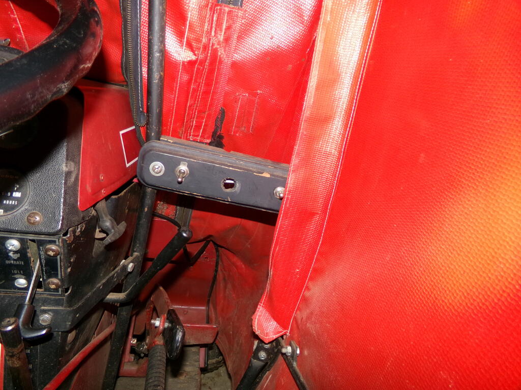

Ed Kennell 46,792 #18 Posted February 11 Here is a picture of the chute crank support panel I made when I had the short chute blower on the 520. The crank was inserted thru the hole and the slit in the canvas and connected to the extension sleeve. The panel also served to mount the switches for the cab lights which I still use. 1 Share this post Link to post Share on other sites
