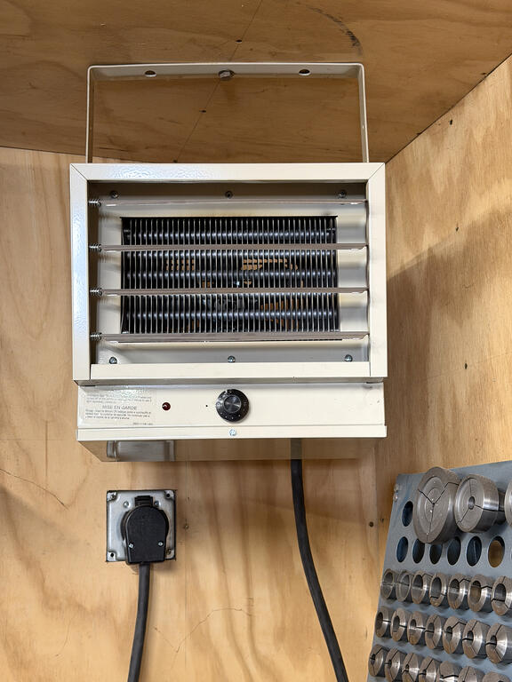

Bill D 3,156 #56 Posted February 9 4 hours ago, Blue Chips said: I'm looking at getting something similar in the way of a ceiling-mount, direct-vent, sealed-combustion unit to replace the existing electric heater, which puts a big dent in my wallet. I was considering something like that, but I think I'm going to go with a ceiling-mount unit, as I really don't have the available wall space for a wall-mount heater. I keep my workshop (former 2-car garage) at least 50 degrees all the time and warm it up a little when I'm working in it. I've found that if I let it get too cold and then warm it up, it can create condensation on my equipment, primarily during the cooler parts of the spring and autumn when the interior air is more humid. It's not so much a problem in the winter, as the winter air in the shop tends to be very low relative humidity. I have a dehumidifier in the shop, but it virtually never comes on in the winter. The current electric heater in my shop is a 5,000 watt unit (a little over 17K BTU), and it can keep the shop (about 575 square feet) warm when the temps drop below zero, but the power bill ! We're on CMP as well, and I'd probably use an unprintable expletive to describe the power bill, a good portion of which is attributable to my electric workshop heater. My workshop is in our old two-car garage, which is pretty well insulated...walls, ceiling, and garage doors...and the current 5,000-watt heater keeps it nice and cozy, but it doesn't feel quite as comfortable when I remind myself that my power bill is helping to subsidize Spain's economy...not that I have anything against Spain, but gee whiz. My Dad has that heater in the 7,500 watt model in his 2.5 car garage. Works great 2 Share this post Link to post Share on other sites

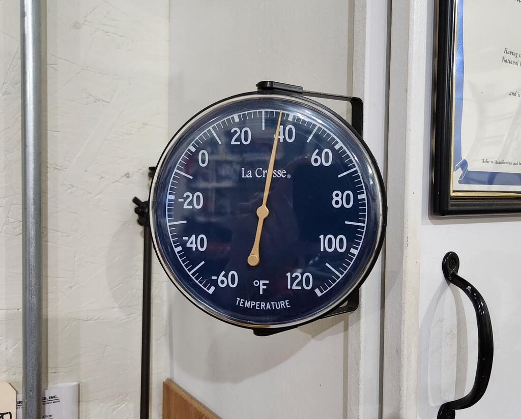

Racinbob 13,193 #58 Posted February 9 It was 16° this morning. My garage is pretty well insulated and is just under 1000 sq ft with some extra volume with 10' ceilings. 30k BTU would be considered minimum to heat it up. With us parking the warm vehicles in there is rarely gets down to the freezing mark. At 6:30 this morning it was: Some time ago I decided to go the cheap and lazy way and to use a couple of 1500w milkhouse heaters. A little later I added a third. In an hour it was this: That's a little over 15k BTU running. That works for me but I will likely still hang a 7.5 or 10KW unit. Share this post Link to post Share on other sites
