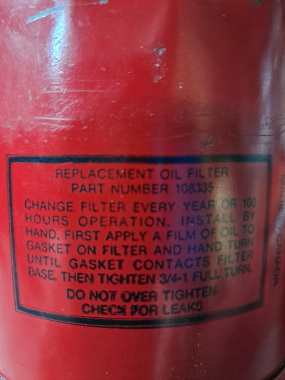

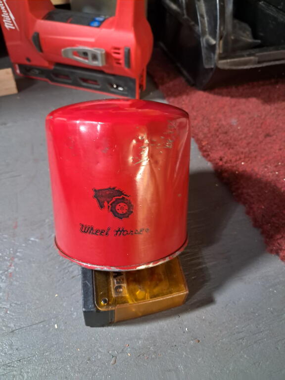

JCM 11,415 #26 Posted February 9 Found an original WH used Red oil filter from the Eaton 1100 when cleaning and organizing the shop. Will have to save that up on a shelf . Early 90's vintage from the 520-H. 2 1 Share this post Link to post Share on other sites

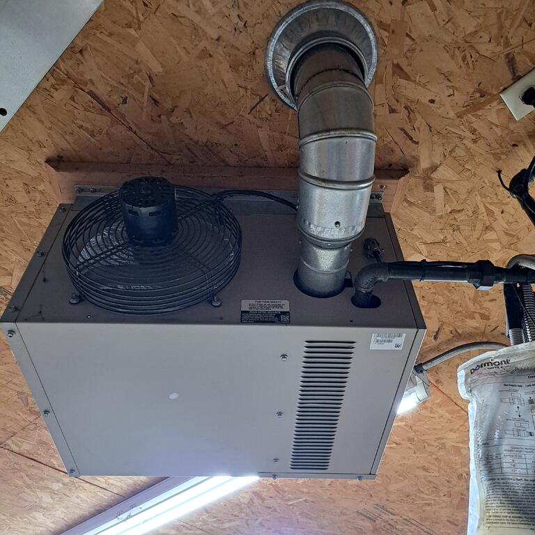

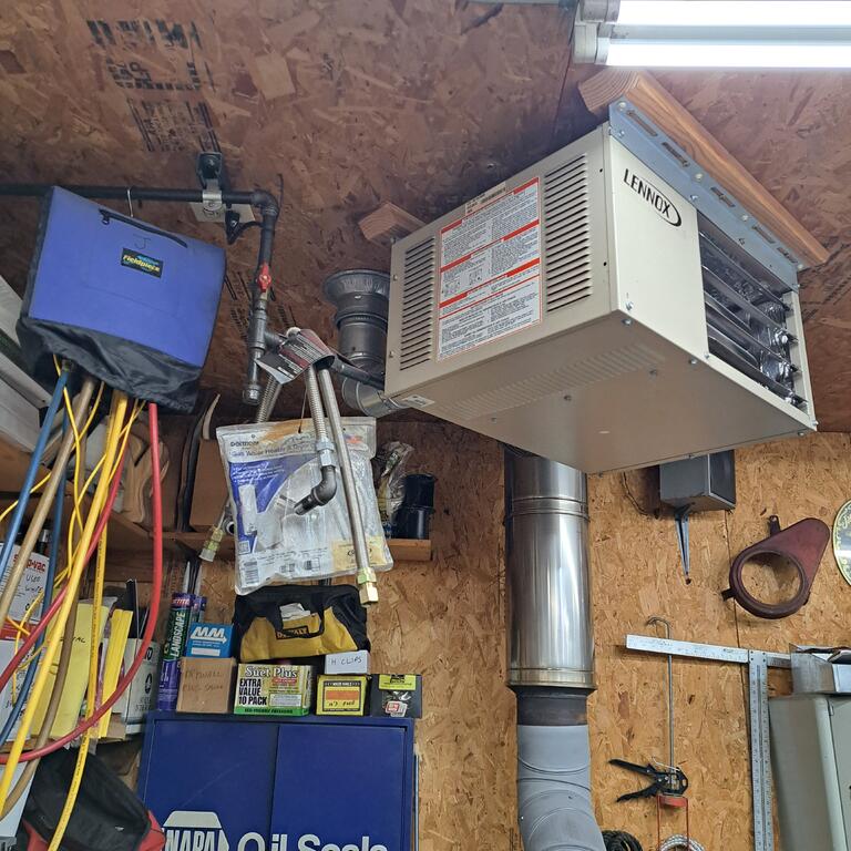

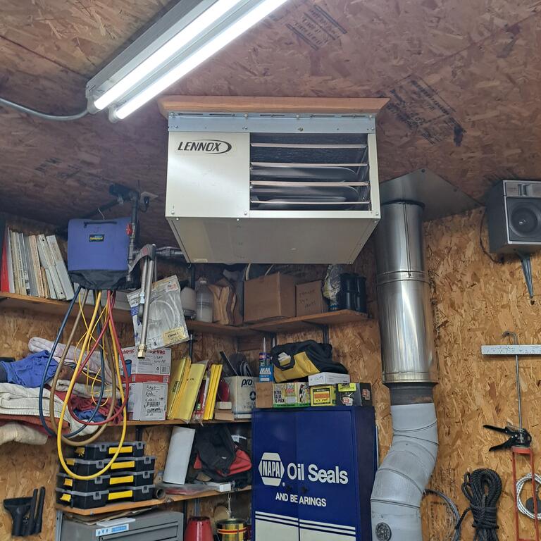

WHX?? 58,126 #27 Posted February 9 (edited) 14 minutes ago, Blue Chips said: I'm looking at getting something similar in the way of a ceiling-mount Without a doubt the best way to heat a shop solid fuel aside. You really don't need a sealed combustion unit unless you can't get decent hanging height. 7 ft. and up. Wall furnaces are a no no unless direct vent (sealed combustion). Mine is on a wi fi thermostat so I can run it from anywhere ... perk of being in the trade. Edited February 9 by WHX?? 5 Share this post Link to post Share on other sites
JCM 11,415 #28 Posted February 9 Sealed combustion is the only way by CODE to legally install it. No more drawing inside air anymore. @WHX?? 1 Share this post Link to post Share on other sites
JCM 11,415 #29 Posted February 9 20 minutes ago, Blue Chips said: The current electric heater in my shop is a 5,000 watt unit (a little over 17K BTU), and it can keep the shop (about 500 square feet) warm when the temps drop below zero, but the power bill ! We're on CMP as well, and I'd probably use an unprintable expletive to describe the power bill, a good portion of which is attributable to my electric workshop heater. My workshop is in our old two-car garage, which is pretty well insulated...walls, ceiling, and garage doors...and the current 5,000-watt heater keeps it nice and cozy, but it doesn't feel quite as comfortable when I remind myself that my power bill is helping to subsidize Spain's economy...not that I have anything against Spain, but gee whiz. AMEN 2 Share this post Link to post Share on other sites
WHX?? 58,126 #30 Posted February 9 18 minutes ago, Blue Chips said: condensation on my equipment, primarily during the cooler parts of the spring Always a problem here Chips. Open that overhead and warm moist spring air makes the floor sweat profusely. Fans help. The one I piced about is a 30K flavor and great for my 768 sq ft shop but 45K is much more common. The big thing is don't oversize. I see 80ks in smaller garages and all they do is short cycle which is bad for efficiency and further unit internal condensation issues. Something guys don't know is a gas appliance is at peak efficiency when running 24/7. Bigger is better only applies to tractor HP. 2 1 Share this post Link to post Share on other sites
WHX?? 58,126 #31 Posted February 9 (edited) 22 minutes ago, JCM said: CODE Not here Plunge unless prudent design prescribes it or a severely contaminated environment. Welding fumes, combustible fumes or those damned wood workers... Had a wood working shop turn one into a gas fires solid fuel unit! You guys know how saws throw dust in the air. Commercial ... only code if less than 8' Ft from bottom of unit to finished floor. Yeah I have had inspectors measure. Or again design considerations. Edited February 9 by WHX?? 2 Share this post Link to post Share on other sites
WHX?? 58,126 #32 Posted February 9 (edited) On that filter Plunger ... I had a hydro come in with that on it and I shoulda cleaned it up and put it on the vintage shelf instead of tossing. Forgive me father for I have sinned ... Edited February 9 by WHX?? 2 Share this post Link to post Share on other sites
JCM 11,415 #33 Posted February 9 1 hour ago, WHX?? said: I do like that plenum they exhaust/draw from you have. Guessing a Modine option? Had to take some careful measuring to get lined up with the heater for strait out like that. My thought process on making the Modine heater line up with the concentric box was to make a cardboard box the exact dimensions of the heater with new cardboard ( as you are well aware of the amount of cardboard we generate in the trades ) Then transfer all dimensions from the heater on to the back of the box with a straight edge and a sharpie . Then mount the concentric. And yes that is a factory Modine option. 2 1 Share this post Link to post Share on other sites
WHX?? 58,126 #34 Posted February 9 (edited) 2 minutes ago, JCM said: Modine heater line up with the concentric box And then have framing studs in the way ... Pic of the outside Plunge? Edited February 9 by WHX?? 2 Share this post Link to post Share on other sites
