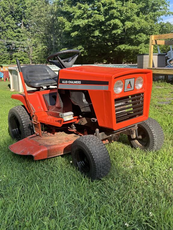

Chris689 355 #1 Posted February 6 Last year I purchased this Simplicity 5212 for $40. Someone swapped in a 18HP Briggs. Came with 4 different mower decks and only the 36” was in good shape to actually use. The others were either rotted, seized or both. Would only run half choked and battery wouldn’t charge. I replaced the chinesium carb with and oem carb and it ran perfect. Then swapped out the regulator and the charging system came back around. Then I found out Allis owned and sold Simplicity in 83. This tractor is an 87 but I decided I wanted to make a replica. 14 1 Share this post Link to post Share on other sites

Chris689 355 #3 Posted February 6 5 minutes ago, Easton Rich said: I like the idea! Thank you! Allis had their 616 hydro tractor which was the same chassis and body as this 5212. The decals are repops for the 616 so the project came around almost perfect lol. 2 Share this post Link to post Share on other sites
