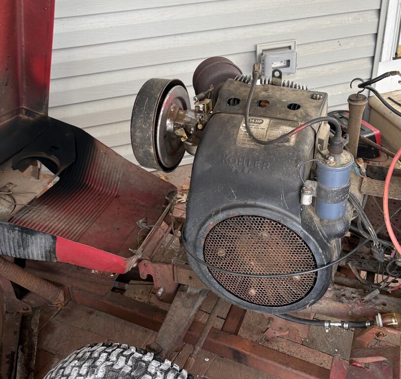

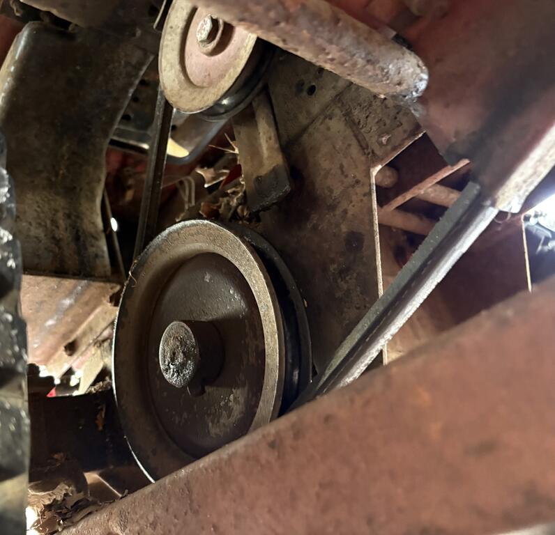

JGuen 2 #1 Posted February 4 Hey all, I got a wheelhouse 414-8 last year and am trying to do a full rebuild on the engine and transmission. I believe the engine is a K321 14Hp however just looking for a little verification so I am sure I order the right rebuild kit. I’ve attached some pictures my engine sticker is very faded the only thing I can read is Spec Number 60440. I’m not sure how to verify the transmission so if anyone knows the normal one on these motors please let me know. Any help would be greatly appreciated. Share this post Link to post Share on other sites
squonk 47,261 #4 Posted February 4 Do not order anything until the engine is torn down and crank. And cylinder bore is measured. 2 4 Share this post Link to post Share on other sites
pfrederi 20,823 #5 Posted February 5 Kohler Engines K321-60440 WHEEL HORSE OEM Parts, Kohler Engines Share this post Link to post Share on other sites
gwest_ca-(File Mod) 12,321 #6 Posted February 5 This should be the transmission you have model 110995 1 Share this post Link to post Share on other sites

c-series don 12,045 #9 Posted February 6 What exactly is wrong with the transmission that it needs to be rebuilt? Generally a good flushing if it has any signs of water in the oil, or perhaps some external seals that need to be replaced will do the job. When draining the oil make sure you safely lift the front of the tractor at least a foot off the ground to get the oil over the internal hump in the transmission.They are pretty bulletproof. If the axle seals need to be replaced start soaking the hubs with a penetrating oil now so they can be removed. 1 1 Share this post Link to post Share on other sites
