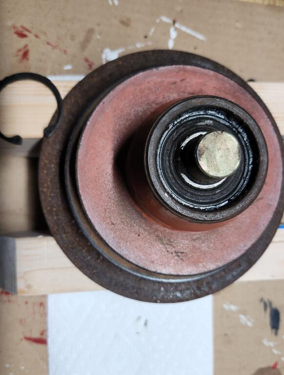

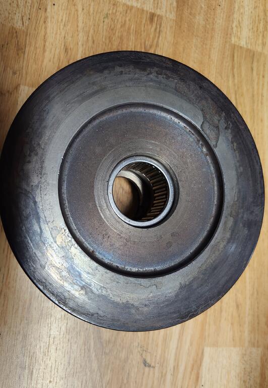

Retired Wrencher 6,989 #26 Posted February 6 On 2/4/2026 at 7:25 PM, Chris689 said: I’m also looking for a little insight into the PTO bearings. Should I replace them before they possibly go bad? Due to how long it’s been sitting I’m considering replacing the bearings and the seal is junk anyway. Also the grease is old so I pulled the PTO to clean everything out anyway because it spins even when not engaged. The shaft is kinda sticky from the old grease which I believe is causing this. I will be installing a PTO brake and the bracket required to mount the brake since I’m assuming 1973 didn’t have them at all as mine doesn’t have one. All in all, should I just pull everything, clean and re-grease, replace the seal and re-install or just replace the bearings and seal and obviously clean things up. Try grease them first. Use a brush put plenty of grease all over the bearings. Turn by hand and reapply more grease. I did a few times and it worked for me. Share this post Link to post Share on other sites
Racinbob 13,193 #27 Posted February 6 It's a bit late now but I just plug the PTO housing from the outer side and fill it with degreaser. I'll leave it sit a day or 3 rotating the bearings now and then. A good flushing, repacking, seals and you're good to go. 5 1 Share this post Link to post Share on other sites

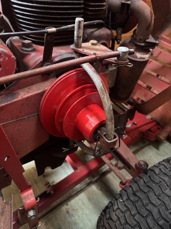

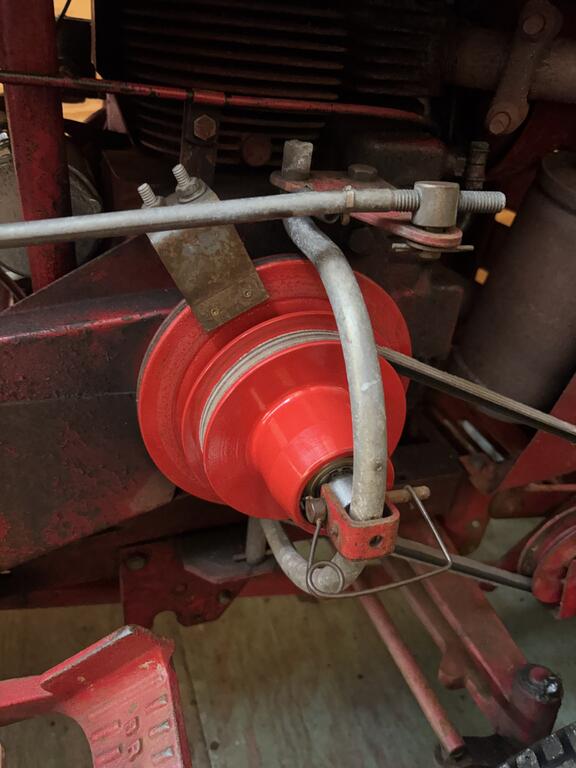

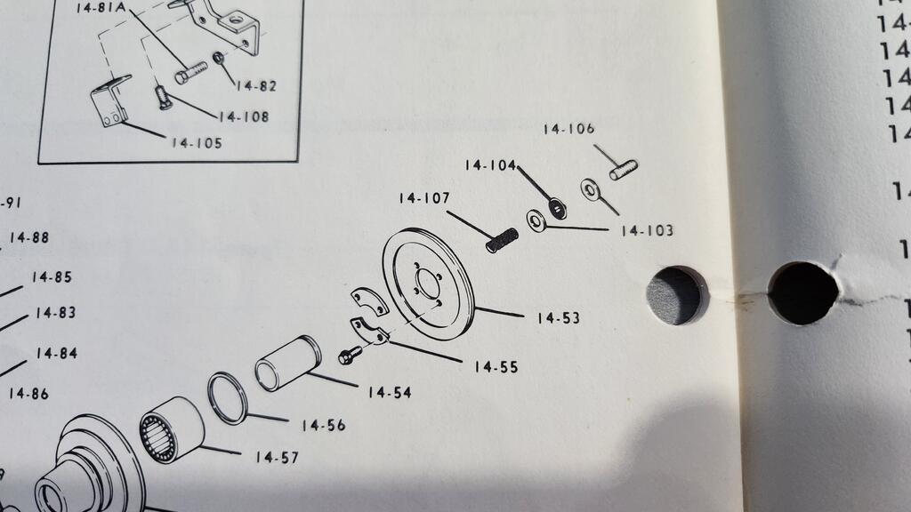

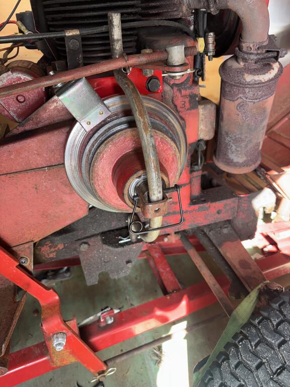

Chris689 323 #28 Posted February 6 So I pulled the PTO off my 77 C120 last night to see if it would work on the 73. The 73 has a 6” PTO and the 77 has a 6 3/4”, didn’t know if it would work. When I pulled the PTO from the 77 I found a bolt with a spring on the end of the crank to help with disengagement and drive the PTO into the brake. Is this a factory setup or would this be a mod someone did? I can’t find it referenced in any parts manual. Just curious. 1 Share this post Link to post Share on other sites
Chris689 323 #29 Posted February 6 13 minutes ago, Racinbob said: A good flushing, repacking, seals and you're good to go. Yeah I’m regretting my life choices at this point lol. 1 Share this post Link to post Share on other sites
Racinbob 13,193 #30 Posted February 6 (edited) 23 hours ago, Chris689 said: So I pulled the PTO off my 77 C120 last night to see if it would work on the 73. The 73 has a 6” PTO and the 77 has a 6 3/4”, didn’t know if it would work. When I pulled the PTO from the 77 I found a bolt with a spring on the end of the crank to help with disengagement and drive the PTO into the brake. Is this a factory setup or would this be a mod someone did? I can’t find it referenced in any parts manual. Just curious. That's a factory setup. Shortly after that they added another retaining ring and eliminated the spring and a couple other parts. I don't know exactly when. I think they eliminated all 5 of those parts on the end of the crankshaft (103x2, 104, 106 & 107) Edited February 7 by Racinbob 2 Share this post Link to post Share on other sites

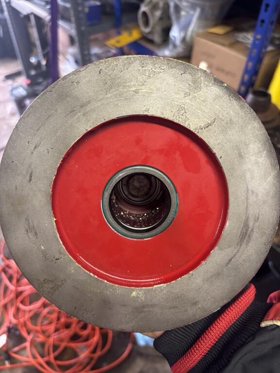

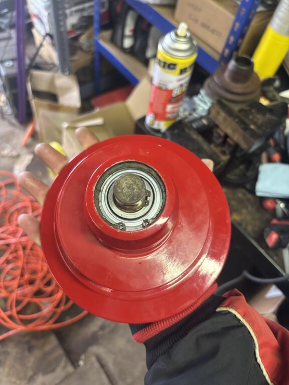

Chris689 323 #31 Posted February 17 Been a little bit but I finally have a small victory for an update. Finally got in all the pieces to put together another PTO. Went from the original 6” to the 6-3/4” PTO. It was the only one I could find and worked out since I’m adding the PTO brake and needed the larger diameter anyway. Plus this one was very nicely referbed. Pressed in new bearings and a new seal and installed. Now I’m just waiting on the rest of the pieces for the spring assembly for the end of the crank to help with disengagement. And the PTO brake bracket. Once that’s all finished, I’m moving on to replace the front axle and pivot pin. After that, finally paint. 2 Share this post Link to post Share on other sites

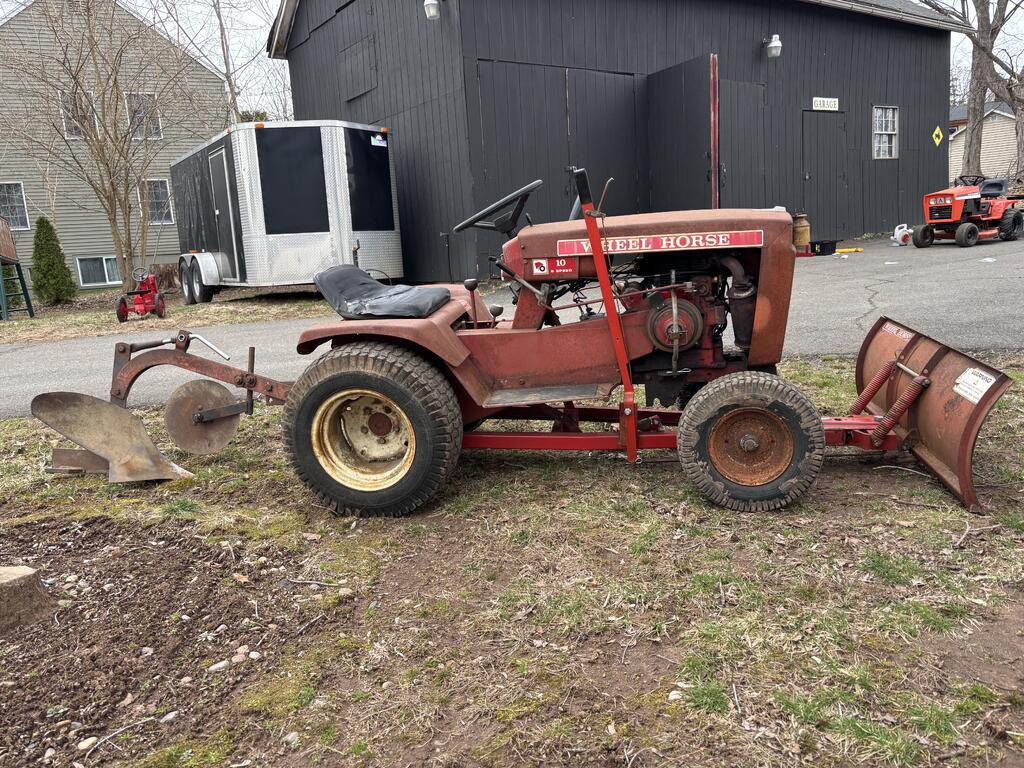

Chris689 323 #32 Posted March 2 Got another update. This time with both tractors. So I purchased everything to modify the 73 to have a PTO brake and the compression spring to help disengage the PTO. Got everything installed and the spring was compressing before the PTO made contact with the clutch disc. For hahas I pulled the PTO off my 77 and it was no longer an issue, put the brand new one on the 77 and that worked just fine too. Not sure what the issue is but either way, they both ended up working, just not the way I thought it would lol. Also, I found this 8” Brinly that I believe is an early 70s as the paint was white at some point in its life. Got for a steal I think too. I’m hoping that Brinly hasn’t changed their parts much if at all. The trunnion and crank handle are rotted together. I did order the parts from Brinly and hopefully they’ll work out. 2 3 Share this post Link to post Share on other sites

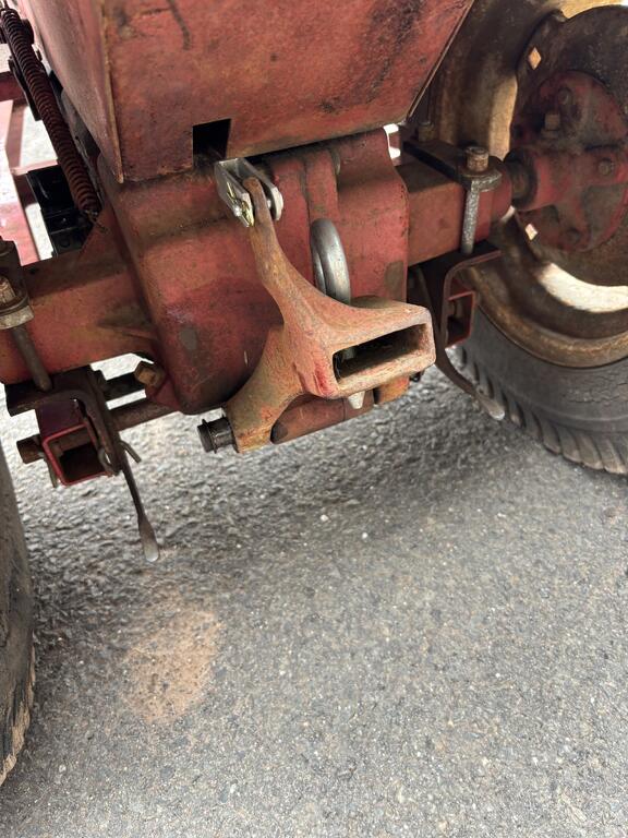

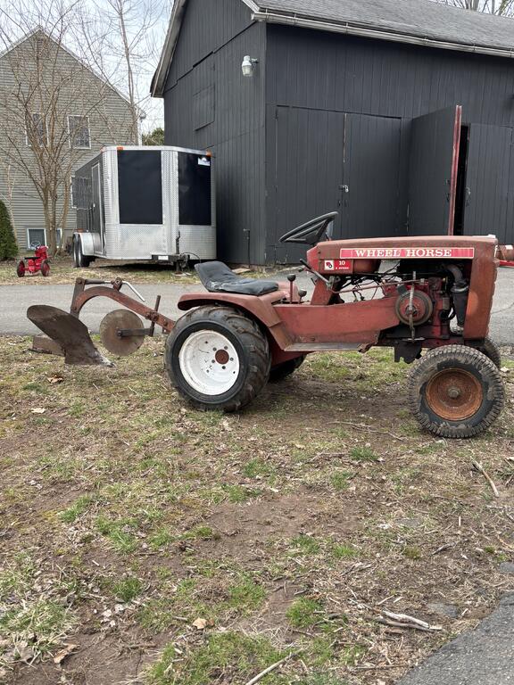

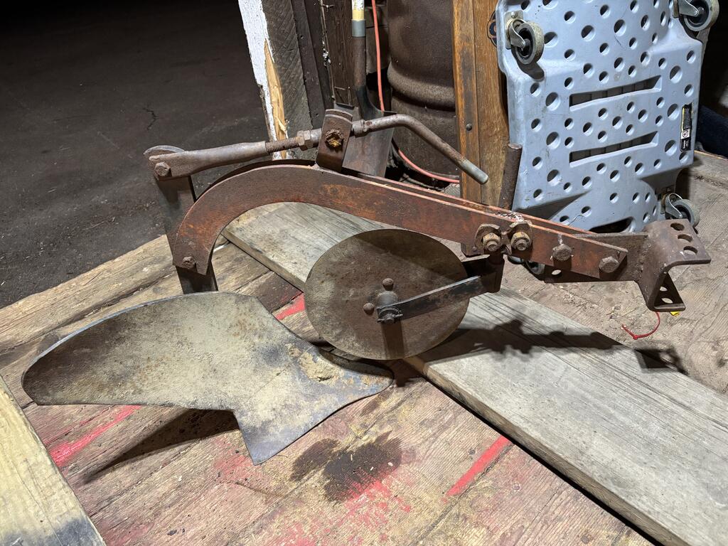

Chris689 323 #33 Posted March 27 Finally another update. I managed to source every individual piece to install a slot hitch. All pieces came in over the last couple weeks and today finally had some time to put every thing together.also took the AG tires off the 77 for temp use on this one so I can dig out the garden. 3 2 Share this post Link to post Share on other sites

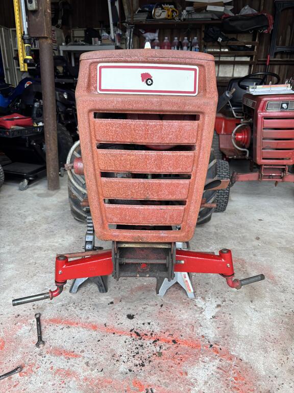

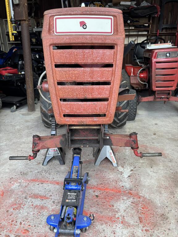

Chris689 323 #34 Posted March 30 (edited) So I went out to clean the snowmobile side of the barn this morning and got detoured slightly. Found the new axle and pivot pin buried on my bench and decided to get that all put together. Unfortunately I figured out I need to get new tie rods. Then loaded the rear tires with RV antifreeze and ended up pulling the threads out of the hub for one of the lug bolts so now need a new hub. Lots of highs and lows today lol. Edited March 30 by Chris689 2 Share this post Link to post Share on other sites
