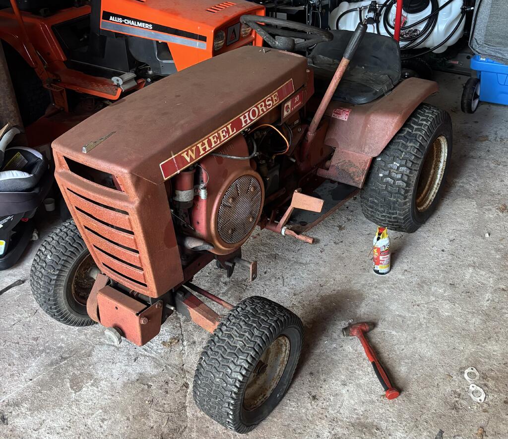

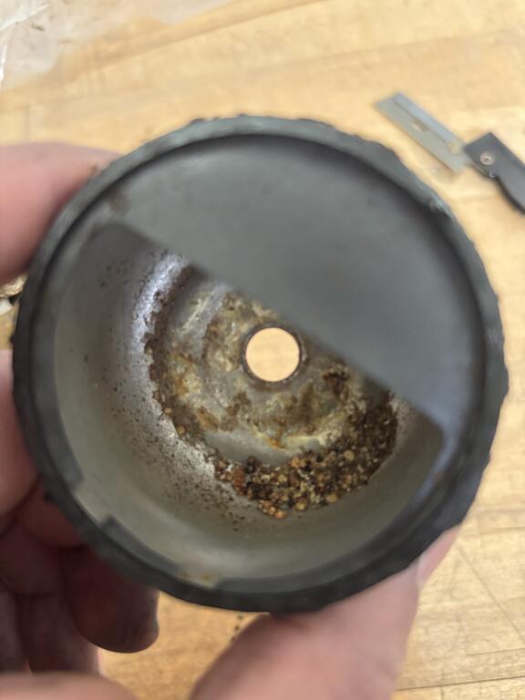

Chris689 355 #1 Posted February 4 So I bought this tractor roughly three weeks ago. Not running and trans completely locked. Getting it on the trailer was a lot of fun. Got it home, pushed it in the barn and figured I wasn’t going to get anywhere with it for a little while. Well one night I randomly decided I was gonna pull the carb and clean it. Brought it to work and took it apart. None of the gaskets tore but I did find basically sand or god knows what in the bowl. Threw it in the ultrasonic for a few hours, didn’t have any new gaskets at the time so I figured just to find out if it would run I just slapped the carb back together with the old gaskets and threw it back on the engine. Ran new fuel line and filter. Put a small amount of gas in the tank and it finally fired, took a little to fill the bowl and re-prime the pump. 4 3 Share this post Link to post Share on other sites

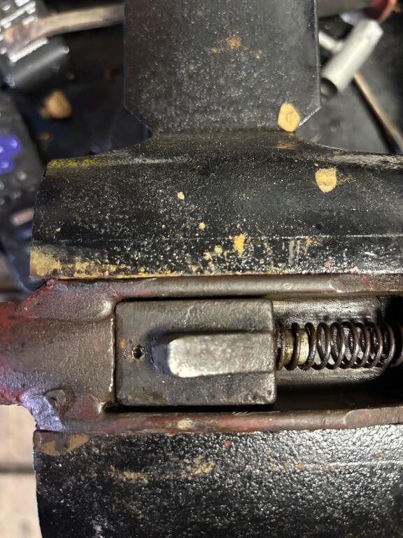

Chris689 355 #2 Posted February 4 Got it running then it was time for the trans. Had no idea what condition it was in just that it wouldn’t roll and the shifter was in neutral. While running I put it in reverse and let the clutch out and it went backwards. I then ran it through all the gear and hi-lo range and it worked perfectly. I decided it was a good time to throw the plow on even though the handle wouldn’t lock in the up position. After days of juicing the handle down the button still wouldn’t pop up on its own. Took the handle and rock shaft out and found the lock block to be cockeyed in its track causing it to jam. Separated it from the button rod and put a small bend in the rod to match the contour of the handle and it worked perfectly. 4 1 Share this post Link to post Share on other sites

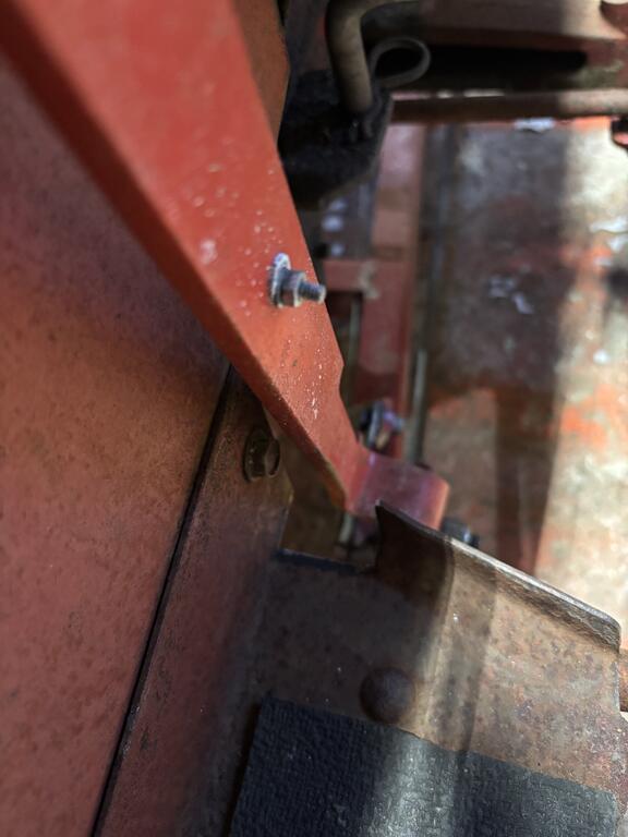

Chris689 355 #3 Posted February 4 (edited) Next was the blade angle lever. Because this doesn’t have the separate clutch and brake pedal like my 77 C120, the different foot board wouldn’t allow me to pull handle past the center position. Cut a small notch and now the lever has full range of motion. Edited February 4 by Chris689 5 1 Share this post Link to post Share on other sites
WHX?? 58,388 #4 Posted February 4 15 minutes ago, Chris689 said: trans completely locked. Frozen water in it? Been there done that. Time to drain and flush. Nice Allis ther ... 2 1 Share this post Link to post Share on other sites

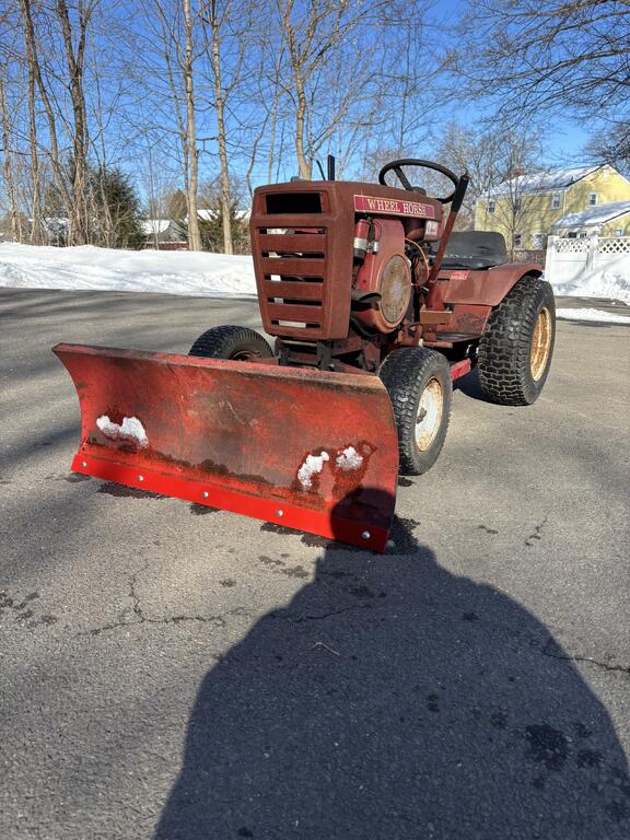

Chris689 355 #5 Posted February 4 Finally the tractor is 100% usable but not 100% done so there will be more to come. Right now it’s being used as the snowplow when I don’t have enough snow to use the 120 with the blower. It’s gonna get all the main sheet metal pulled in the spring and going to get just a quick scuff and shoot and new decals hence the “Budget Resto”. Don’t want it to be too nice that I’m afraid to use it lol. Then the 120 will be next on the docket but that’s just paint. 5 4 Share this post Link to post Share on other sites
Chris689 355 #6 Posted February 4 3 minutes ago, WHX?? said: Frozen water in it? Been there done that. Time to drain and flush. Nice Allis ther ... Thank you that was last years project. It’s a Simplicity 5212 that I did as an Allis look-a-like. Previous owner swapped in an 18hp Briggs. Im not sure if it was water or just stuck in gear. The second I let the clutch out it moved so I’m assuming it was just stuck. Regardless I will be doing a drain and flush. 6 Share this post Link to post Share on other sites

oliver2-44 11,847 #17 Posted February 5 6 hours ago, Chris689 said:. None of the gaskets tore but I did find basically sand or god knows what in the bowl. Threw it in the ultrasonic for a few hours Most likely dried ethanol crap. W e recommend using ethanol free gas. I love my ultrasonic. 4 1 Share this post Link to post Share on other sites
Chris689 355 #18 Posted February 5 1 minute ago, oliver2-44 said: Most likely dried ethanol crap. W e recommend using ethanol free gas. I love my ultrasonic. Unfortunately I’m unaware of anywhere near me that has ethanol free. I at least only run premium in all my small engines (yeah still has ethanol) but I also don’t let anything I have with an engine sit for really more than 2-3 weeks without running just to keep things moving. I’ve honestly never used an ultrasonic to clean a carb until now. I’ve always used super clean to soak everything then carb clean and compd air to blow everything out. I threw this into the ultrasonic at work during lunch and let it soak for 4 hours. Needless to say between the tractors and the snowmobiles i need to invest in one lol. 2 Share this post Link to post Share on other sites
