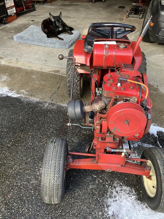

Retired Wrencher 6,989 #1 Posted February 4 (edited) I have a 1057 I am working on. Looking for a different muffler than the stock one that it came with. Because they’re loud and this was an actual Kohler brand muffler. Let me know what you guys use on these old tractors that is fairly quiet. I have been using the short gravely muffler. They’re nice much quieter than the original screw on Kohler muffler. . Let me know what you’re thinking. Edited February 4 by Retired Wrencher Share this post Link to post Share on other sites

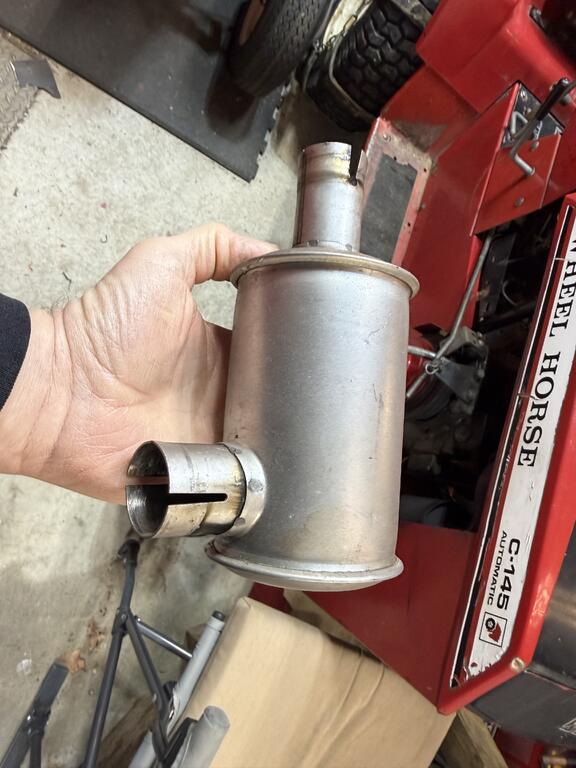

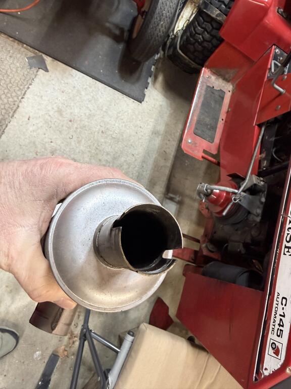

Sparky-(Admin) 26,359 #3 Posted February 6 Is this what you are calling a Gravely muffler? 1 Share this post Link to post Share on other sites

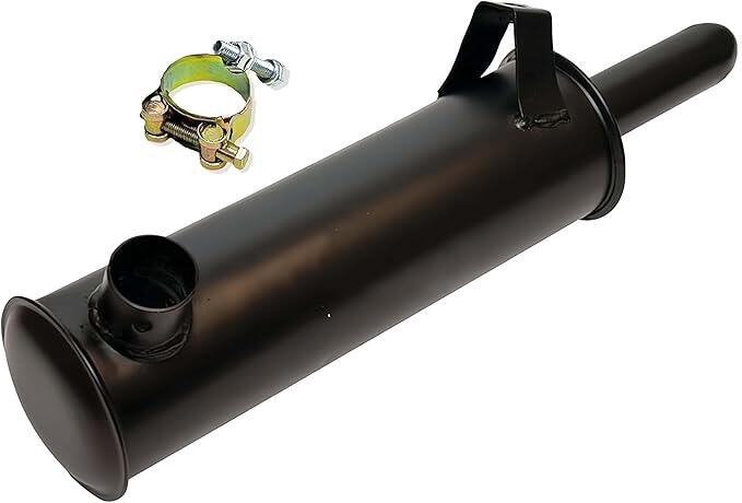

OoPEZoO 609 #4 Posted February 6 Not pretty, but this is what I have had on my 314 for the past few years. Its cheap off the jungle site, works/sounds fine 2 Share this post Link to post Share on other sites
Sparky-(Admin) 26,359 #5 Posted February 6 10 minutes ago, OoPEZoO said: Not pretty, but this is what I have had on my 314 for the past few years. Its cheap off the jungle site, works/sounds fine Is it only attached using that clamp? Or were you able to use that bracket I see on it for added support? Share this post Link to post Share on other sites

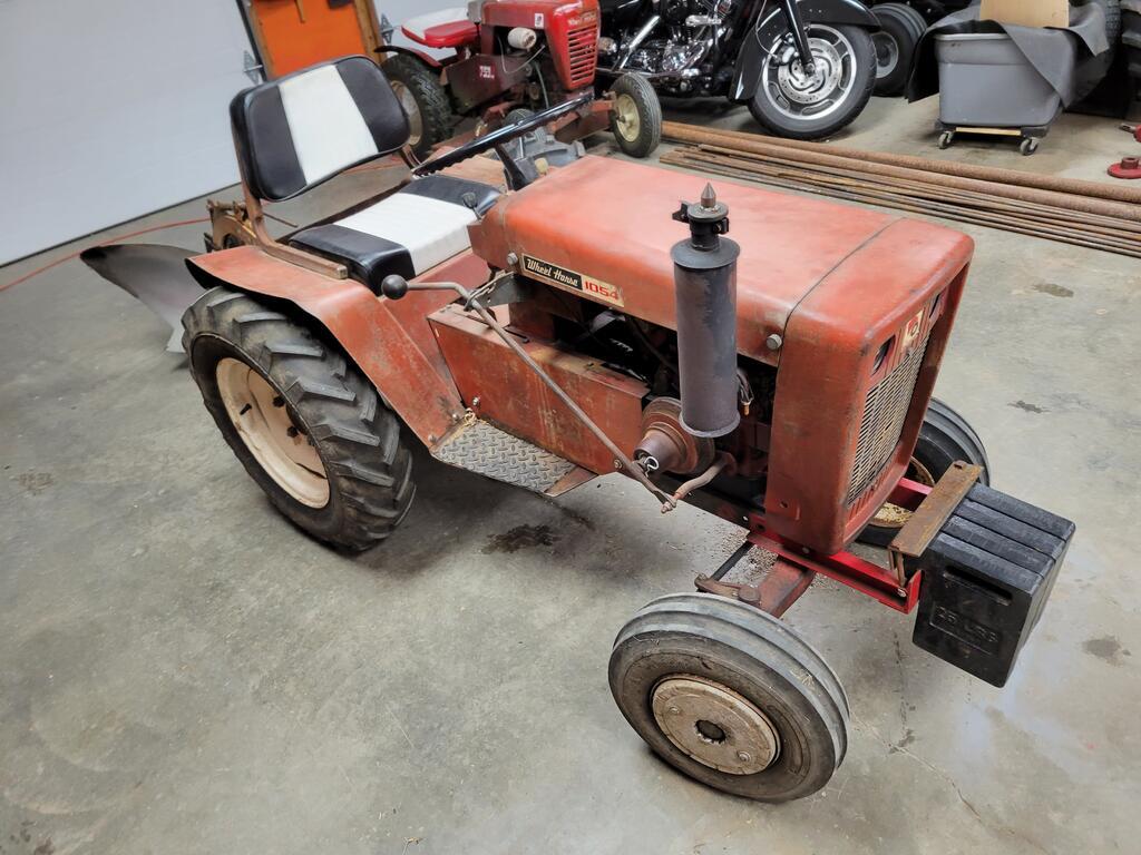

WHX?? 58,125 #7 Posted February 6 (edited) I shouldn't say anything since I'm an original freak but I'll second the cub muff. Very mello and has a pleasing chug chug sound. 23 minutes ago, Sparky said: I see on it for added support? Naw most guys just cut them off. It's pretty light & doesn't need any additional support. Cut the outlet off square and you can add a tink tink. Bad part for Wrencher Is he would almost have to take the original off to the block & we know that getting the nipple out of the block can be a rite of passage. I have one of those NOS gravely types if your interested Wrencher. Edited February 6 by WHX?? 1 Share this post Link to post Share on other sites
OoPEZoO 609 #8 Posted February 6 4 hours ago, Sparky said: Is it only attached using that clamp? Or were you able to use that bracket I see on it for added support? yup, just the clamp. Threaded pipe nipple in the head to a 45 to a cut off pipe and clamped. I have mine aimed straight up. It’s been that way for 100’s of hours of use with no issues. I keep wanting to cut that bracket off, but it’s been a few years and at this point, I’m assuming I’ll never get around to it 2 1 Share this post Link to post Share on other sites
mudmowerdiesel 236 #9 Posted February 6 2 hours ago, OoPEZoO said: yup, just the clamp. Threaded pipe nipple in the head to a 45 to a cut off pipe and clamped. I have mine aimed straight up. It’s been that way for 100’s of hours of use with no issues. I keep wanting to cut that bracket off, but it’s been a few years and at this point, I’m assuming I’ll never get around to it Awesome looking Share this post Link to post Share on other sites
OoPEZoO 609 #10 Posted February 6 Thanks. I’ve have had that tractor for over 20 years and I’ve been happy with every little mod I’ve done to it to make it more productive or user friendly. It’s a bit of a toy project at this point, it still gets lots of use Share this post Link to post Share on other sites

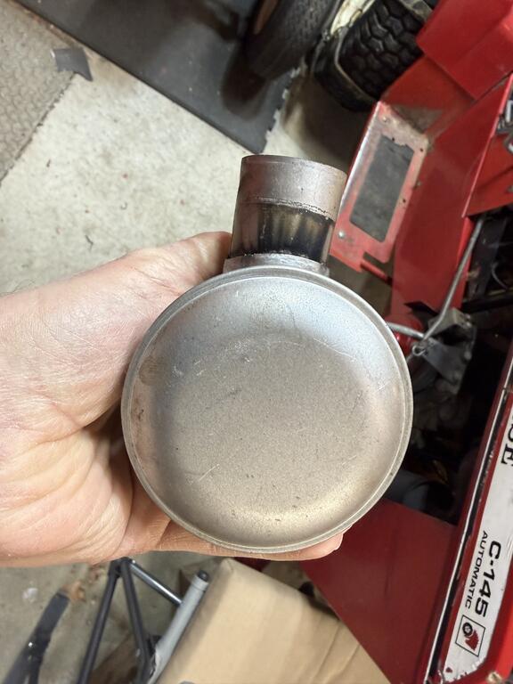

Retired Wrencher 6,989 #12 Posted February 7 (edited) 22 hours ago, Sparky said: Is this what you are calling a Gravely muffler? That is the one Mike. For what they are there not a bad muffler. I have in the past cut the bottom of a little to get rid of the two cut outs. It makes it look a little better. Edited February 7 by Retired Wrencher Share this post Link to post Share on other sites

Retired Wrencher 6,989 #14 Posted February 7 20 hours ago, Sparky said: Is it only attached using that clamp? Or were you able to use that bracket I see on it for added support? I was looking at that one Mike, but looks like some fab work would have to be done. I just did not want to deal with that. Thanks for the reply. Share this post Link to post Share on other sites
