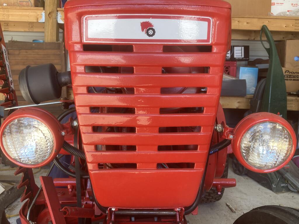

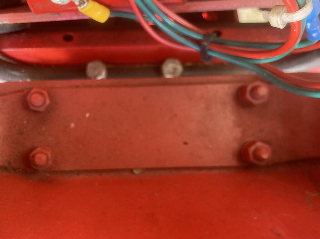

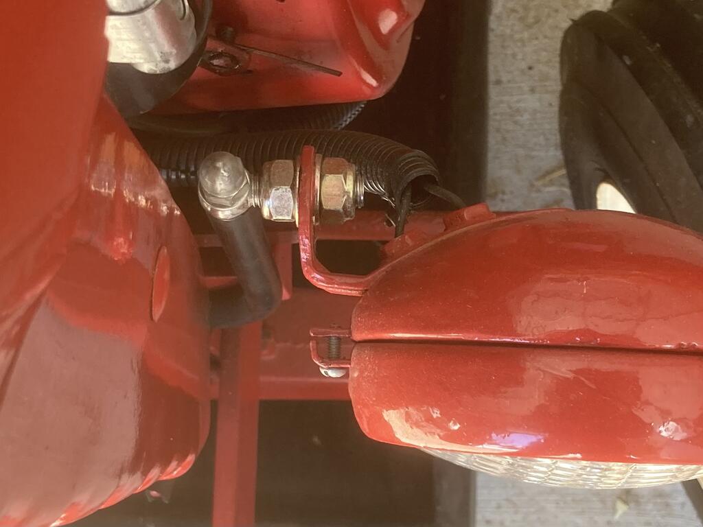

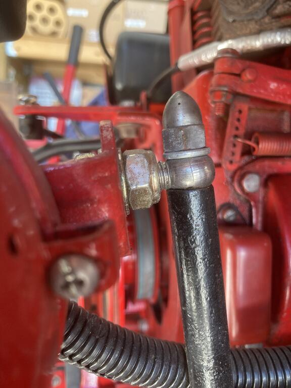

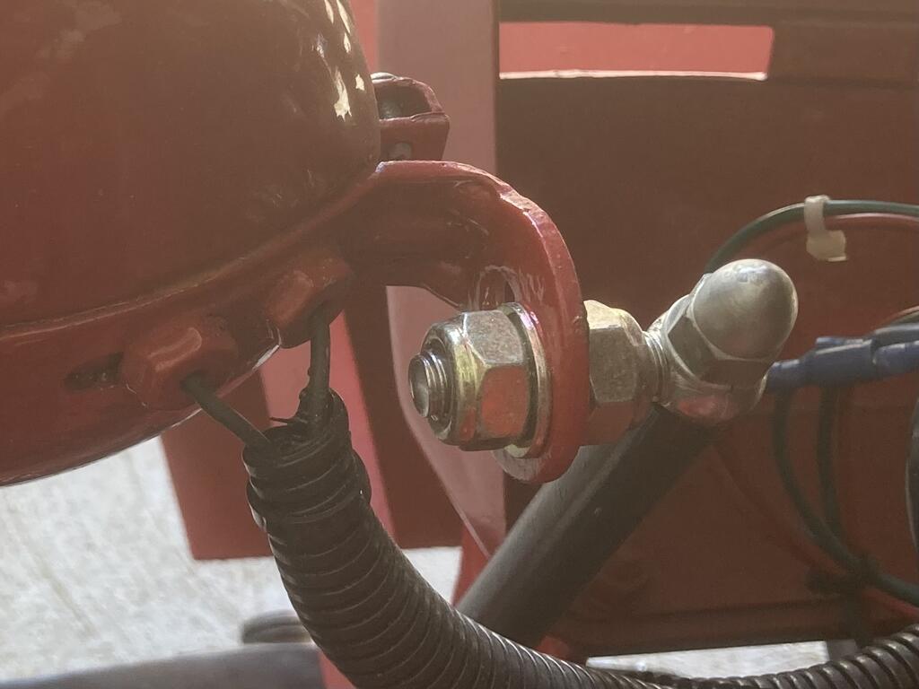

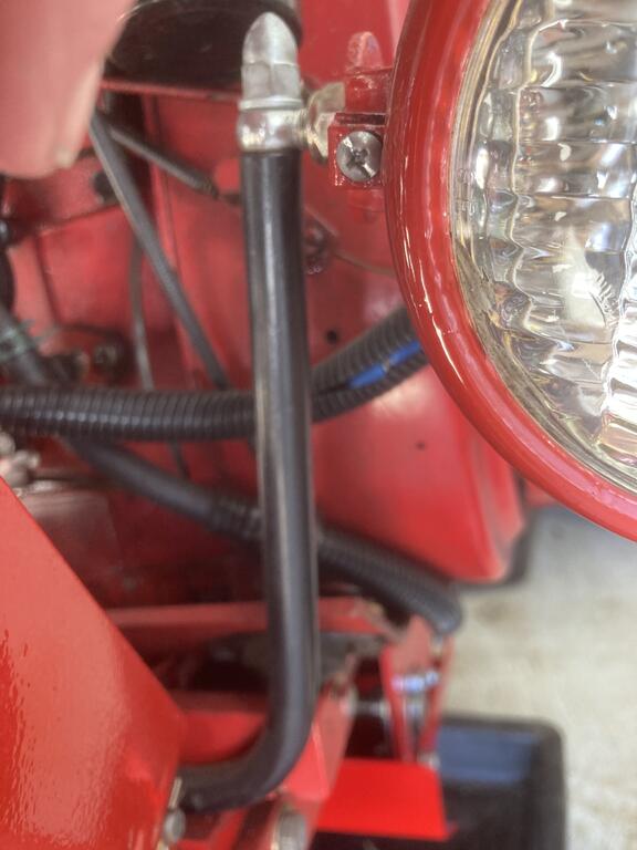

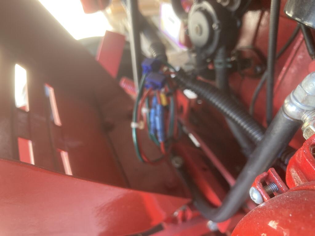

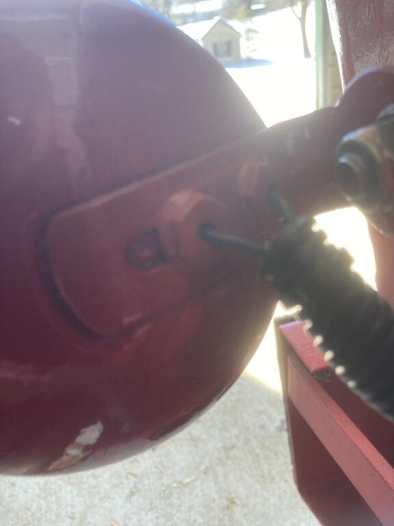

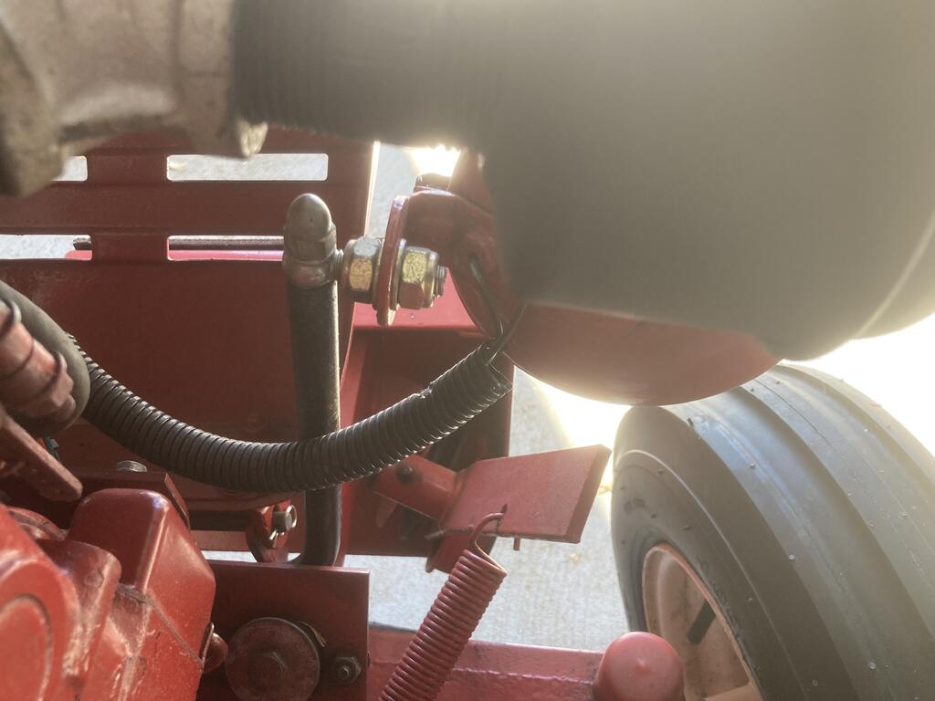

"Manic-Mechanic" 1,486 #1 Posted February 2 (edited) I had a factory set on a 1277 so these are from memory, “might be a bit different!” (Standard 12v tractor lights) Used a knuckle, that’s what I call it, on the end of a 30” x 5/8” steel rod, drilled tapped 3/8-16 utilizing a stud and cap nut. Two wire assembly to assure a solid ground Crimp on connection for hassle free hood removal There’s two 3/8-16 bolted to a threaded rectangular plate between the frame, mimicking factory Closer look at the stainless hardware, that is a metric thread in the knuckle, (euro part) The soft bend sweeps buy the cradle front tightly, has to be just so, plumb to clear I preferred the standard 12v light assembly with options to twist in all directions, do not care for the little bug eye looking factory assemblies! The 5/8 hot rolled steel can be formed quite easily by hand just make identical measurements on both sides. Basic & simple See the hood is very close and the button I put in from a very unstable method used by who-ever owned this hood, bought at big show over a decade ago! Don’t find these as often anymore but I perused eBay, they were actually IH Red! Edited February 2 by "Manic-Mechanic" 6 10 Share this post Link to post Share on other sites
