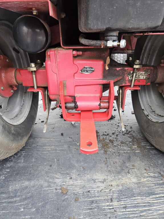

My game plan for the 416H over the next few days is to remove the hub caps, (how do I remove the hub caps? (Without damaging them, I've seen them listed for $200 & up}, install 55 lb. rear wheel weights, cut to fit the front tire chains chains, (they're off a Sears lawn tractor), & install the dozer blade. I have ordered V bar chains for the rear wheels. Rear axle bracket & new Diehard battery were installed yesterday. Axle bracket is 3-1/4 inch to the right from the housing. She's gonna need a good pressure washing in the spring. I remove all the debris I could with my air compressor & 12 inch blow nozzle.

CD long. Find a thin long shaft screwdriver. Gently start moving in a corner that you can get the screwdriver in and go all the way around fairly easy done it many times. Maybe put a towel down on the floor because if you can’t catch it when it will land on something soft.. So it won’t dent the cap.Enjoy the project. I personally would put an electric fuel pump on that because of the gas tank being in the rear. My first wheel horse was a 312 A and it had that rear fuel tank. Took forever to get fuel up to the carburetor. Don’t buy the cheap ones spend a few dollars and buy a good one. I think we had a discussion about this already not sure. Have a good day. It looks like you may have a leakey axel seal on the right side by the picture showing the gas tank.
