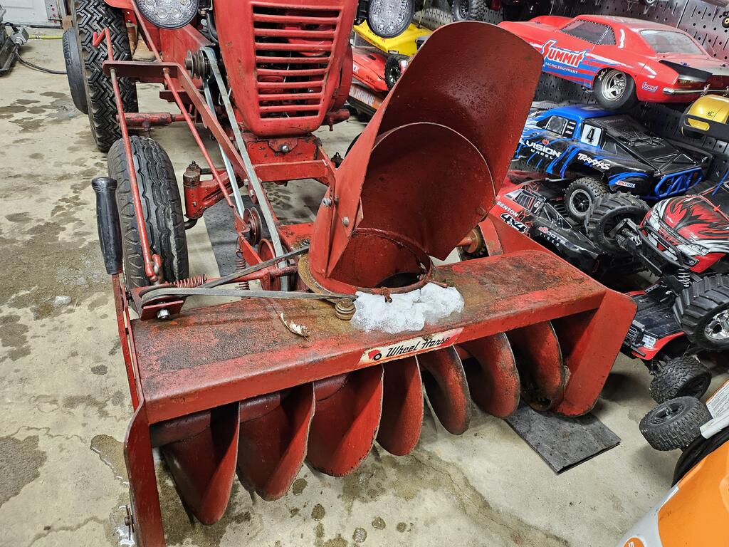

ML3 2,510 #1 Posted January 28 Went out to do some cleanup w/702. Before I even got into snow chain broke when snowblower engaged. All sprockets are spinning free & chain isnt bound/kinked at all. Rerouted it & it appears the master link failed?? Trying to figure out what size chain so I can get a master link or likely just replace the entire chain. Have master links in garage for #35 & #40 chain but neither is correct. From prior posts here I been told that the snowblower is the ST323?? It has the belt to adjust chute. Share this post Link to post Share on other sites
ri702bill 13,068 #2 Posted January 28 Yup, that certainly looks just like my ST-323. I added the non-OE side wings. It uses #40 roller chain for the auger drive. I did an upgrade to mine to give more chain wrap on the auger, using a fixed idler sprocket above the lower one, a longer length of chain is required... 1 Share this post Link to post Share on other sites
wallfish 20,618 #3 Posted January 28 , should be #40 chain. Possible someone changed it to a #41. If your #40 link is bigger than that chain, it's a #41 chain. Change the whole thing since you're in there anyway and go with #40. Like Bill posted, adding a top idler will give the chain a lot more engagement with the auger sprocket. I've blown the master links off on my 2 stage blower quite a few times. Typically it's the DOT road piles that put the most heavy stress on that thing. 1 Share this post Link to post Share on other sites
ML3 2,510 #4 Posted January 29 I know its not #40 cause the #40 master link kit I have is too big. I found some #35 chain in garage & its definitely too small for sprockets. Also had a #35 master link kit. It almost fits....the link isnt wide enough to allow the clip & link to attach. Only the clip will fit. I think.the chain might be #41??? How could something so simple be such a pain?? 🤣🤣 1 Share this post Link to post Share on other sites
WHX?? 58,148 #5 Posted January 29 I'll third the #40. Just bought a spare today. Not to jinx here but hopefully running the wrong chain didn't mess up the sprockets. 1 Share this post Link to post Share on other sites
gwest_ca-(File Mod) 12,488 #6 Posted January 29 (Uses #2175 - # 41 chain Pitch 1/2" and roller width 1/4") 2 Share this post Link to post Share on other sites
ML3 2,510 #7 Posted January 29 6 hours ago, gwest_ca said: (Uses #2175 - # 41 chain Pitch 1/2" and roller width 1/4") I did see in the parts original listing that chain is p/n 2175. After a little more research I'm pretty confident its #41 Guess I'll be stopping at tractor supply on way home from work today....... Thanks! 1 Share this post Link to post Share on other sites

ML3 2,510 #11 Posted January 29 2 hours ago, WHX?? said: You guys sure? I coulda swore it was 40. Could it be 41 for the older ones and 40 for the newer? I can assure you that the #40 chain I had in garage did not fit on the sprockets. And....the #40 master link I had didn't fit either. 1 1 Share this post Link to post Share on other sites
gwest_ca-(File Mod) 12,488 #12 Posted January 29 You may already know this but the U-shaped clip to retain the link must have the U-end facing the direction of chain travel. If not a piece of ice can easily push the clip off never to be seen again. 2 1 1 Share this post Link to post Share on other sites
ML3 2,510 #13 Posted January 29 9 hours ago, peter lena said: @ML3 NAPA , MACS , CHAIN / CABLE LUBE , never let that auger chain get dry , spray after / before any usage , also note the small idler belt pulley on the pto MUEL DRIVE SET UP ? typical dry / rusty bearing failure ? = increased belt drag , related clutch wear . is this adding up ? another thing , like a SNOW SLIDER vinyl gasket UNDER the chute swing base ? pam cooking spray , = smooth easy swing , REPEDITIVE, COLLECTIVE FAILURE , is showing you the way , apply this thought to any related tractor problem . only a suggestion , pete Thanks Pete..... All pulleys, sprockets, & bearings are moving free & I do keep them lubed, probably more often than needed. Will probably take your advice on the gasket under chute to help turn better. Share this post Link to post Share on other sites
ML3 2,510 #14 Posted January 29 For the record.......its #41 chain for my application. Thanks everyone for all your help & advice 1 Share this post Link to post Share on other sites

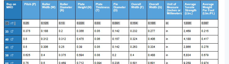

wallfish 20,618 #17 Posted January 30 40 and 41 chain have the same pitch. But 40 is wider than 41 40 sprockets can be made a bit wider than ones made for 41, so sometimes 41 chain can be too snug on some 40 sprockets. But 40 chain will always fit on 41 sprockets (as long as there isn't any obstruction very tight to the sides of the sprocket) but with some side play. Many are made as 40/41 sprockets. 2 Share this post Link to post Share on other sites
