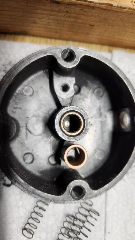

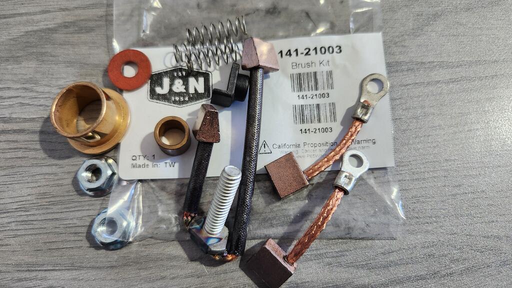

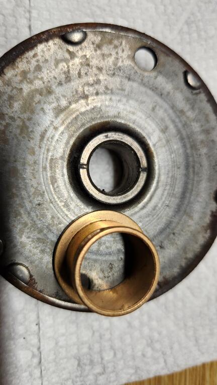

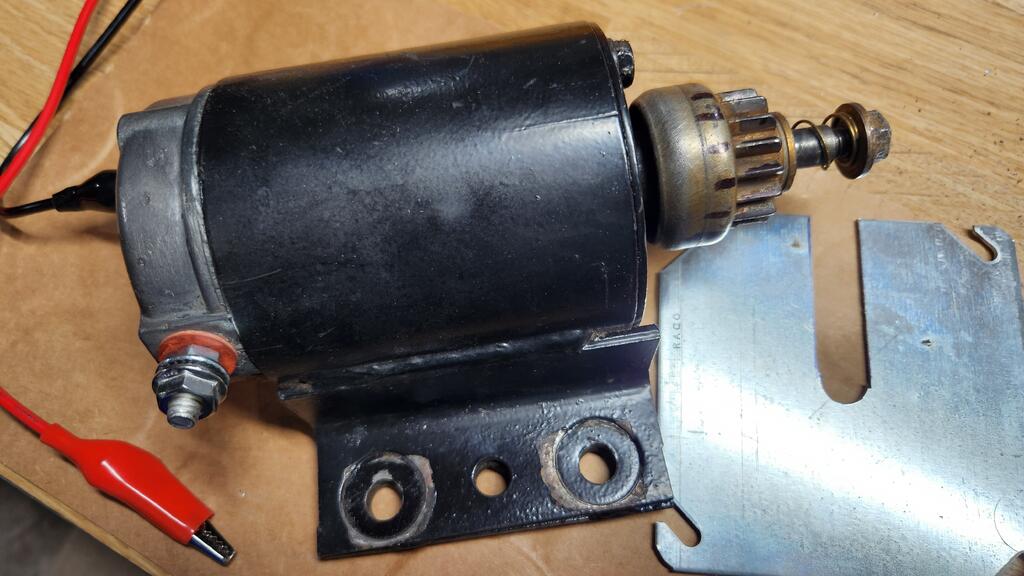

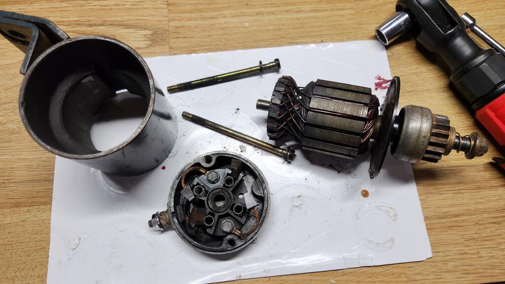

Racinbob 13,290 #1 Posted January 28 It's been a few months since I put a new starter on the K-181 for the reborn B-80. I purchased the rebuild kit for the old one but have yet to find one with the correct bushing on the gear end. The brush end was correct. This morning I just decided to clean it up, lube the bushings and put it back together. It's just going to be sitting on the shelf as a spare. I cleaned up the important stuff, put new brushed in and reassembled it. Leave it to an old electrician to use a 4" sq cover to whip up a hold the brushes down while you put the end cap back on tool. It worked great. Tested and It's good to go. 5 7 1 Share this post Link to post Share on other sites
