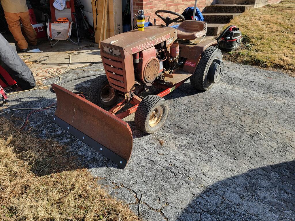

Joker72 96 #1 Posted January 28 (edited) I have a great pulling and mechanically solid '74 c160 Auto but it burns a bit of oil. I would like to use acceessories. Would you have any reservation about putting the effort into replacing rings and re-seating valves with intentions of using it for work? Thanks! Edited January 28 by Joker72 Share this post Link to post Share on other sites

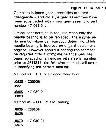

pfrederi 21,151 #15 Posted January 29 Newer balance gears (after 9641310) have loose needles. Older ones are caged. 1 Share this post Link to post Share on other sites
kpinnc 18,967 #16 Posted January 29 2 hours ago, pfrederi said: Newer balance gears (after 9641310) have loose needles. Older ones are caged. I guess it's true we (meaning me) can learn something new every day! 2 Share this post Link to post Share on other sites
