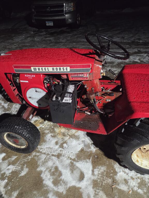

tallen4392 71 #1 Posted January 27 anyone ever use those mighty max gel battery’s they sell on amazon looking for the right size battery for my my charger 12 i went to napa and 4 other parts stores near me no one has it also went to tsc no good there either the tray is 9 long x 5.5 wide i think 9 inches tall.. Thanks Share this post Link to post Share on other sites

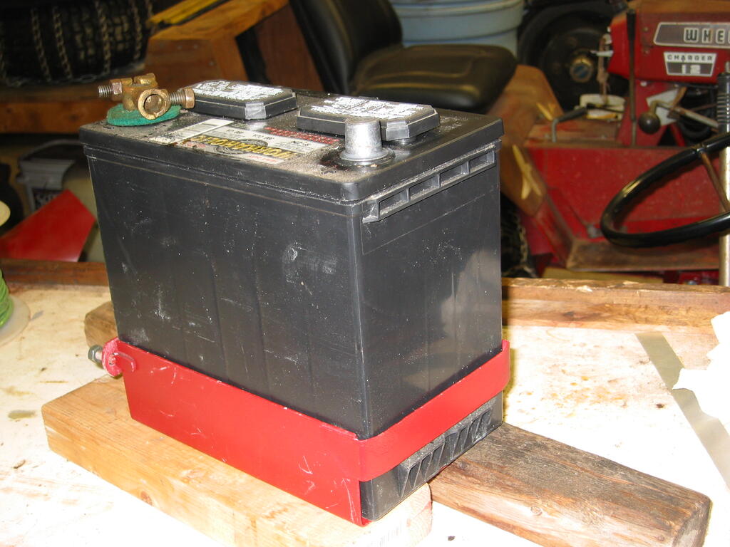

pfrederi 21,151 #5 Posted January 28 Most chargers came with a full sized battery and clamp type connectors. This is a 22NF battery in Charger battery pan. 1 Share this post Link to post Share on other sites

tallen4392 71 #7 Posted January 28 thanks for the pic of the 22nf that’s what i need should be able to find those Share this post Link to post Share on other sites

tallen4392 71 #9 Posted January 28 the 22nf i see online at napa say 9 3/4 inch long which would be to long it would hit the brake lever rod i will have to go there and measure and see if it is 9 inch long which would than fit Share this post Link to post Share on other sites
tallen4392 71 #10 Posted January 28 group 35 battery’s all say 61/2 wide that won’t fit i will go look tomorrow and bring a tape measure. Thanks Share this post Link to post Share on other sites
pfrederi 21,151 #11 Posted January 29 I think over time Wh switched Chargers to the smaller battery box What is the model number of your tractor. Share this post Link to post Share on other sites
pfrederi 21,151 #12 Posted January 29 When it warms up tomorrow I will measure battery boxes there are two sizes... Share this post Link to post Share on other sites
tallen4392 71 #13 Posted January 29 i would have to look for model number i think it is a early model box is roughly 9 x 5 1/2 Share this post Link to post Share on other sites
