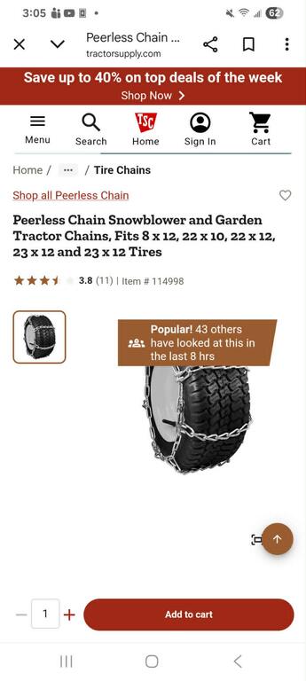

Joker72 96 #1 Posted January 27 Does anyone know if these will fit my C-160's 23x8.5x12 turf tires? Thanks! Share this post Link to post Share on other sites
ri702bill 13,392 #2 Posted January 27 Most likely...but... Not enough crosslinks. Should get the full complement type. 6 1 Share this post Link to post Share on other sites
Joker72 96 #3 Posted January 27 (edited) Thanks! Trying to secure some prior to second phase of this storm rolling in. These are in stock at my local Tractor Supply. But I see your point. Edited January 27 by Joker72 1 Share this post Link to post Share on other sites

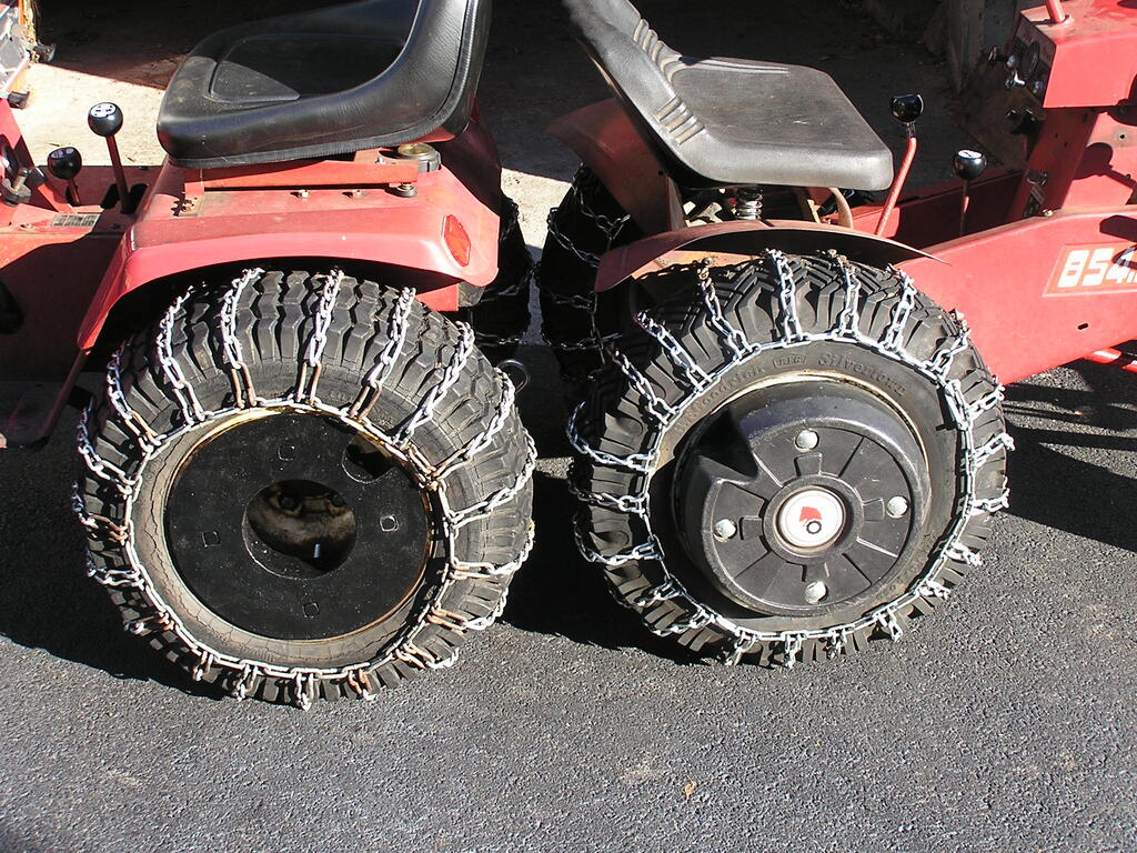

ri702bill 13,392 #4 Posted January 27 And as a side note... additional cross links can be added later. The set on the 854 I made using an old pair of ice grip chains for the side links and all new cross links & connectors. Tough on the hands using the chain pliers though. 1 1 Share this post Link to post Share on other sites
peter lena 10,125 #5 Posted January 27 @Joker72 like the welded rings they have at T/S right in the chain section, pick up some medium pull hook end extension springs , makes snugging up a chain set up easy , like a thin flat screwdriver as your spring slide leverage point . pete 1 Share this post Link to post Share on other sites
