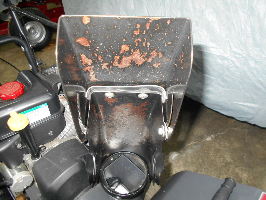

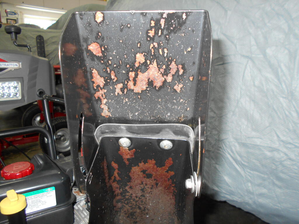

Have a nagging issue with a Short Chute ST modified with a Tall Chute.
When operating with the Chute Deflector (Top with the Handle) positioned all the way back to throw snow High/Long, snow "leaks" out of the gap between the rear edge of the Deflector (18, in the IPC Fig. shown) where it meets the rear Discharge Chute Assy (13). Snow is constantly running out of the gap piling up on the rear of the Chute base, Lift Rod, and the ground.
With the Deflector in the most back/rear position it does not look to be much of a gap between the two. While clearing the latest storm, I figure I need to find out if this is normal or if I'm missing something.
Appreciate all replies.

Take the deflector off and add a flap of rubber to the back outside of the chute so it extends up into the deflector. Pop rivets will work. Then put the deflector back on over the rubber.
That is how Gravely solved that problem on their snow cannons.

@P3x  , sounds like its  chute drag , ?   the entire inside of the  chute discharge , needs some slick help ,  have any PAM CIOOKING SPRAY ?  use that regularly  on any snow slide off area , anything to enhance slide off  , you also might  verify  the entire  discharge  movement ease  function /  set up , have also used mower guard / graphite  spray , on my plow blade for snow slide off , barely engages snow  and  slide off , pete

Snow builds up right there since that's where it's directly blasted too and hits the chute the hardest. You can spray any of that stuff, as I've tried them all,  but it will always wear right off of that spot pretty fast anyway due to the impact and friction of so much snow going through. Mine does the same thing but the amount of it falling back out is no concern to me. But the flap idea Gwest posted should solve it. PM me your address and I'll send you a piece of 45 mil EPDM rubber roofing material if you need something use and want to try that. Cutting an old inner tube would work for making a flap too.
I tried using stiff plastic this year to line the entire chute for slickness but that spot got blasted right off on the first storm and broke it. The bottom section of plastic is still there and works well to solve the snow sticking to that section.

I use SnowJet on STs and Snow Shovels prior to snow storms - works great.
I think Gary hit it on the head. The gap is very small and amazed at the amount of snow that sneaks thru.
May try to finish cleaning this storm. If it works - great. If not, will pop rivet a piece of rubber.
