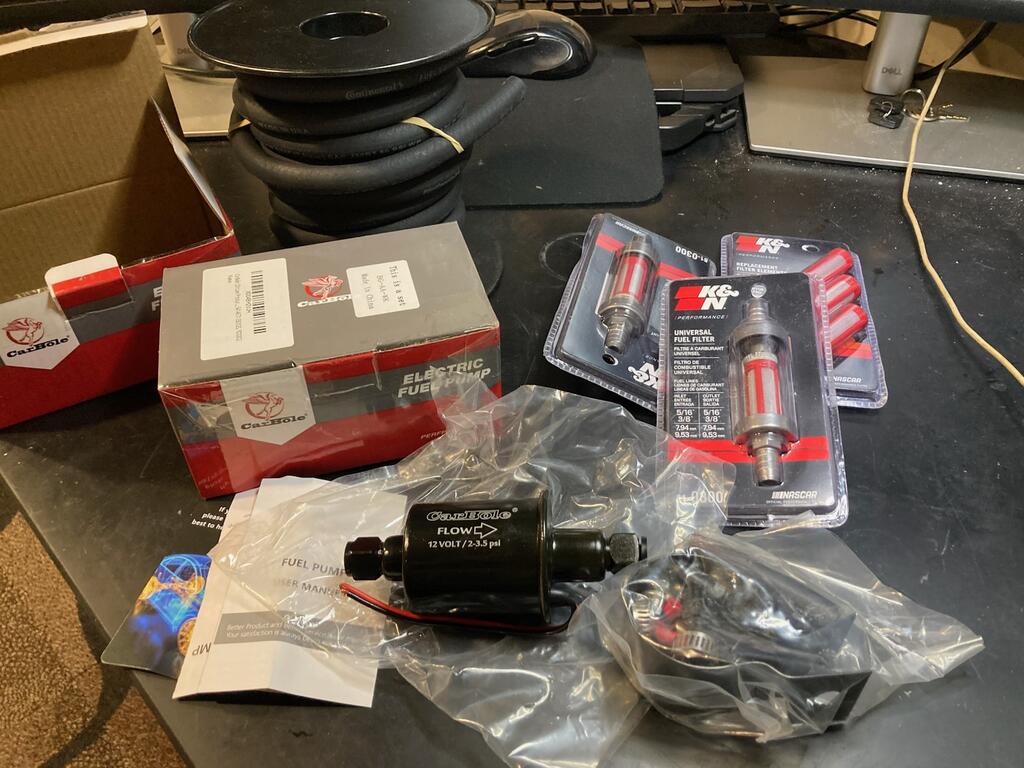

ineedanother 2,865 #31 Posted February 26 I need to convert both of mine with fuel under the seat pan to electric but plan to stay with mechanical pumps on the ones with under-hood fuel for the time being. Got two Carbole 2-3.5 psi pumps, fuel filters and 25' of 5/16" Continental fuel line (made in the USA) delivered today. I'm going to give the K&N filters with replaceable cartridges a try, not that I've had problems with others. I'll have enough fuel line for my small herd and plan to re-torque hubs and do filter and fluid maintenance while I'm at it. 2 Share this post Link to post Share on other sites
WHX?? 58,134 #32 Posted February 27 1 hour ago, ineedanother said: f 5/16" Continental fuel line FYI and you may know this but the tank and carb fittings are for 1/4" line. Fuel line sure has gotten pricey hasn't it? I just ordered a spool off the jungle ... 30 clams for 1/4 and first role I bought was 10 clams. Yeah a few years ago but still. Share this post Link to post Share on other sites
ineedanother 2,865 #33 Posted February 27 1 minute ago, WHX?? said: FYI and you may know this but the tank and carb fittings are for 1/4" line. Fuel line sure has gotten pricey hasn't it? I just ordered a spool off the jungle ... 30 clams for 1/4 and first role I bought was 10 clams. Yeah a few years ago but still. I fraught over that a bit since everything I see says 1/4" but the petcocks I've replaced are 5/16 as are the barbed inlets on most of my carbs unless I'm measuring them incorrectly. Most fuel pumps I see have 5/16" which I could change but would rather not. I use Oetiker clamps wherever I can and they do well to collapse the hose so I'll revert to 1/4" line if I have to but I hate to stretch undersized line onto oversized fittings. I will say that I'm optimistic with the Continental fuel line. It was a bit over $1/ft. but reviews put it far above imported options. 1 Share this post Link to post Share on other sites
