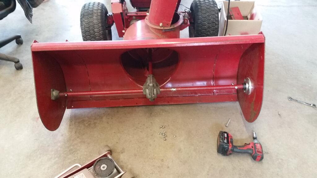

Wayne0 1,570 #3 Posted January 26 Actually, the Toro are bushings, not ball bearings. Anyone convert? Share this post Link to post Share on other sites

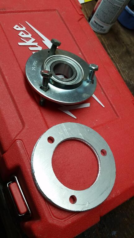

WHX?? 57,273 #4 Posted January 26 (edited) Yep ... a few threads here on doing it. Actually not that difficult. The spacer plates I made from 1/4" aluminum flat stock. The bearings are just 3/4 bore lock collar flange bearings. Only regret was i wished I woulda used relube bearings but that's all TSC had on the rack and I was in giterdone mode. Edited January 27 by WHX?? 2 Share this post Link to post Share on other sites
Wayne0 1,570 #5 Posted January 26 21 minutes ago, WHX?? said: Yep ... a few threads here on doing it. Actually not that difficult. The spacer plates I made from 1/4" aluminum flst stock. The bearings are just 3/4 bore lock collar flange bearings. Only regret was i wished I woulda used relube bearings but that's all TSC had on the rack and I was in giterdone mode. That was my thought. 1 Share this post Link to post Share on other sites

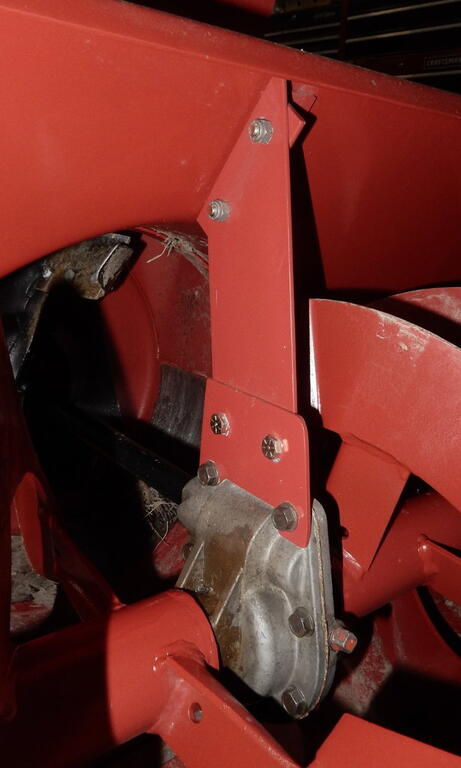

WHX?? 57,273 #6 Posted January 27 While your at it consider the center support. really helps with vibration and gotta reduce wear & tear on the gearbox. Share this post Link to post Share on other sites

Wayne0 1,570 #8 Posted January 27 (edited) 5 hours ago, WHX?? said: While your at it consider the center support. really helps with vibration and gotta reduce wear & tear on the gearbox. Another great idea! I've got some 1/8" x 3" aluminum that would work. Edited January 27 by Wayne0 1 Share this post Link to post Share on other sites
