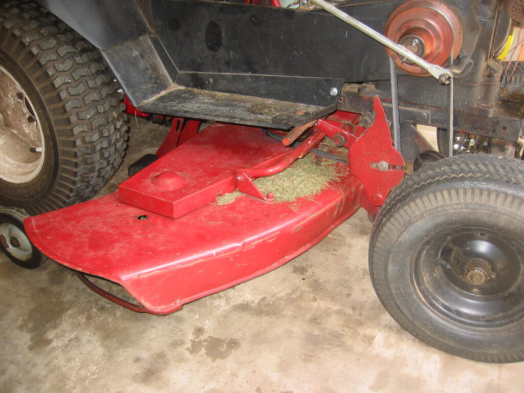

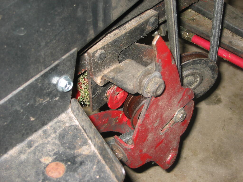

8ntruck 9,214 #2 Posted January 25 Check the attachment interchange chart post - the first sticky post in the impleme is section of the forum. In general, if you are using a mid Tach Matic and a mule drive on your tractor decks from around 1970 and newer will fit. 42" decks come in side discharge and rear discharge. I have one of each. I think that the rear discharge gives a bit better cut, but when cutting heavy grass tends to leave a slight windrow. The side discharge does not leave windows - but tends to throw sticks and rocks farther. 2 1 Share this post Link to post Share on other sites

pfrederi 21,043 #7 Posted January 25 Depends on the age of your tractor. Early Chargers did not have a mule drive they used an arch bar side mount system... (Not one of WH best designs). post a picture of yo tractor so we can give better guidance. 1 Share this post Link to post Share on other sites
