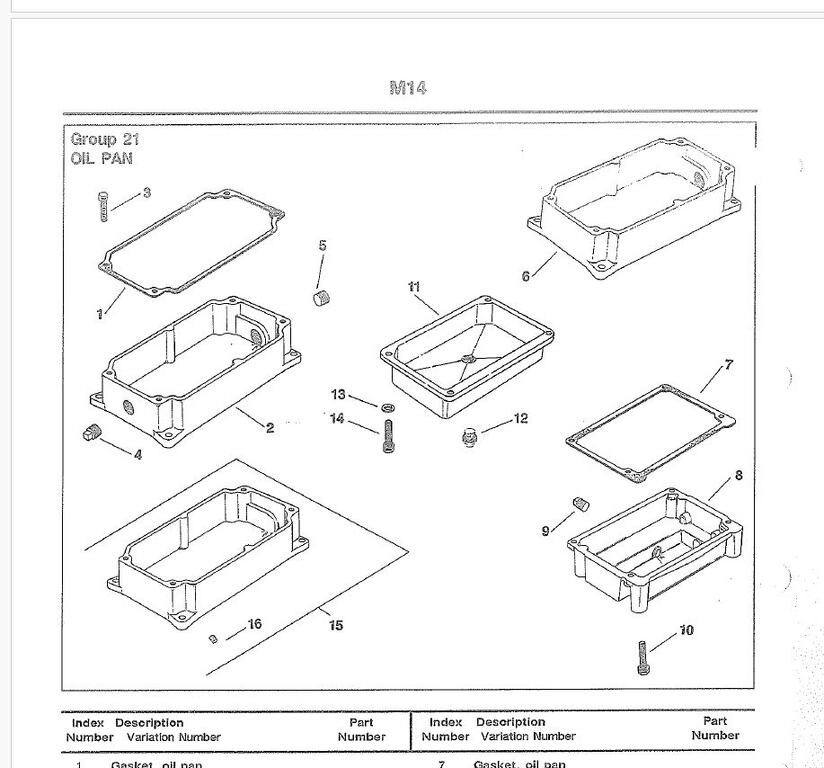

pfrederi 21,342 #2 Posted January 24 Magnums could have a variety of oil pans each would require a different amount of oil. I doubt AI knows which pan you have. Use the dipstick. 1 5 1 Share this post Link to post Share on other sites

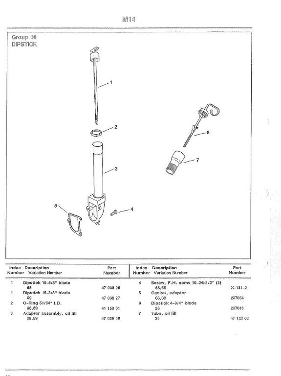

pfrederi 21,342 #7 Posted January 24 All the M14 with the long tube use the same tube and as it is screwed into the block not seated correctly is AI BS There is a difference in dip sticks. What is the spec number of your engine? Then we can make sure you have the correct dip stick (there is a 1/4" difference) 2 1 Share this post Link to post Share on other sites
