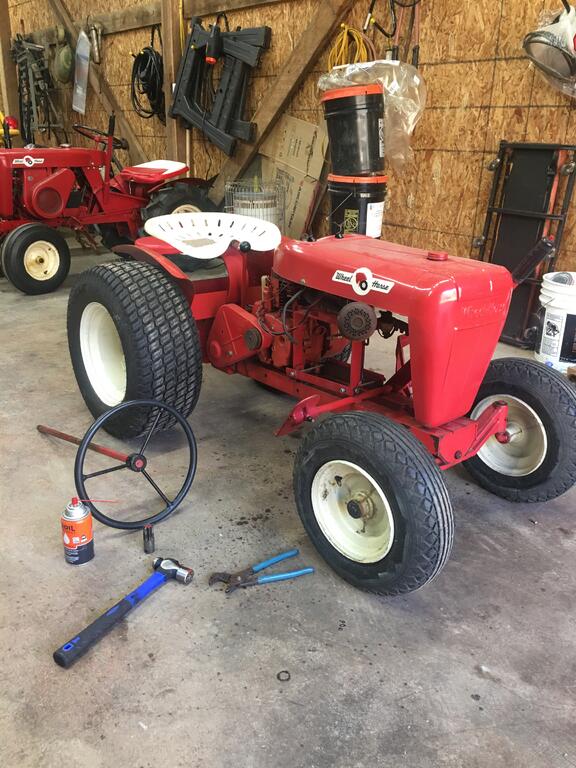

sqrlgtr 2,208 #1 Posted January 22 Not to be out done by the WI dudes ( @Achto, @WHX??), I've decided to start a restore on the 551 I brought back from the Big Show. Big thanks to @Pullstart and his crew for working with me and bringing to show for pick up. This will be my first Tecky motor restore and already miss my Kohlers . Just kidding motor seems solid without any unusual ticks, knocks, or smoke. Ordered a carb kit and will start there if and when I get steering wheel off. The throttle cable needs some attention fo sure cant hardly move it. Have had it running and drove it around and trans seems to be good. Haven't put a battery to it yet just used rope to start but wanting to have it both ways. I have a lauson 5.5 from the 550 I have and looks like a lot of stuff is the same ??? and it ran when took off years ago. May need some help on the electric when I get to it. One thing I can think of right now is what is the little box with the diode/fuses do thats on side of motor? just have one pic of it before I pulled it in shop but will post others asap . 6 6 Share this post Link to post Share on other sites
Achto 31,113 #2 Posted January 22 (edited) 28 minutes ago, sqrlgtr said: little box with the diode/fuses do thats on side of motor? This is your voltage regulator / rectifier. Will be following along. Edited January 22 by Achto 1 2 Share this post Link to post Share on other sites

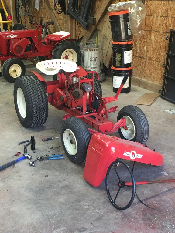

sqrlgtr 2,208 #6 Posted January 22 First major hurdle is over. 4 4 Share this post Link to post Share on other sites

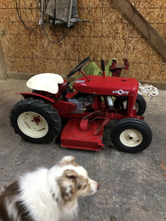

sqrlgtr 2,208 #13 Posted January 23 (edited) 46 minutes ago, Achto said: I little thing that I just noticed. Your '61 Suburban has a rib all the way down the top center of the hood Here is a pic of my 60 550 with that style hood???? Might be a 60 hood also same foot boards. Edited January 23 by sqrlgtr 3 1 Share this post Link to post Share on other sites
sqrlgtr 2,208 #14 Posted January 23 (edited) @Achto My 60 has 3 piece trans and the 61 has 2 piece. I thought the 2 piece came on the 61's but may be wrong. Noticed yours is 3 piece also??? Edited January 23 by sqrlgtr 1 Share this post Link to post Share on other sites
