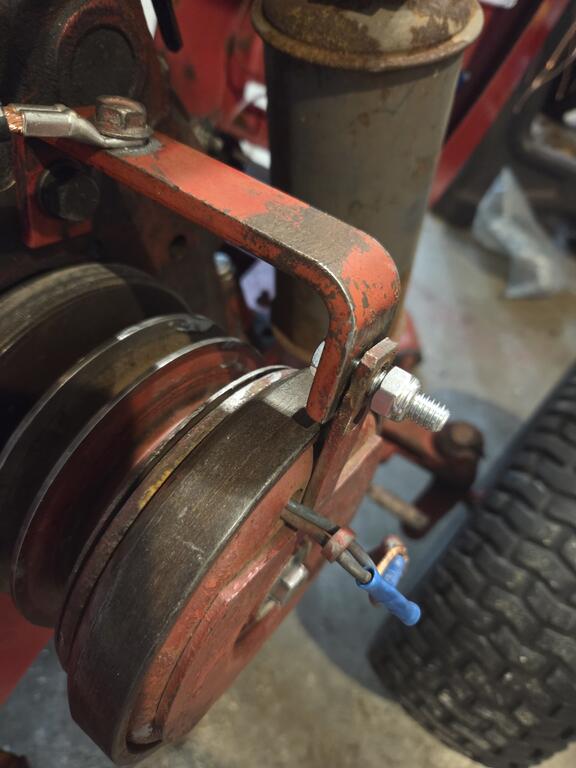

markseven 93 #1 Posted January 21 (edited) Not sure but im getting frustrated trying To figure it out. Cleaned points and .020 set at. Have a good 12 volt to coil All new wires . New coil . Kohler k301 12 hp Will not start Everything is basically new other Than the sparkplug and sparkplug wire. Edited January 21 by markseven Yyy Share this post Link to post Share on other sites

markseven 93 #3 Posted January 21 I found the problem. Had this bolt to tight. It should actually be a Pin and cotter key. It was putting to much pressure on the crankshaft towards the flywheel side And actually turning engine over hard. Causing a voltage drop enough to Cause the intermittent spark. 4 Share this post Link to post Share on other sites
Ed Kennell 47,946 #4 Posted January 21 (edited) Is this engine not equipped with an axial thrust bearing to handle the thrust from a manual PTO. Seems the Manual would exert more thrust than tightening that bolt on the lectric PTO ? But, I guess we never start up with the manual PTO engaged. Might be interesting to bypass the PTO safety switch to see if one would start with it engaged. Still thinking about this. The engaged manual PTO exerts a true axial force at the center of the shaft which the thrust bearing can handle. Tightening the bolt shown exerts a bending force on the electric PTO bearings that may be causing enough friction in the PTO to make the engine difficult to start. Edited January 21 by Ed Kennell 3 3 Share this post Link to post Share on other sites
Retired Wrencher 7,043 #5 Posted January 21 8 hours ago, Ed Kennell said: Is this engine not equipped with an axial thrust bearing to handle the thrust from a manual PTO. Seems the Manual would exert more thrust than tightening that bolt on the lectric PTO ? But, I guess we never start up with the manual PTO engaged. Might be interesting to bypass the PTO safety switch to see if one would start with it engaged. Still thinking about this. The engaged manual PTO exerts a true axial force at the center of the shaft which the thrust bearing can handle. Tightening the bolt shown exerts a bending force on the electric PTO bearings that may be causing enough friction in the PTO to make the engine difficult to start. Good info there and Ed. 1 Share this post Link to post Share on other sites
markseven 93 #6 Posted January 21 Very possible bending force. Upwards ? / downwards? Crankshaft end play was adjusted To 20 thousands recently. Wouldn't think pushing directly In on Crankshaft would be enough to Make it turn over hard. And it was turning over Hard because I removed The flywheel screen and was turning it by hand and in certain spots It was difficult to turn. Share this post Link to post Share on other sites
