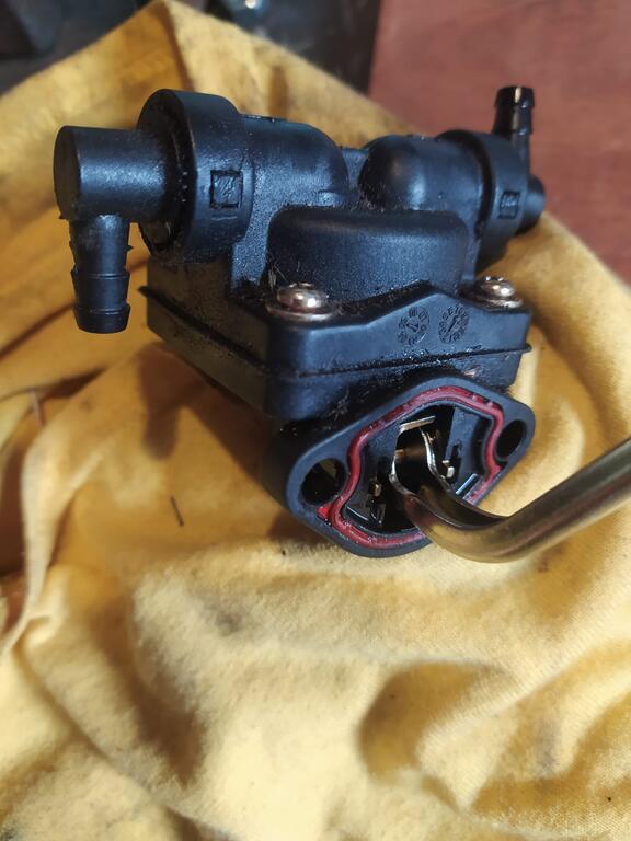

Stan50 195 #1 Posted January 20 I remove fuel pump in my 312-8 (plastic one) because I noticed small fuel leak, where fuel pump is connected to engine block. There was only one red thin gasket on the pump (looks decent), Maybe I need another gasket ? something like that? tractor runs good, start excellent (I added primer bulb), fuel pump # 4755904 for my engine but of course right now there is different # 4739367 Share this post Link to post Share on other sites
WHX?? 57,172 #2 Posted January 20 (edited) 8 minutes ago, Stan50 said: I noticed small fuel leak, where fuel pump is connected to engine block. If you have a fuel leak there the pump diaphragm is shot. Drain your engine oil and check for presence of gas. With a plastic pump your best off just replacing it. They are readily available and cheap but sometimes quality questionable. Plastic pumps are not worth rebuilding. There are many threads on them here. One of many offerings here. Edited January 20 by WHX?? 2 2 Share this post Link to post Share on other sites

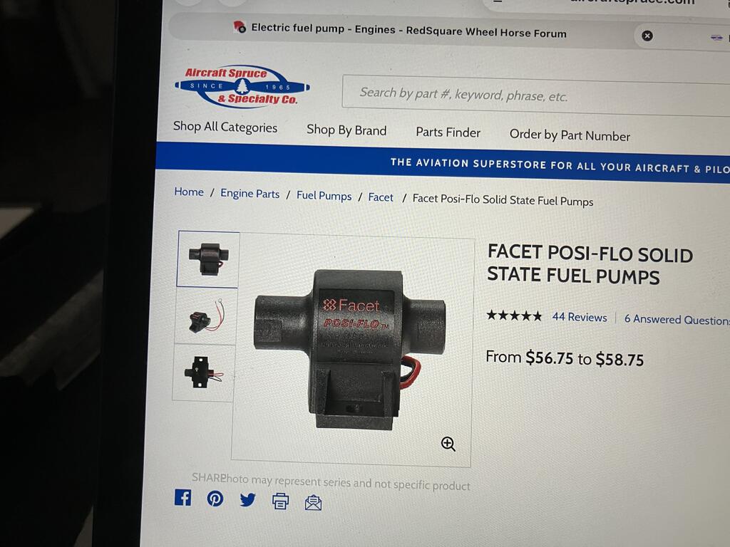

953 nut 67,013 #3 Posted January 20 This would be a good opportunity to go with an electric pump. 7 2 Share this post Link to post Share on other sites
sqrlgtr 3,091 #4 Posted January 20 17 minutes ago, WHX?? said: If you have a fuel leak there the pump diaphragm is shot. Drain your engine oil and check for presence of gas. Definitely check for fuel in gas. 6 minutes ago, 953 nut said: This would be a good opportunity to go with an electric pump. I always thought the tractors with the fuel tank under seat were great candidates for electric fuel pumps and would go that route before trying one of the cheap plastic pumps. IDK what the name brand mechainicals go for but remember thinking there was not much difference $$$ wise in converting to electric or maybe even cheaper. 2 Share this post Link to post Share on other sites
ri702bill 12,335 #5 Posted January 20 2 hours ago, sqrlgtr said: the name brand mechainicals Facet. Has to be the low pressure, 1 to 3 lbs. or so, version. 1 Share this post Link to post Share on other sites
Stan50 195 #6 Posted January 20 1 hour ago, WHX?? said: If you have a fuel leak there the pump diaphragm is shot. Drain your engine oil and check for presence of gas. With a plastic pump your best off just replacing it. They are readily available and cheap but sometimes quality questionable. Plastic pumps are not worth rebuilding. There are many threads on them here. One of many offerings here. Yes, small amount of fuel is sipping at the bottom of fuel pump. I bought the tractor recently and slowly going tru all important components. I'd like to be ready for mowing season :). I read some forum posts about electric fuel pump and it is probably way to go. I found that CarBolo is much appreciated here so I 'II go that direction. 1 hour ago, sqrlgtr said: Definitely check for fuel in gas. I recently changed oil, right after I put hands on the tractor, so oil looks like new. Old one was dirty and somewhat thin so maybe you're right. 1 Share this post Link to post Share on other sites
Stan50 195 #7 Posted January 20 1 minute ago, ri702bill said: Facet. Has to be the low pressure, 1 to 3 lbs. or so, version. yeah, I read many good reviews about Facet and CarBolo and I'll go with CarBolo (cheaper :)). Share this post Link to post Share on other sites
WHX?? 57,172 #8 Posted January 20 (edited) What tractor are you working on Stan? I like that pump. If you go electric you can take off the primer bulb. Check out the other ones on that site he posted guys. Most notably the shipping. Am I reading that right??? Edited January 20 by WHX?? 1 Share this post Link to post Share on other sites

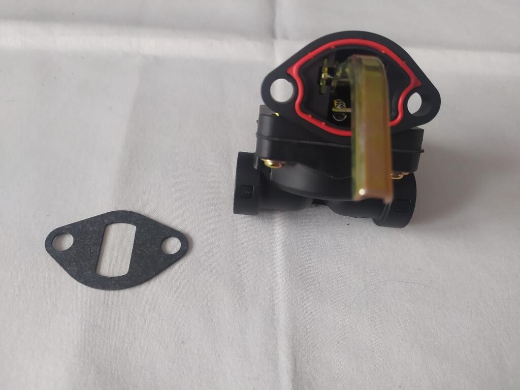

Stan50 195 #21 Posted February 9 (edited) On 1/20/2026 at 2:09 PM, Stan50 said: I remove fuel pump in my 312-8 (plastic one) because I noticed small fuel leak, where fuel pump is connected to engine block. There was only one red thin gasket on the pump Finally I received one of ordered fuel pumps, I ordered 2 more mechanical ones and one CarBole. I'm going to use mechanical ones first then when they will eventually fail I would use CarBole . Reasons: I like original system (however I don't have original fuel pump :/ ),CarBole will arrive in 1-2 months and I put marine fuel bulb already. Should I use that additional gasket or just fuel pump with red one? Edited February 9 by Stan50 1 Share this post Link to post Share on other sites
Stan50 195 #22 Posted February 9 Ok, I saw yt video, some guy filmed that process fairly straightforward, so no need for gray gasket - just red o-ring. In this case I keep that gasket for future use (i.e for block off plate which I fabricated recently, just in case of installing CarBole electric pump). 1 1 Share this post Link to post Share on other sites
WHX?? 57,172 #23 Posted February 9 On the only engine I have with the plastic pump I just used the red formed gasket with no issues. 1 Share this post Link to post Share on other sites
