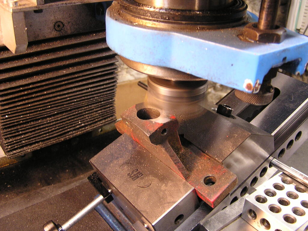

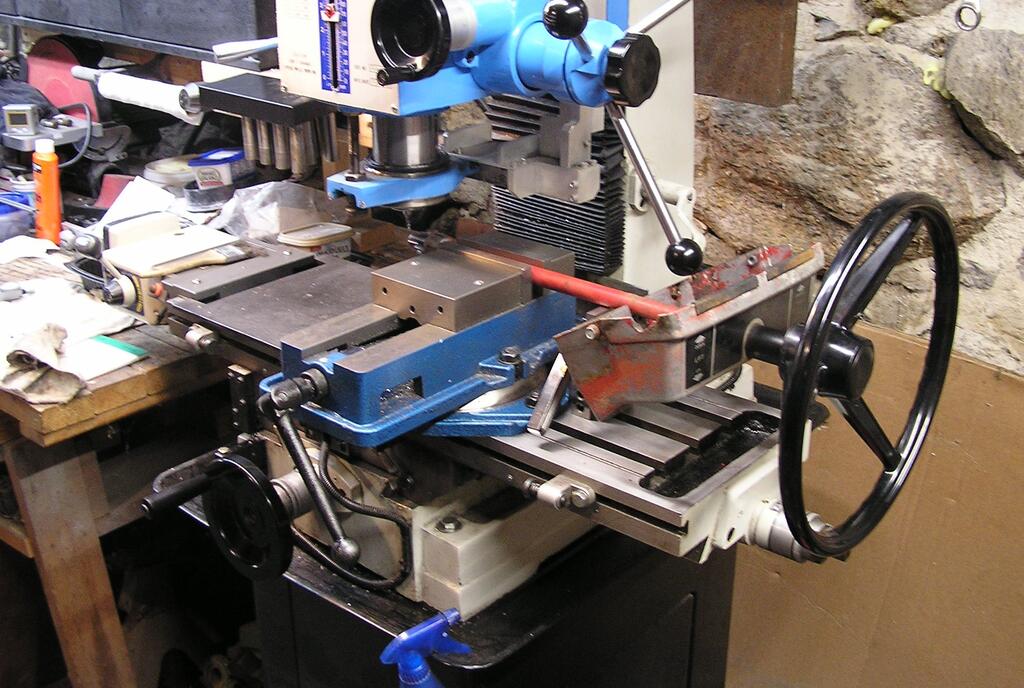

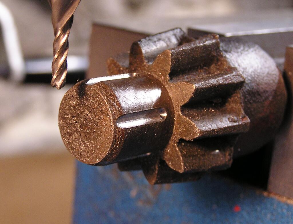

ri702bill
Adding Grease Grooves in Steering Shaft
Wayne0
The only problem I see is the grease has a way to go out, not stay in. I think a radial groove would be better. Maybe with a couple short cuts in the shaft that don't go to the end. My :twocents-02cents:
  • Like 2
ri702bill
The grease goes out the bottom anyway - there is a blow-out from the OE machining process. I figure the packed shallow grooves help to smear the grease.

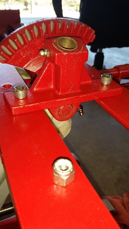

ri702bill
Joe - the fit between the shaft and the hole in the steering block is no longer loose. I resized the hole for a sleeve bearing.
1 hour ago, Retired Wrencher said:
I think we would like to know how this work out. Keep us in the loop.
I did the same on my 502 a while back. That tractor has over a dozen bushings added at common wear points. The steering is tight and can be done with almost no effort.
12 minutes ago, JoeM said:
Taken the joint is serviced timely
That is one of the quirks of a C series. The steering block grease fitting is all but hidden and mostly overlooked by someone in a hurry.

WHX??
Not too far :offtopic:but I add a zerk to the bottom bearing hole. Really not needed must be the Greasy Pete in me. Out of the 50 tractors @ebinmaine has I've never seen one wallowed out. :lol:
Not sure if adding it is worth weakening that area.

Lower bearing grease fitting - I do the same, but install that 45 degree fitting on the other side... easier access as I recall.... :scratchead:
  • Like 2
