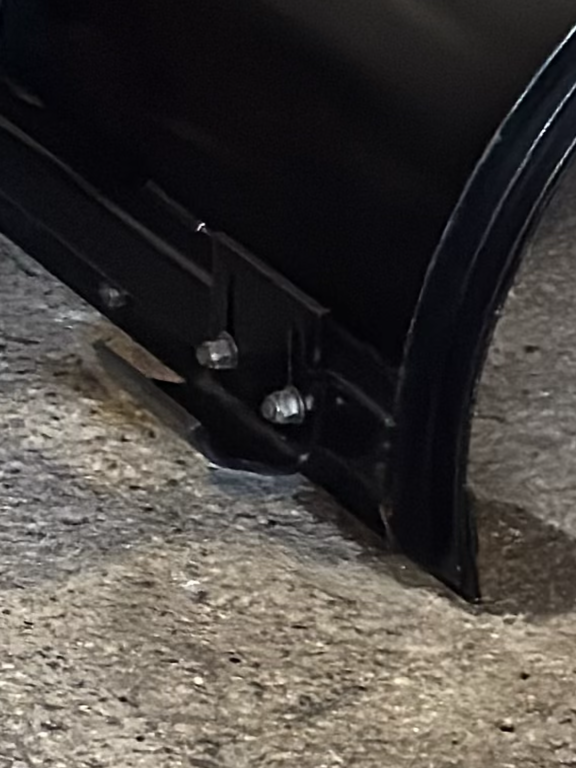

dandan111 66 #1 Posted January 18 It looks like the shoes for the snow blades are no longer available? Just wondering. I bought a cutting edge a few years ago. Share this post Link to post Share on other sites
ebinmaine 80,709 #2 Posted January 18 I've tried them and wasn't impressed for our driveway. They dug right in. Seems a common theme with softer aggregates. I have two sets of aftermarket shoes I'd sell. Different types. 1 Share this post Link to post Share on other sites
dandan111 66 #3 Posted January 18 I’m using mine on gravel. I’m using my dial adjust to keep blade off of ground about 1/2 inch or so. So far I like it. Shoes are just basically in case it touches. I always plowed concrete so this is new to me. First time I ever ran the shoes. My cutting edge should last a lot longer. Share this post Link to post Share on other sites

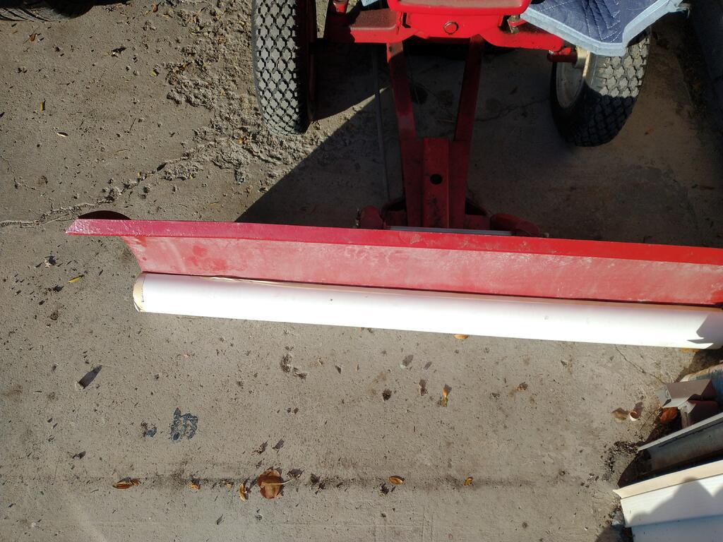

squonk 48,125 #8 Posted January 19 Gravel drive? PVC pipe. Protects the grass too! 3 Share this post Link to post Share on other sites

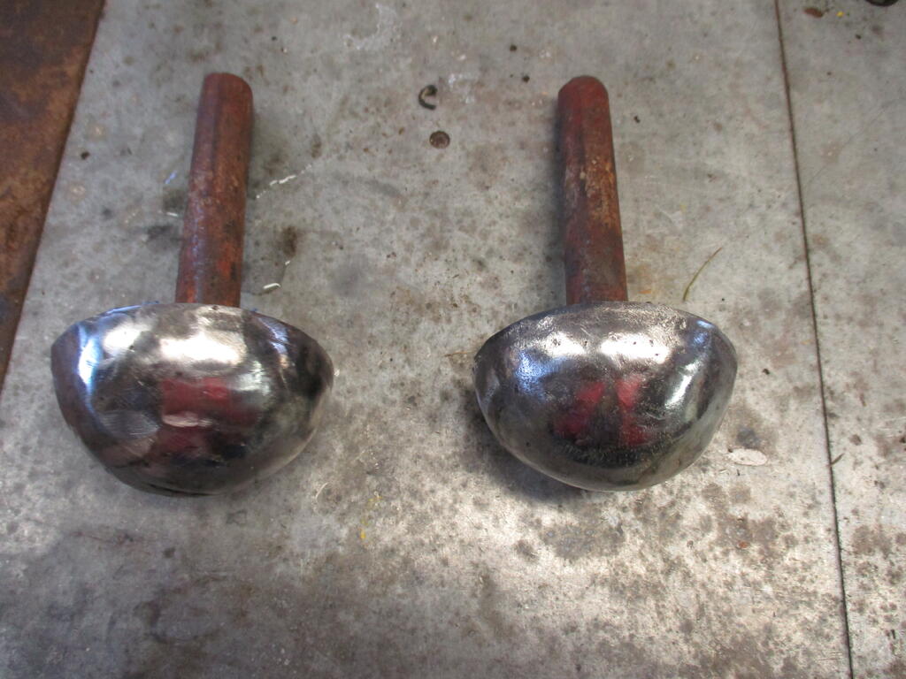

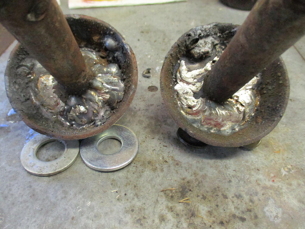

pfrederi 21,151 #9 Posted January 19 (edited) Over the years I have tried various plow skids. 95% of my plowing is on gravel, dirt, some sod. Homemade from pipe caps. Skid runner type and the vastly overpriced Toro skids. The first two wear out fast (especially now with the heavy 56 inch blade) The absolute best is the dome type modified with extra welding Edited January 19 by pfrederi 2 Share this post Link to post Share on other sites

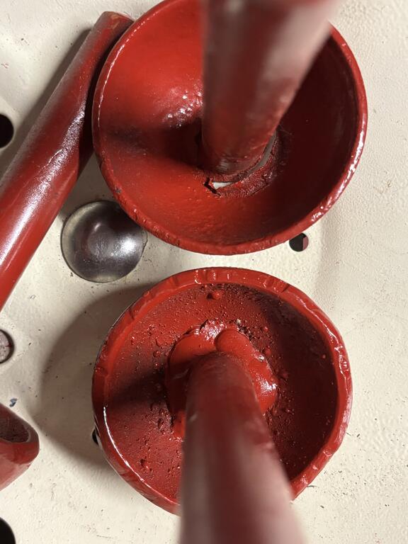

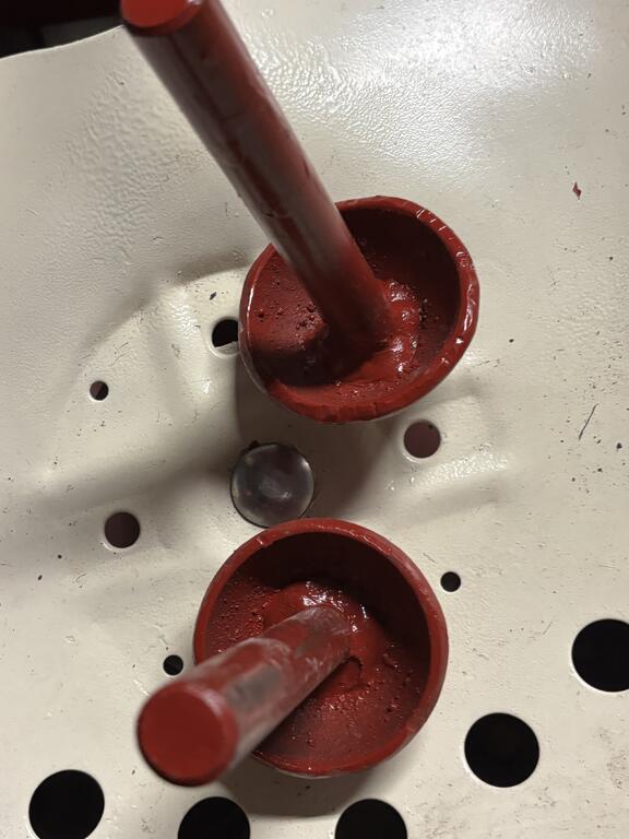

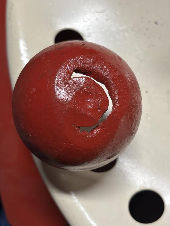

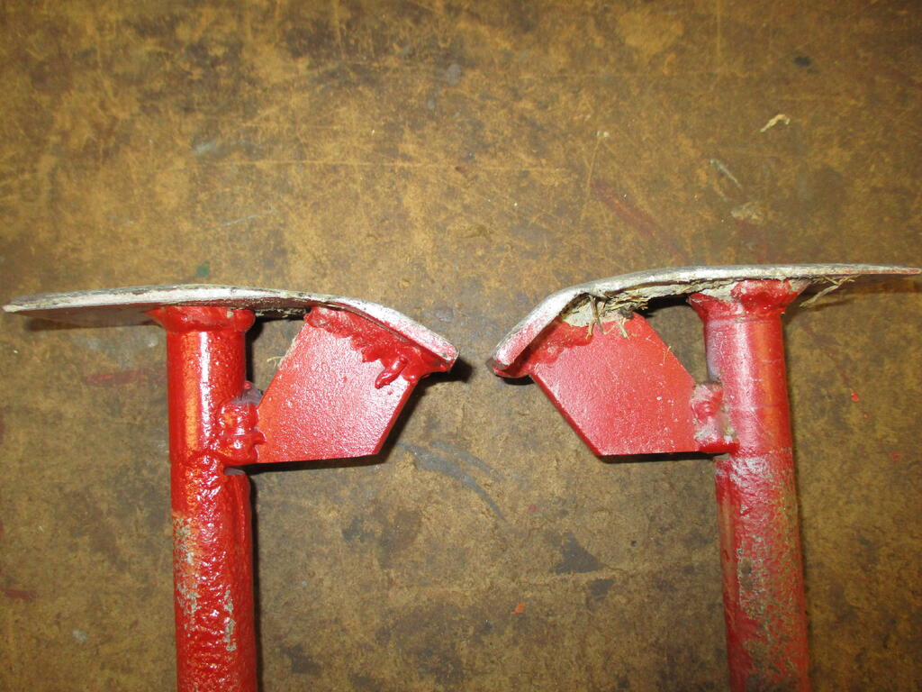

Lane Ranger 12,106 #11 Posted January 19 (edited) Ok i am going to give you guys a good suggestion about the snowplow skids for Wheel Horse early snowplows. i have used a plow with the bowl cup shoes for fifty years. These will wear on the bottom over time depending on your setting of the snowplow. My dad was a blacksmith and we remade ours. Last time we made a pair together with my brother it took about two and a half hours. 45 minutes to make them and the rest to figure the math for metal volume . We made the sidewalls of the skid bowl 1/4 thick as opposed to original 1/8 inch. You can see wear holes on the original 1/8 inch wall bowl below! Last year I had two sets made for $30 by a blacksmith shop. 1/4 thick again. But my next sets will have a solid bowl with a 3/4 hole for the six inch long 3/4 rod. So support your local blacksmith shop. They need the work and this helps them make something they never made before! The skill to do is valuable and you are preserving some originality! Here is a link to FIND YOUR LOCAL BLACKSMITH FROM THE ABANA -ARTIST BLACKSMITH'S ASSOCIATION OF NORTH AMERICA.: https://abana.org/community/directory/#!directory/map Edited January 21 by Lane Ranger 6 1 Share this post Link to post Share on other sites

Lane Ranger 12,106 #13 Posted January 20 3 hours ago, mrc said: gwest...not gold plated. at $152. for the set i would say SOLID gold. good grief! ten years ago when i checked Toro was charging $54 dollars for one of the original type snowplow skids! Share this post Link to post Share on other sites
