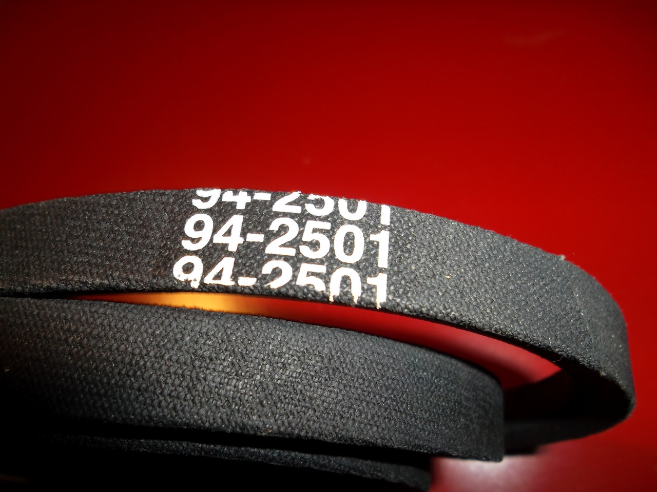

23 Reo 235 #1 Posted January 16 What is the Wheel Horse part number for the mower to deck drive belt on a 520H with a48" deck? Share this post Link to post Share on other sites
gwest_ca-(File Mod) 12,321 #2 Posted January 16 Click on the fuzzy picture 1 Share this post Link to post Share on other sites
Lee1977 7,685 #3 Posted January 17 Mule drive belt no.102742 super seeded to no. 94-2501 ( 1/2" x 103" ) 48" deck belt no. 1594 ( 1/2" x 107" ) 1 1 Share this post Link to post Share on other sites

23 Reo 235 #5 Posted January 17 Thank you, I ordered a Toro brand belt today. Only $29.00 delivered, Victory! 1 Share this post Link to post Share on other sites
