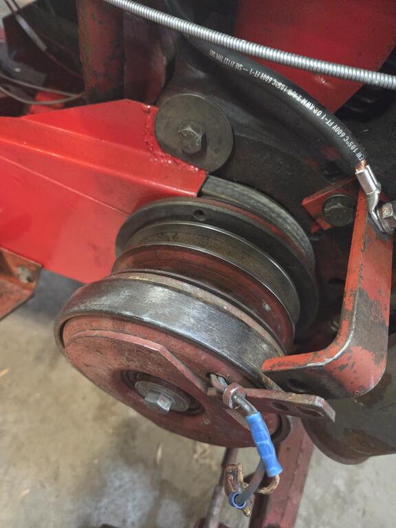

markseven 93 #1 Posted January 16 Is this right. Seems im missing something Between pulley and friction disk. Its all new to me. 1 Share this post Link to post Share on other sites
953 nut 70,652 #2 Posted January 16 looks OK to me. just need to bolt the bracket. 1 Share this post Link to post Share on other sites
markseven 93 #3 Posted January 16 Why is the diameter of the friction disk So much larger than the pulley.? Share this post Link to post Share on other sites
gwest_ca-(File Mod) 12,557 #4 Posted January 16 Looks like the friction disc for a manual pto which may have been original. The electric clutch disc is inside the outer assembly where the electric coil is. This may apply to the one you have. 1 2 Share this post Link to post Share on other sites
kpinnc 19,107 #5 Posted January 16 Yep- pull the manual clutch disc off. 1 2 Share this post Link to post Share on other sites
pfrederi 21,342 #6 Posted January 16 (edited) The older Electric PTOs like yours need bigger push off bolts. Probably 7/8"NC. Do not use a gear puller to remove the electric PTO you will damage it. When up get the old friction disc off and reinstall your Electric PTO the arm on the PTO will be inside of the engine bracket. Use clevis pin to secure it. Edited January 16 by pfrederi 4 Share this post Link to post Share on other sites
