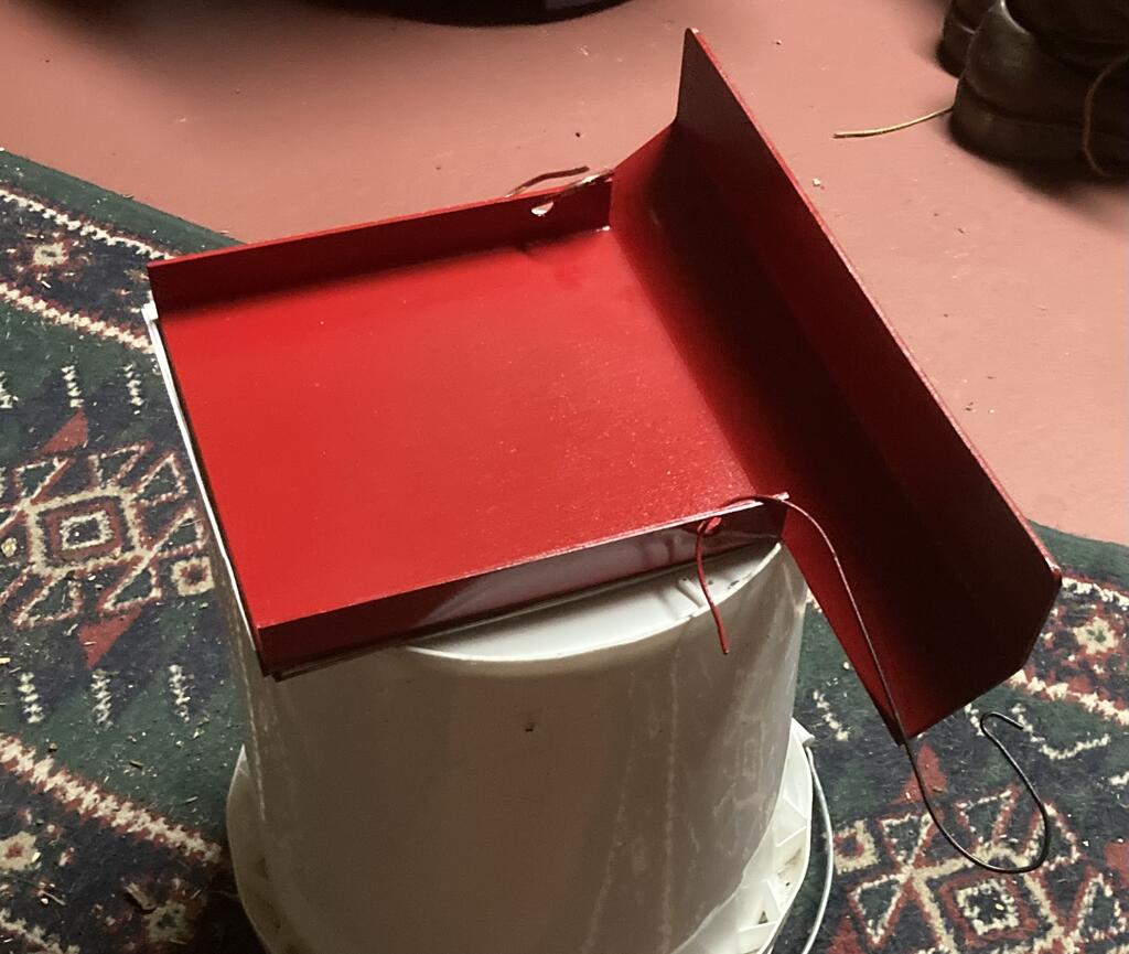

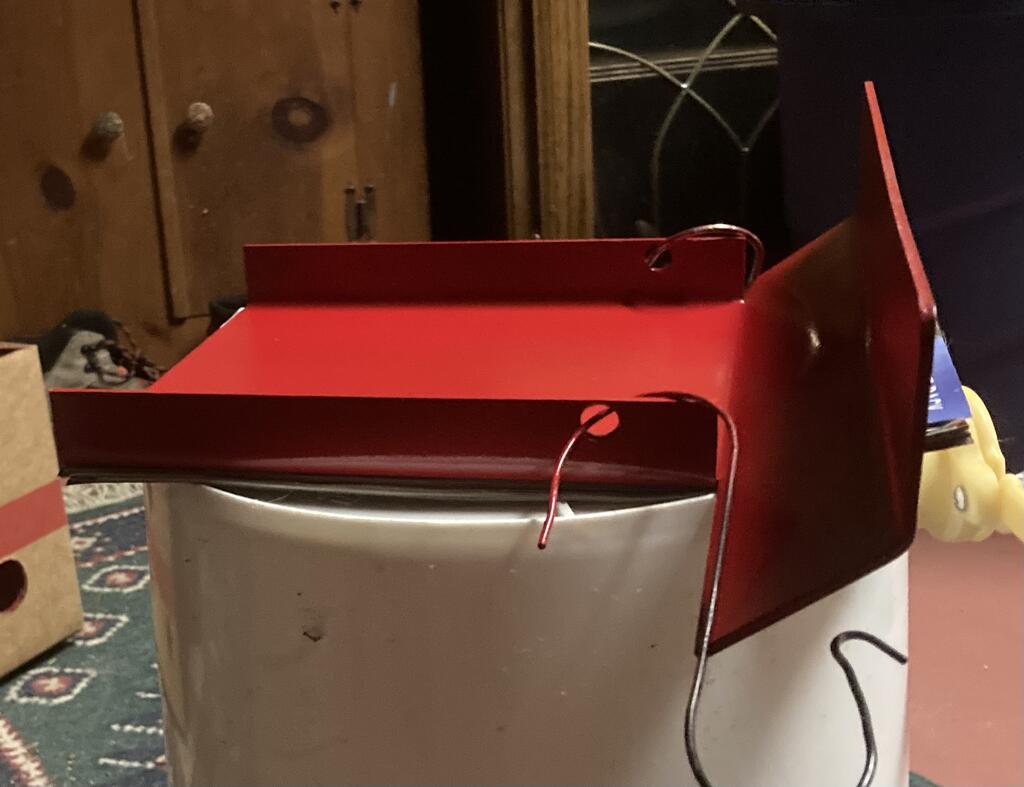

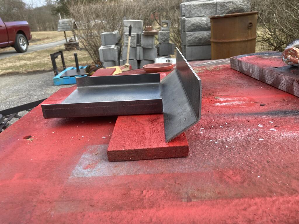

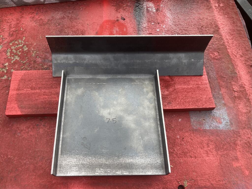

"Manic-Mechanic" 1,485 #1 Posted January 15 (edited) This is the axle assembly cover, fabricated from 13x12 .125 steel. Debating powder coat IH Red or paint Sunset Red-Rustoleum? Without press brake just not happening! Sunrise Red It is! Just ran out of paint! I did dry fit before final paint and it’s dead on! Edited January 20 by "Manic-Mechanic" Final Paint 5 Share this post Link to post Share on other sites
ebinmaine 78,715 #2 Posted January 15 6 minutes ago, "Manic-Mechanic" said: Debating powder coat IH Red or paint Sunset Red-Rustoleum? My understanding is that powder coating is very durable. What's the color of the surrounding pieces? 1 1 Share this post Link to post Share on other sites
ri702bill 12,075 #3 Posted January 15 52 minutes ago, ebinmaine said: My understanding is that powder coating is very durable. Same here. The key is cleanliness of the surface and giving it enough "tooth" for the powder to grip into. A random obit DA sander with a 180-grit disc roughs up the surface just enough to give good grip and the flow out hides the sanding marks. 2 1 Share this post Link to post Share on other sites
"Manic-Mechanic" 1,485 #4 Posted January 15 41 minutes ago, ri702bill said: Same here. The key is cleanliness of the surface and giving it enough "tooth" for the powder to grip into. A random obit DA sander with a 180-grit disc roughs up the surface just enough to give good grip and the flow out hides the sanding marks. That’s also the more costly route, which shouldn’t matter as there’s a fortune into this already! 2 1 Share this post Link to post Share on other sites
"Manic-Mechanic" 1,485 #5 Posted January 15 (edited) 1 hour ago, ebinmaine said: My understanding is that powder coating is very durable. What's the color of the surrounding pieces? RED-Sunset Edited January 15 by "Manic-Mechanic" 2 Share this post Link to post Share on other sites

kpinnc 18,124 #7 Posted January 16 I vote just paint. It's gonna get some scratches, and you can't touch up or repair powder coat. 1 Share this post Link to post Share on other sites
"Manic-Mechanic" 1,485 #8 Posted January 16 2 minutes ago, kpinnc said: I vote just paint. It's gonna get some scratches, and you can't touch up or repair powder coat. That's my thought, just have to mark and drill the mounting holes first, didn't trust the measure and drill method, not always true! Plus not like I'm going to go do fields all summer...sqrlgtr 2 Share this post Link to post Share on other sites
