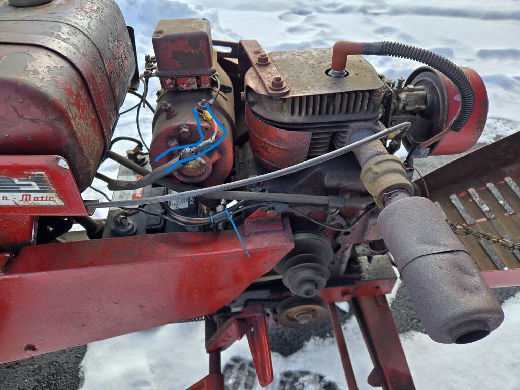

pfrederi 21,342 #52 Posted January 19 The wire from ignition switch to genny "A" terminal is too light gauge. Probably cause your smoking. Also your field wire is missing 2 Share this post Link to post Share on other sites

Clayton 54 #55 Posted January 21 What gauge wire is recommended?@pfrederi My apologies @Krice58. I did not intended or mean to hijack this thread. 1 Share this post Link to post Share on other sites

pfrederi 21,342 #57 Posted January 21 WH used 6ga wire. I sometimes use 4ga 1 Share this post Link to post Share on other sites
WHX?? 58,388 #58 Posted January 21 (edited) 9 minutes ago, pfrederi said: WH used 6ga wire. I sometimes use 4ga I sometimes cheat and use 8 ga. for the heavy starter circuit with no smoke let out. The missing field wire and everything else 14 Ga or 12 if I'm out of 14. Trolling motor wire works best. Can buy it by the foot at many places as well. Edited January 21 by WHX?? 1 Share this post Link to post Share on other sites
