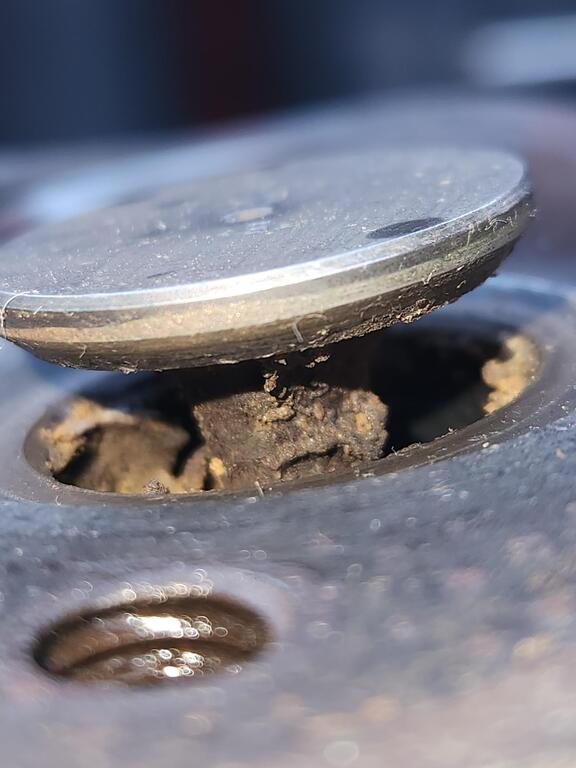

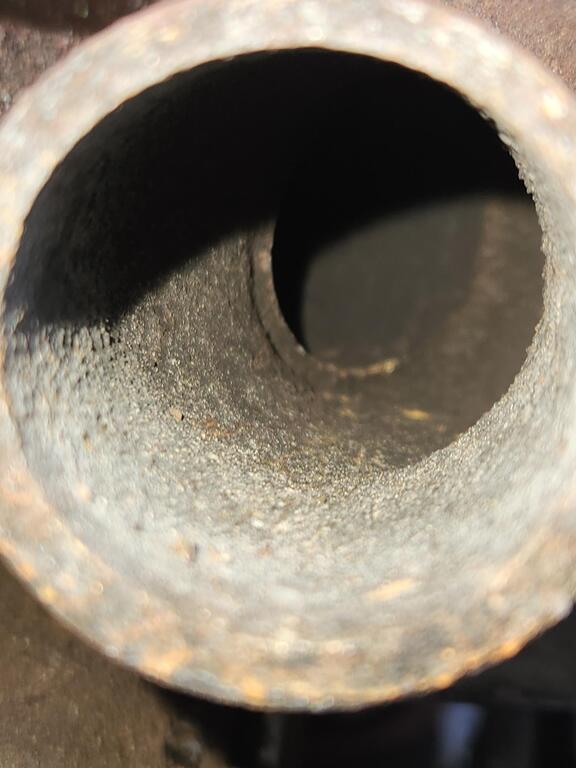

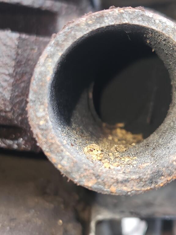

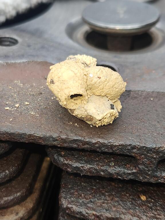

CD Long Jr 203 #1 Posted January 14 I was settin' in the shed havin' my 1st coffee & a cigarette. A reply in my original post about the exhaust valve kept eatin' at me. "Looks like a food fight goin' on in there". I got to thinkin', carbon is black, this crap is brown. I got a pick and poked around; it crumpled. I have never seen carbon crumble. I remembered the homemade muffler had some big holes in it so I removed it. Fired up the air compressor, put on a 12" blow nozzle, stood back & blew around the exhaust. Crap went everywhere, then a mud dubber nest came out. 2 1 2 Share this post Link to post Share on other sites
ri702bill 13,067 #2 Posted January 14 The "food fight" comment was mine. I'd say that if not cleaned, the exhaust would have been a mite restricted. Best to find that stuff now. And luckily none of the winged critters were home. 3 Share this post Link to post Share on other sites

WHX?? 58,128 #8 Posted January 15 (edited) Other day I was helpin @Achto with a K91 and there were dauber nests in the head & engine fins. I tried digging them out of the head with the jack knife and they were like concrete. Them devils can be worse than mice. I've got outlets in the overhead of the lean to on the warehouse for battery tenders and every one the ground hole was filled with a nest. Edited January 15 by WHX?? 3 1 Share this post Link to post Share on other sites
