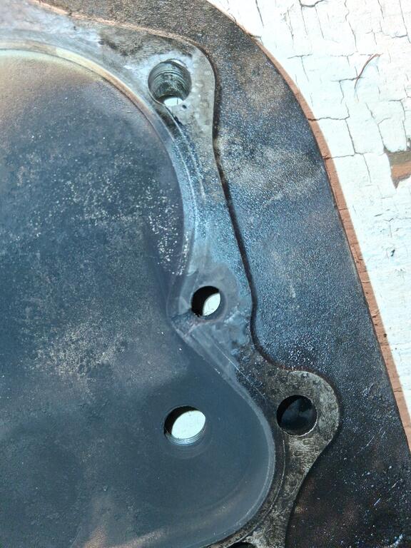

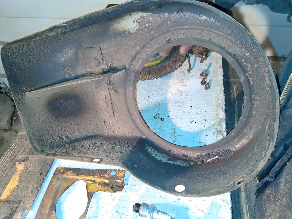

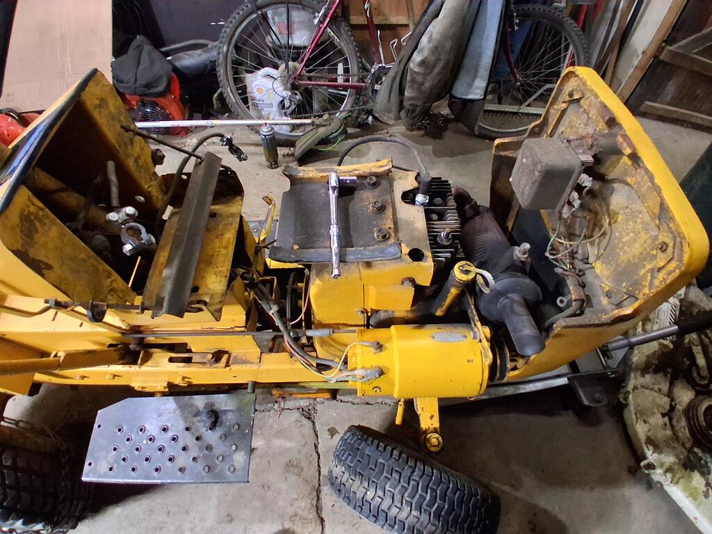

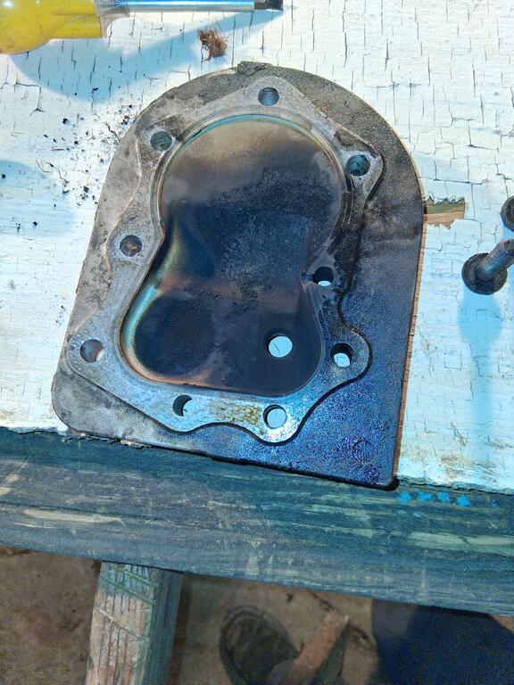

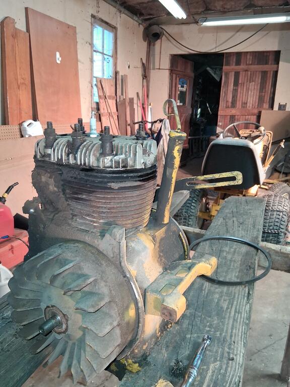

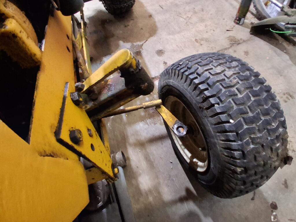

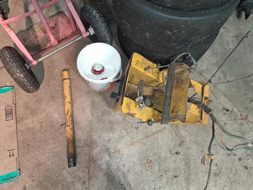

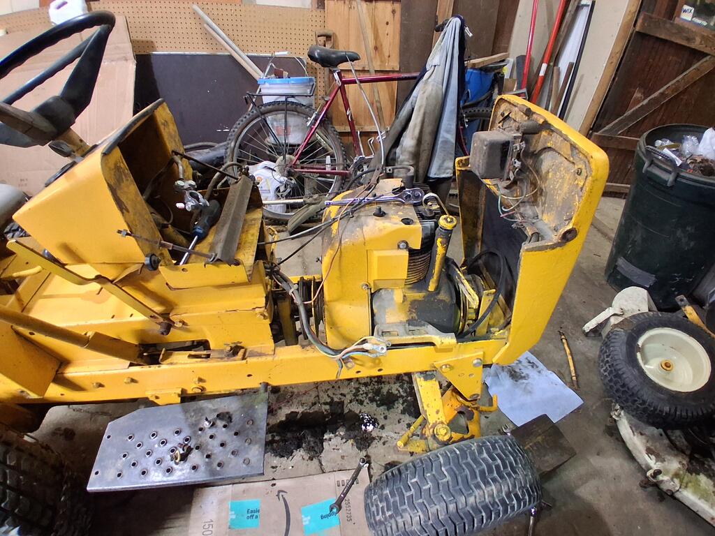

702854boy 408 #1 Posted 7 hours ago Yesterday we brought home my grandpa's 1967 Cub Cadet 122 so I could tear into and replace a headgasket, reseal the motor, fix the clutch, fix some fatigue welds, go through the mower deck, get it all degreased, flush and refill tranny, and probably some other stuff that I cant think if off the top of my head. Anyways, I have been taking photos as I go along. And when we were taking it off the trailer the left front spindle broke so I'm in need of one of those. 5 4 1 Share this post Link to post Share on other sites
ri702bill 10,972 #2 Posted 38 minutes ago That broken LF spindle looks awfully busy. It is the Master side, the RF is moved by it thru the tierod. Is the LF a 3-piece assembly - lower, shaft and upper or are the lower and shaft 2 parts welded into one?? Looks repairable if you cannot find a good used one. Share this post Link to post Share on other sites
