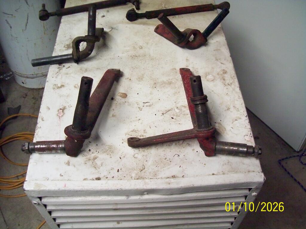

sgtwal 2 #1 Posted January 10 Switching out the front axel on my loader. Bought a heavy duty axel and a set of spindles to make the front end more heavy duty. Having some trouble getting the new spindles to match up to the steering setup on the tractor which is a D-200. Any suggestions? 2 Share this post Link to post Share on other sites
pfrederi 21,274 #2 Posted January 10 The spindles in the front do not look like D160-200 series spindles. I would hazard a guess they are for a D250 See parts pic for D250 Share this post Link to post Share on other sites
