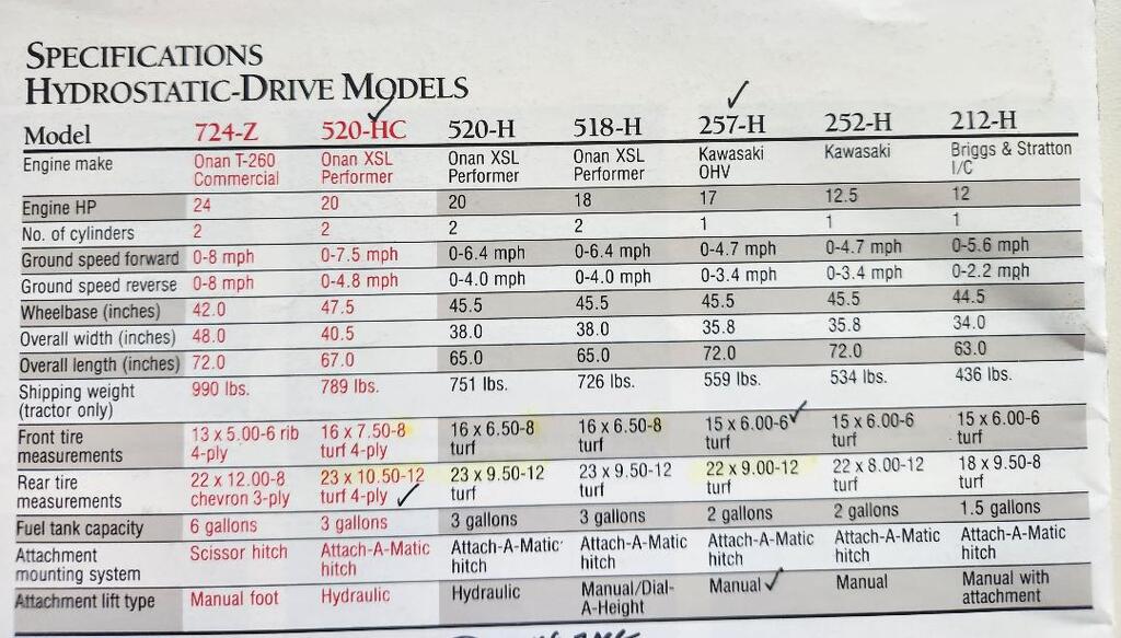

Brockport Bill 2,226 #14 Posted January 10 the 520 hc is either 88-89 model -- has various features different than the H -- we located 2 a few years ago - one we sold, the other went to my grandson after we did some cleanup, rehab, fresh paint some places, plus maintenance on it - carb, manifold gasket, fuel pump etc - he uses to mow and plow snow plus decided to drive to school one day - typical of onans they need some TLC but it is an impressivce machine. Tractordata.com or toro online has some info - i have also attached some photos of the WH brochure from 1989 that includes the HC model - eg: the HC was 1.1 mph faster top speed than the H -- enjoy, Bill 4 1 Share this post Link to post Share on other sites
