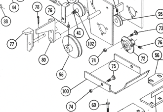

"Manic-Mechanic" 1,486 #1 Posted January 8 (edited) Diagram number 100, part 2660. Can I get someone to give me the dimensions for this guard? The .125 will due nicely, added for the bends and 1” shorter Edited January 11 by "Manic-Mechanic" Added .125 Share this post Link to post Share on other sites

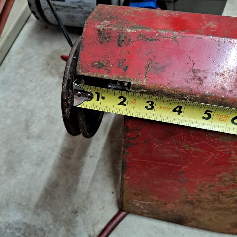

WHX?? 58,388 #2 Posted January 8 (edited) I can but its for a 7-1311 50 " bar. Prolly the same. edit: Yep same ...2660 part no. Have to wait till tomorrow in between putting a electric fuel pump on a 520. Edited January 8 by WHX?? 3 Share this post Link to post Share on other sites
"Manic-Mechanic" 1,486 #3 Posted January 8 6 minutes ago, WHX?? said: I can but its for a 7-1311 50 " bar. Prolly the same. edit: Yep same ...2660 part no. Have to wait till tomorrow in between putting an electric fuel pump on a 520. Man, that would be great! The axle box on mine is from a 7-1311 1 Share this post Link to post Share on other sites

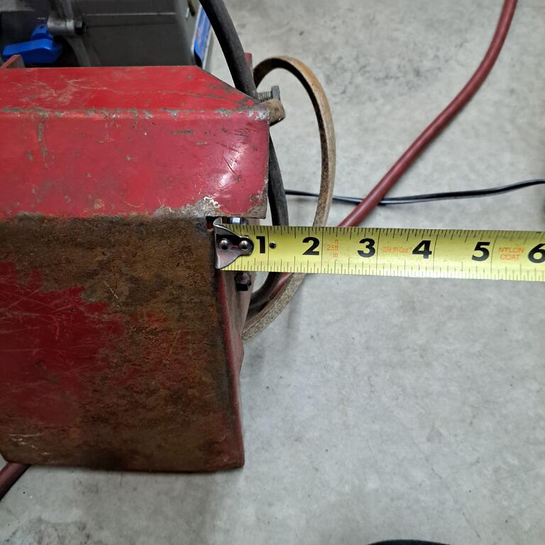

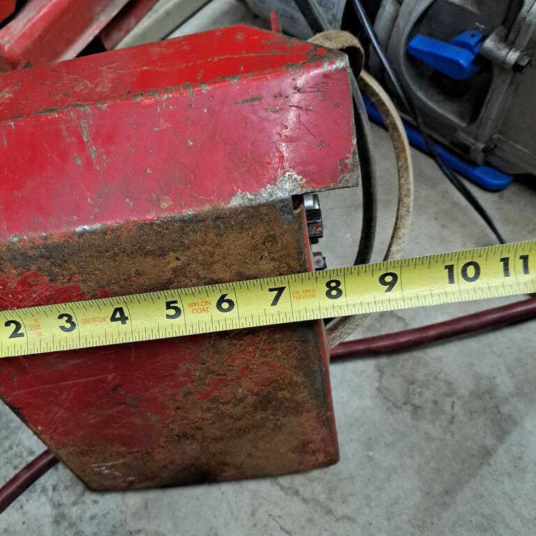

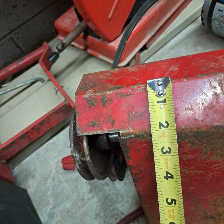

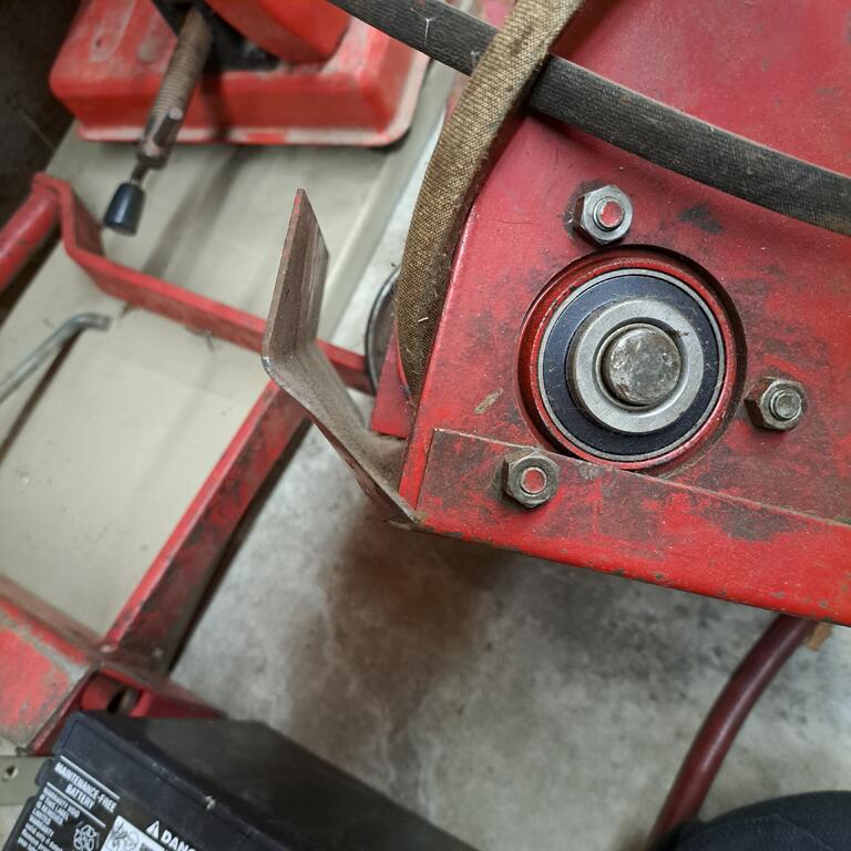

WHX?? 58,388 #4 Posted January 8 (edited) Ok took a break from the fuel pump install to let my hair grow back. Its held on by only the two carriage bolts on either side that hold the bearing plate on. Lemme know you need more. Edited January 8 by WHX?? 1 2 Share this post Link to post Share on other sites
WHX?? 58,388 #6 Posted January 8 I wouldn't think the dims are real important... builders choice. Except for the side to side where it bolts up. Fairly heavy gauge metal... about 14 ga. Not quite as heavy as the side plates 1 2 Share this post Link to post Share on other sites
"Manic-Mechanic" 1,486 #7 Posted January 8 2 hours ago, WHX?? said: I wouldn't think the dims are real important... builders choice. Except for the side to side where it bolts up. Fairly heavy gauge metal... about 14 ga. Not quite as heavy as the side plates I see, does look about 14 ga. This is great, I can definitely work with these! Thank you! 1 Share this post Link to post Share on other sites

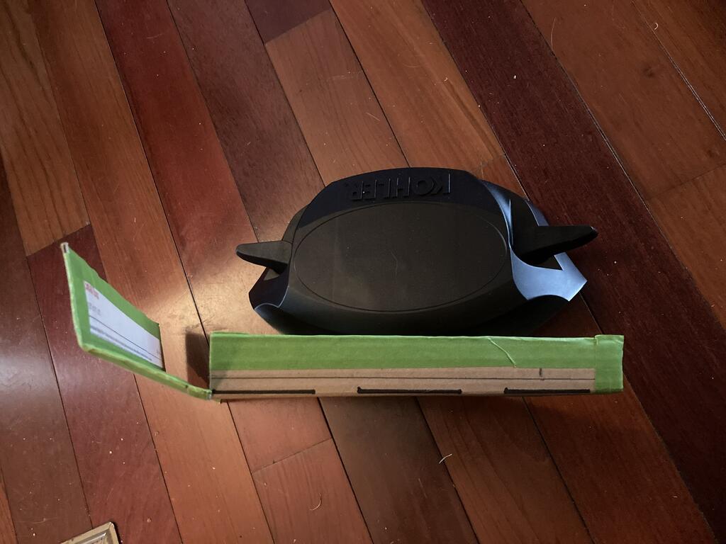

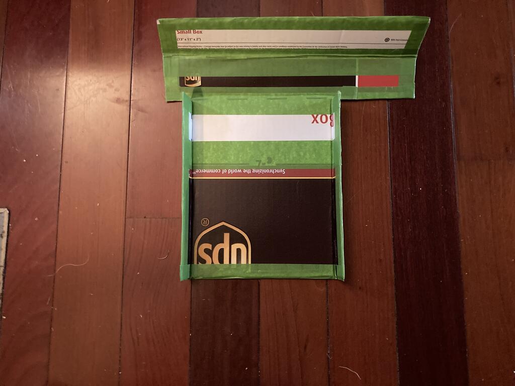

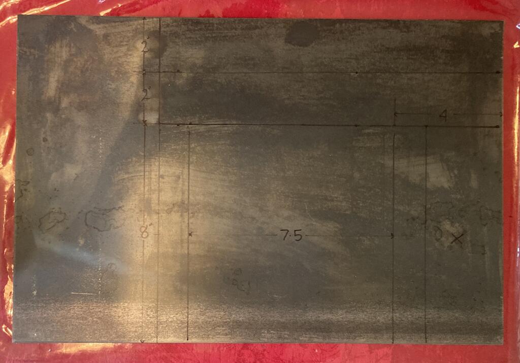

"Manic-Mechanic" 1,486 #9 Posted January 9 (edited) 18 hours ago, WHX?? said: Your What happened to the orginal? Rusted out or MIA? Pics when you get it done. MIA! Yes, will do! I may have to extend the width on the drive pulley side by 2” It’s relatively simple and fairly inexpensive material. Time to just grin and bear it! My hands aren’t what they used to be. Template: I did go with 4” under the drive pulley 1-1/8” on the 90° x 9-1/8” Edited January 9 by "Manic-Mechanic" Description: Template 3 Share this post Link to post Share on other sites
