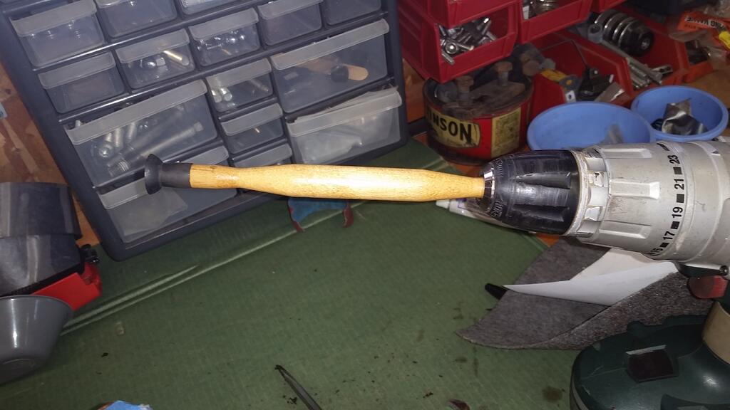

ri702bill 13,067 #7 Posted January 8 9 hours ago, WHX?? said: ll the valves and lap them. Wire brush things and clean up. I have the spring thingy like this ... Not ideal but a bit better than the two scre I use the same type of spring compressor - had mine about 55 years. Back from the backyard build short track racing days... While the valves are out, chuck the stem up in a cordless drill & spin the valve to see if it bent.... Only ran across one or two from small engines. Those got replaced. Then check the valve to guide clearances. This is best done with accurate measuring tools, but a good seat-of-the-pants method is to engage the valve stem into the guide so half the shiny part is in. Now shake the valve side to side noting the movement. Next lower the valve down to where it is only about 1/4" off the seat and shake it again. That test will show it to be a tad tighter, but if the first shake was really excessive, new valves and or guides might be in order. Lapping the valves is an excellent way to visually verify the valve contact to the seat is the correct width, position on the face, and even contact all the way around. Lapping compound grit residue must be completely removed from the valve & seat prior to assembly. Clean it once, then repeat! Share this post Link to post Share on other sites

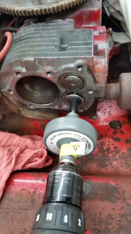

WHX?? 58,134 #8 Posted January 8 (edited) I also have one of these CD. Handy if you plan to open more motors up. https://www.amazon.com/dp/B08L4BKWJ6?ref_=ppx_hzod_title_dt_b_fed_asin_title_0_0 Beats the hand lapper in a drill. Another old Indian trick is glue some strips of fine sand paper to the valve. Got that one off you tube. Edited January 8 by WHX?? Share this post Link to post Share on other sites
