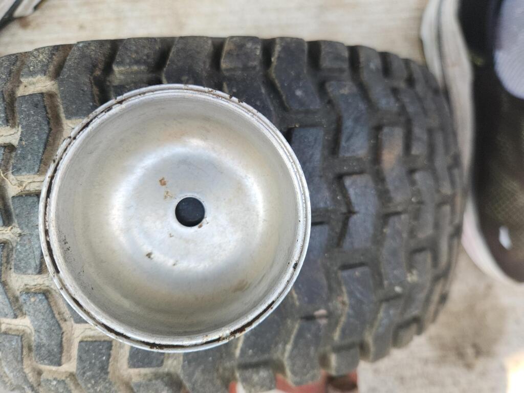

CD Long Jr 203 #1 Posted January 7 I removed the air filter assembly. Carb looks brand new. I removed the fuel bowl, clean as a whistle. Shouldn't there be a rubber washer / gasket on the screw the holds the bowl on? 1 Share this post Link to post Share on other sites
pfrederi 21,342 #2 Posted January 7 I have seen aluminum and hard fiber bowl bolt gaskets. 6 Share this post Link to post Share on other sites
sqrlgtr 4,225 #3 Posted January 7 2 hours ago, CD Long Jr said: I removed the air filter assembly. Carb looks brand new. I removed the fuel bowl, clean as a whistle. Shouldn't there be a rubber washer / gasket on the screw the holds the bowl on? I use the fiber washer but can get them at local hardware store. I have tried it with out the fiber washer and they will leak, just in case you're wondering. 3 1 Share this post Link to post Share on other sites
