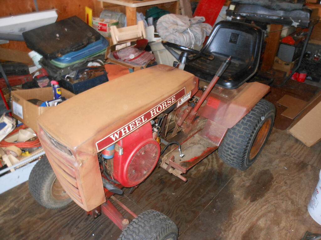

JCM 11,250 #2 Posted January 7 Some won't agree on my method and that's okay. This is what this C-120 looked like when It was dropped off to me many years ago. I used simple green to clean it then a scotch bright pad then simple green again then wiped all that off with a damp sponge. After it was dry I applied WD-40 on a cotton rag maybe a couple times a year. Repainted the rims. I still own it. Works for me without a repaint. 2 4 Share this post Link to post Share on other sites

FLtractor 185 #5 Posted January 7 3 hours ago, JCM said: Some won't agree on my method and that's okay. This is what this C-120 looked like when It was dropped off to me many years ago. I used simple green to clean it then a scotch bright pad then simple green again then wiped all that off with a damp sponge. After it was dry I applied WD-40 on a cotton rag maybe a couple times a year. Repainted the rims. I still own it. Works for me without a repaint. Beautiful change… what’s your method for simple green clean tractor? Spray on towel let sit for time then wipe off? Or mix with water and spray whole tractor? Share this post Link to post Share on other sites

JCM 11,250 #9 Posted January 7 Yes. Rags soaked with Penetrol if not properly dealt with could be an issue. This was done many years ago. I think I used the Simple Green not diluted. @FLtractor Share this post Link to post Share on other sites
