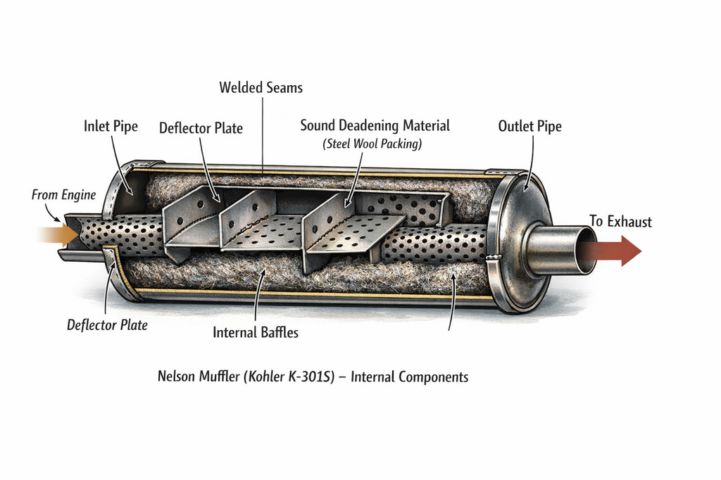

Bar Nuthin 3,644 #1 Posted January 6 (edited) I never thought much about it until I added a couple of tractors to my collection. My original C-120 still has the stock Nelson Muffler (on a K301) - but it's twice as loud as my other two tractors. C-141 K321 w/stock Nelson muffler '73 No Name K321 with aftermarket muffler (surprisingly, the quietest of all 3) I asked ChatGTP about it and it provided some solutions and a drawing. I really want to keep the Nelson muffler on my C-120. Curious if anyone has successfully operated on one with some success. Here's what AI suggests Repair options (from least invasive to most involved) 1. Internal baffle stabilization (best first step) If the muffler rattles when shaken, this is likely your fix. Method Drill a small access hole (⅜"–½") on the underside Use a stiff wire or rod to confirm loose internals Tack-weld or plug-weld the loose baffle through the hole Weld the access hole shut Result Often restores 70–90% of original quietness Keeps original Nelson muffler intact Invisible once done This is the most common successful repair. 2. Internal repack (moderate skill, very effective) Original Nelsons were not fiberglass-packed like modern mufflers, but adding discreet packing helps. Method Cut a small rectangular access window on the underside Add stainless steel wool or basalt exhaust packing Re-secure internal plates if possible Weld panel back in place and grind smooth Result Significantly deeper, softer exhaust note Slightly quieter than factory Still visually original ⚠️ Do not use household steel wool—it burns quickly. 3. Hidden secondary diffuser (period-safe trick) This avoids opening the muffler at all. Method Insert a short perforated tube or cone into the outlet Secure with a hidden tack weld inside the outlet Paint flat black Result Reduces sharp crack without choking the engine Often used by restorers who want no shell modification 4. Full internal rebuild (maximum effort) Only worth it if originality matters greatly. Method Split the muffler along a seam Recreate baffles from stainless sheet Weld back together and refinish Result As quiet as new Labor-intensive but museum-grade What not to do ❌ Don’t drill random holes (makes it louder) ❌ Don’t stuff fiberglass loosely (blows out fast) ❌ Don’t neck down the outlet (hurts K-301 breathing) ❌ Don’t assume “they were always loud” — they weren’t A healthy Nelson on a K-301 should be deep and mellow, not sharp. Edited January 6 by Bar Nuthin 2 Share this post Link to post Share on other sites

Kenneth R Cluley 713 #13 Posted January 7 Definitely don't care for the "steel wool" suggestion in the drawing. That won't last long. We used to use fiberglass, hence the term "Glasspack Muffler" That didn't last very long either. Maybe stainless or copper gauze? 1 Share this post Link to post Share on other sites

Bar Nuthin 3,644 #15 Posted January 7 1 hour ago, Kenneth R Cluley said: Definitely don't care for the "steel wool" suggestion in the drawing. That won't last long. We used to use fiberglass, hence the term "Glasspack Muffler" That didn't last very long either. Maybe stainless or copper gauze? In the text, it cautions against regular steel wool and suggests stainless steel wool or basalt exhaust packing. Not sure what basalt exhaust packing is. Looks similar to insulation. Basalt Silencer and Exhaust packing sound insulation from Merlin Motorsport 1 Share this post Link to post Share on other sites
