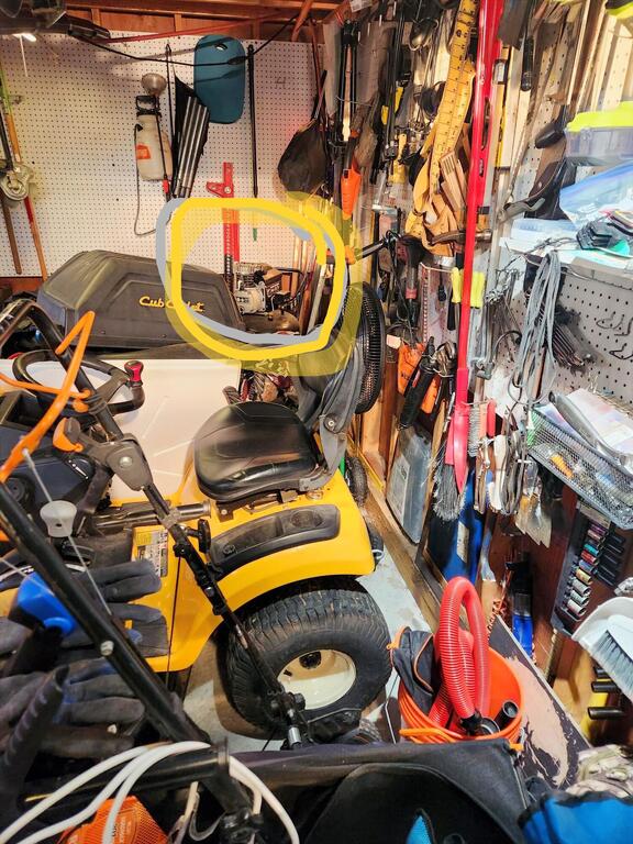

Worked on the mule drive tensioner again. Neighbor came over to check on me. The knob broke off and it's cross threaded, so my neighbor said. I'm gonna cut my losses with a grinder. :bitch:Still applyin' Liquid Wrench to the nut so I can get the belt out of the mule. Applyin' to everything I think I may need to loosen. Drive belt & clutch looks to be in good condition. My air compressor is suddenly poppin' the reset button. :rant2: Ya would know I got it in the corner of the shed blocked by my garden wagon, Cub Cadet XT1 & rear bagger & my snowblower & walk behind mower. :angry-screaming: Luckily, I have a portable compressor for operating air nailers, etc., in the house. I blew all the debris off the top and around the tranny & rear and start applyin' Liquid Wrench to the linkages. I found the bracket that goes across the top of the battery on top of the tranny? :confusion-shrug:
