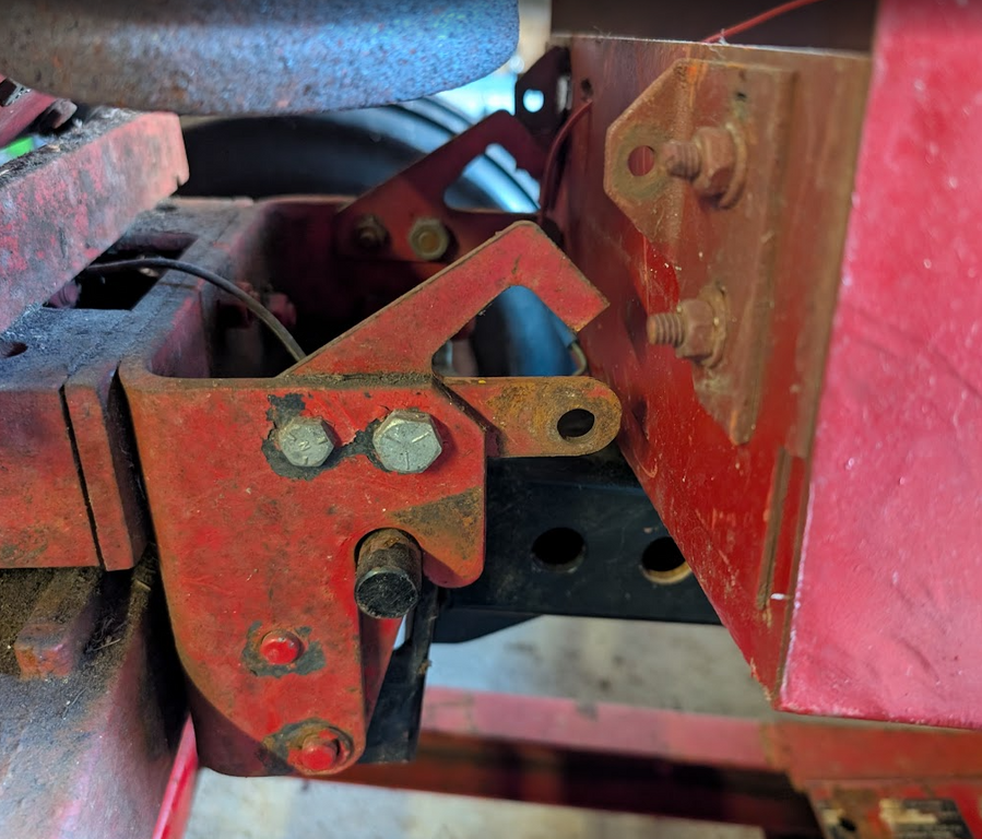

bassJAM 94 #1 Posted January 4 Had to jump my C125 the other day and to my surprise the hood fell off as soon as I unsnapped the rubber keepers. Is there supposed to be a pin or axle of sorts, and can anyone show me a picture of what I'm missing? I have to assume it broke or fell off while plowing snow back in December but I can't find anything at the edges of my driveway. 1 Share this post Link to post Share on other sites
gwest_ca-(File Mod) 12,488 #2 Posted January 4 Scroll to the bottom of the illustration https://www.partstree.com/models/01-12ke02-c-125-toro-garden-tractor-1981/sheet-metal-and-covers-11/ 2 Share this post Link to post Share on other sites
bassJAM 94 #3 Posted January 4 Thanks, looks like I'm going to have to make some bushings. Share this post Link to post Share on other sites

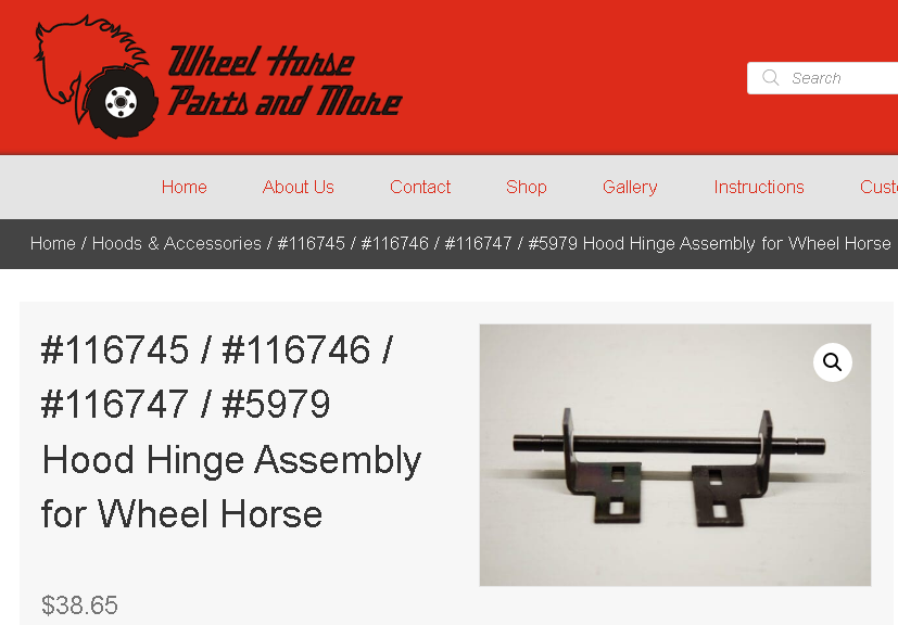

JoeM 10,267 #4 Posted January 4 I just use 3/8 x 1 1/4 bolts with nyloc nuts & washers on my workers. the new brackets shaft with bushing are available but cost 2 1 Share this post Link to post Share on other sites
gwest_ca-(File Mod) 12,488 #5 Posted January 4 Use bolts long enough to have some unthreaded shank where it passes through all the metal hinges. That way time will not be wearing on the threads of the bolt making the fix short lived. Add washers to expose just the threads for the nut and cut off extra threads. If you can find plastic or nylon washers even better. Snug the nut up so the pivot is under tension - rattles likely disappear. You may have room to put a washer between the hinge halves. 1 2 Share this post Link to post Share on other sites
